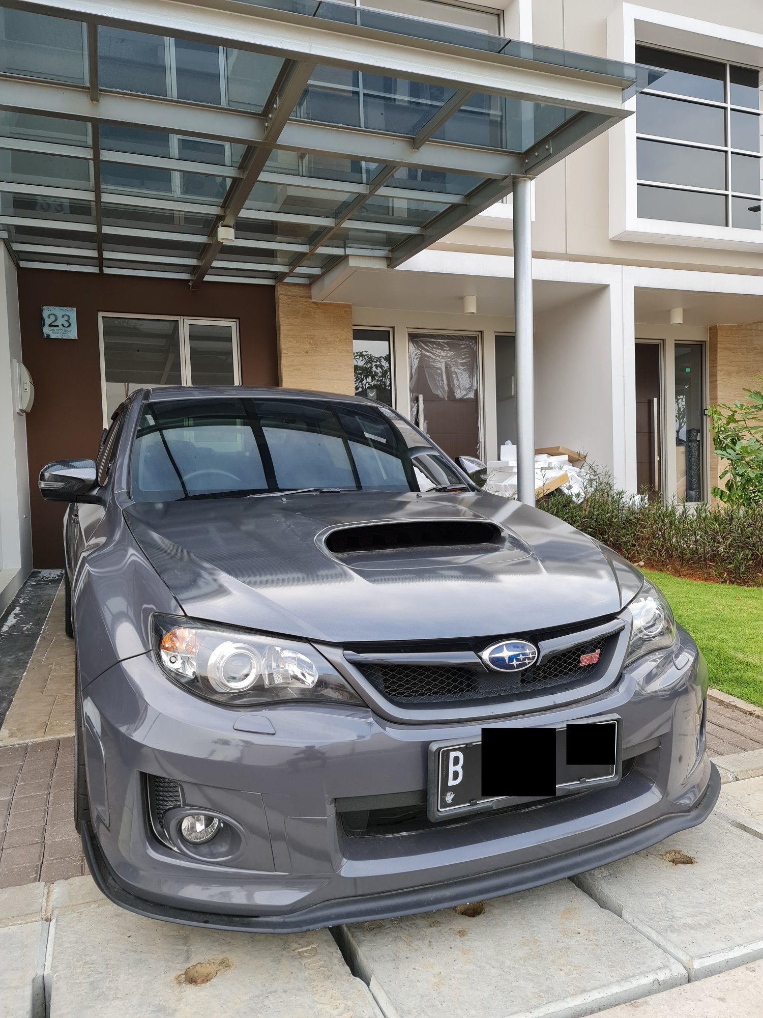

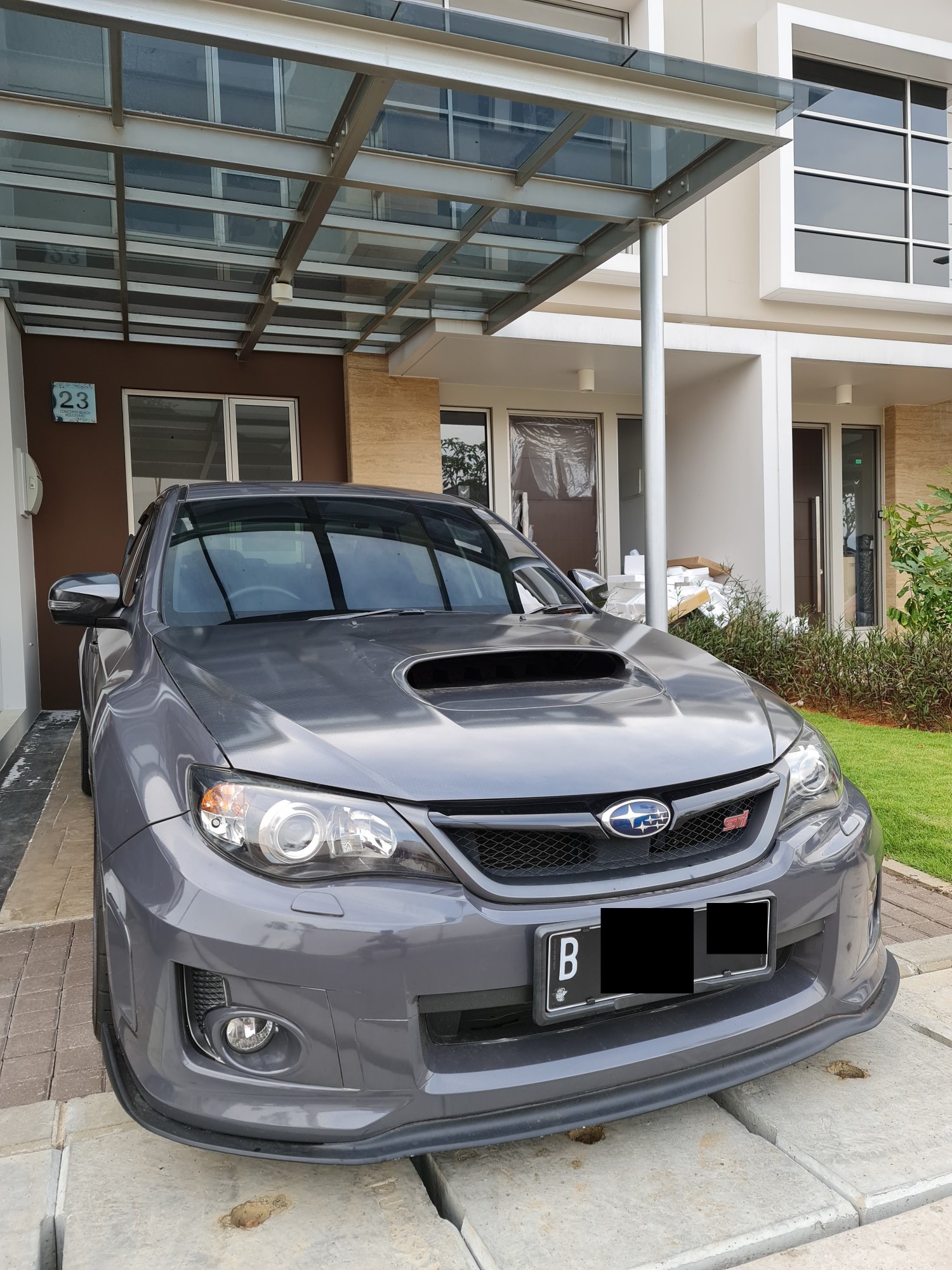

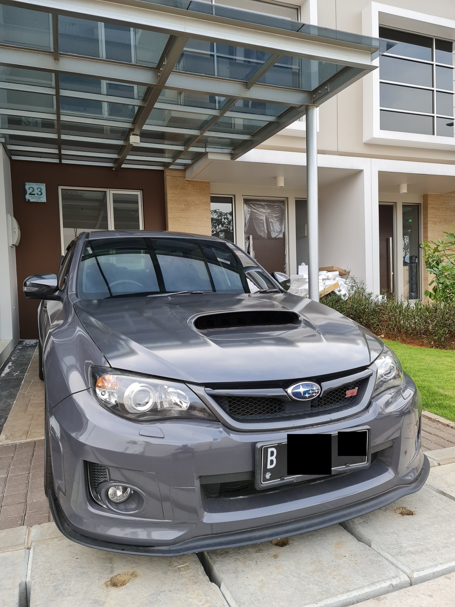

STI...my dream car xD
almost bought this 2nd hand 2012 STI but after checking the price of spareparts i gave up.
