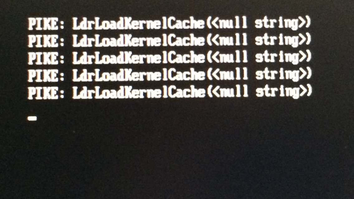

I guess that, in my desperation, I must have somehow tried safe-booting using nvram boot-args="-x" and failed, and that's when I took the picture. I've just run nvram -p and it doesn't display anything suspicious that I can see.
Ok so it is time to enable the debug output (see my previous reply).
And /Volumes/Install OS X El Capitan/.IABootFiles/boot.efi is bootbase.efi?

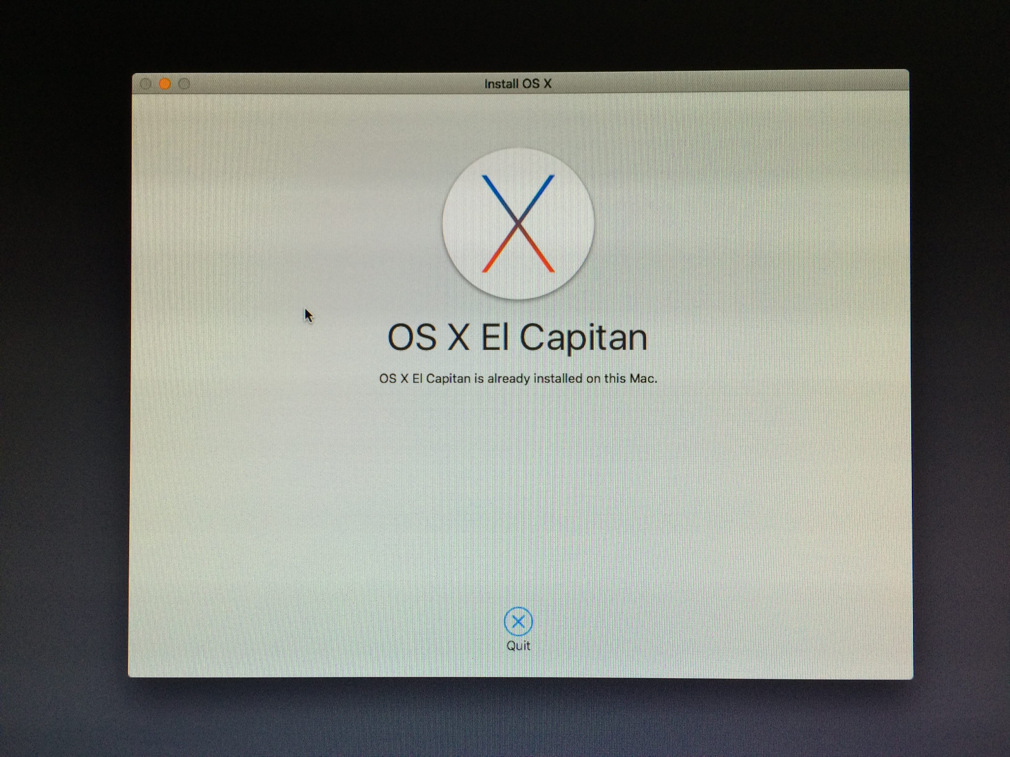

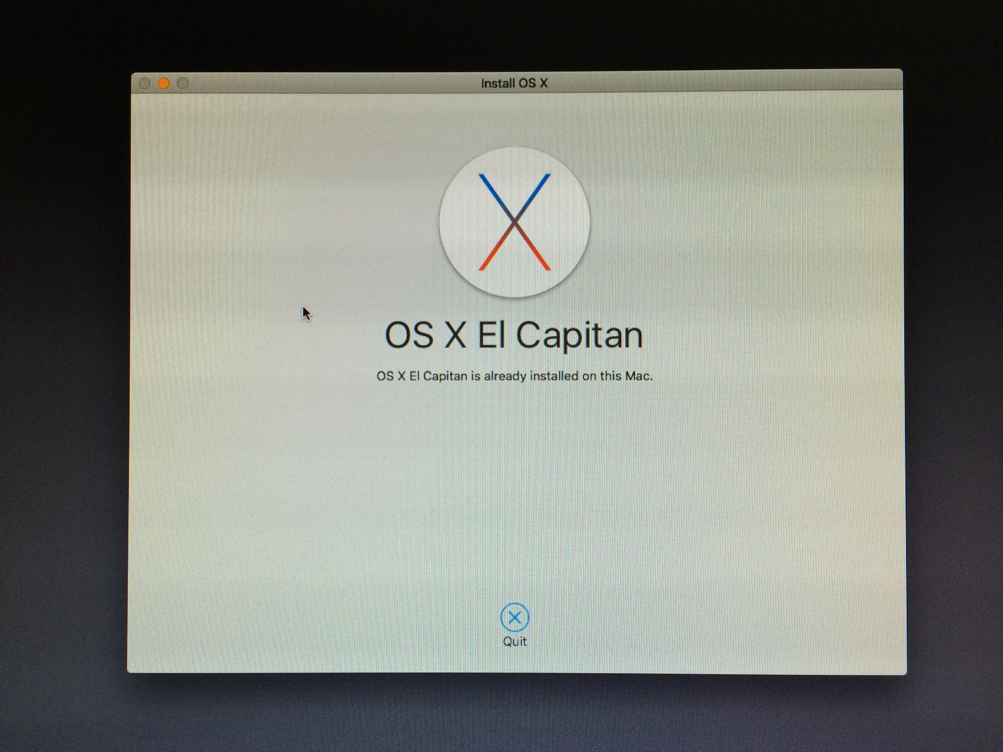

NO. I wasn't aware that I should place the bootbase.efi in there. I will try in a sec.
EDIT
:D YESSS! now the installer GUI came up!!!
I used the bootbase.efi from commit 9edc64d660598beff6ef735aeacce6fa37446ce7
(renamed as boot.efi, just as it was there after creating with createinstallemdia).

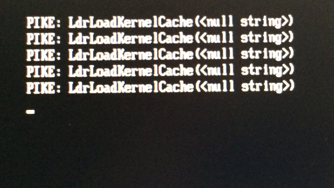

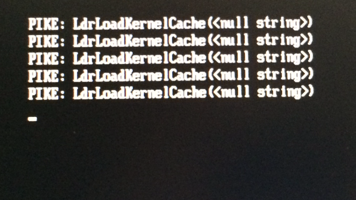

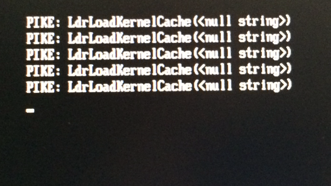

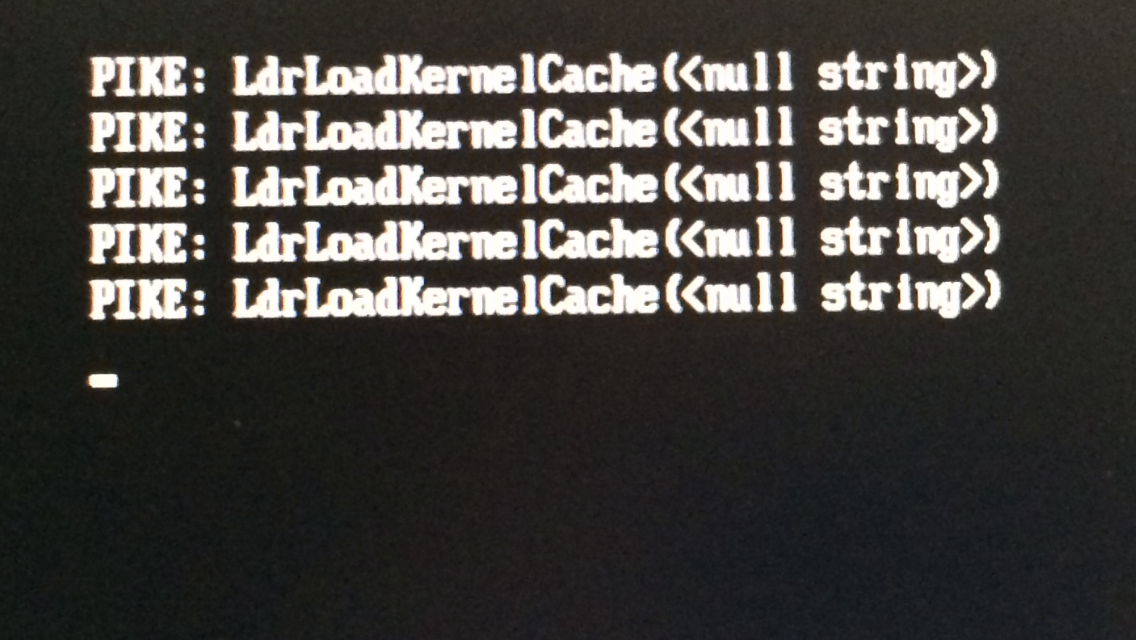

with the the bootbase.efi in place, the debug output is different:
EDIT
That is correct. The debug output was moved recently. You'll need a newer copy of boot base.efi
Note: What I want, and I am currently working on – hence the output – is a way to detect that the installation process is about to launch, and set a flag that changes the settings. After that nobody should ever need a special version of boot.efi (bootbase.efi) anymore.

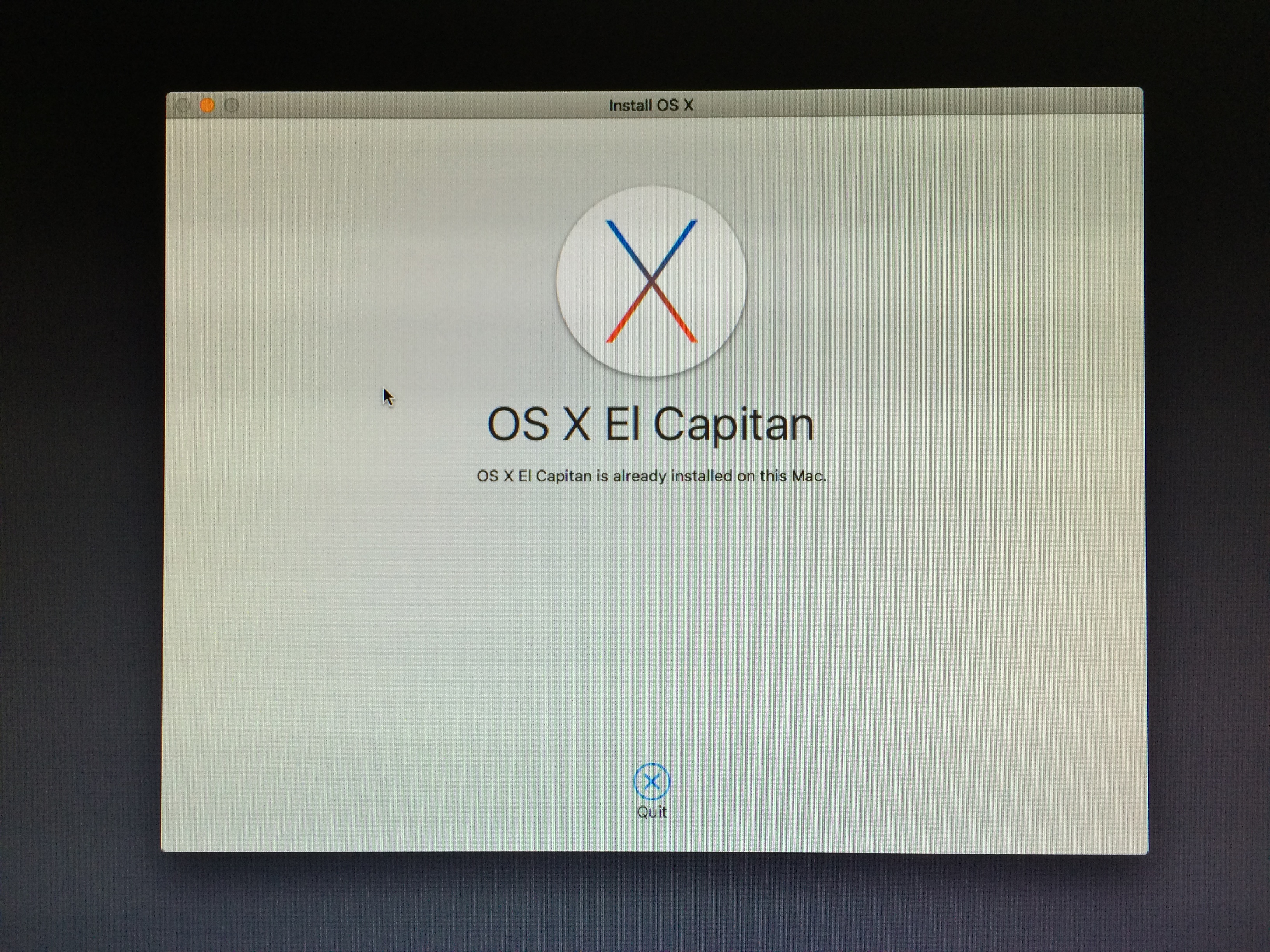

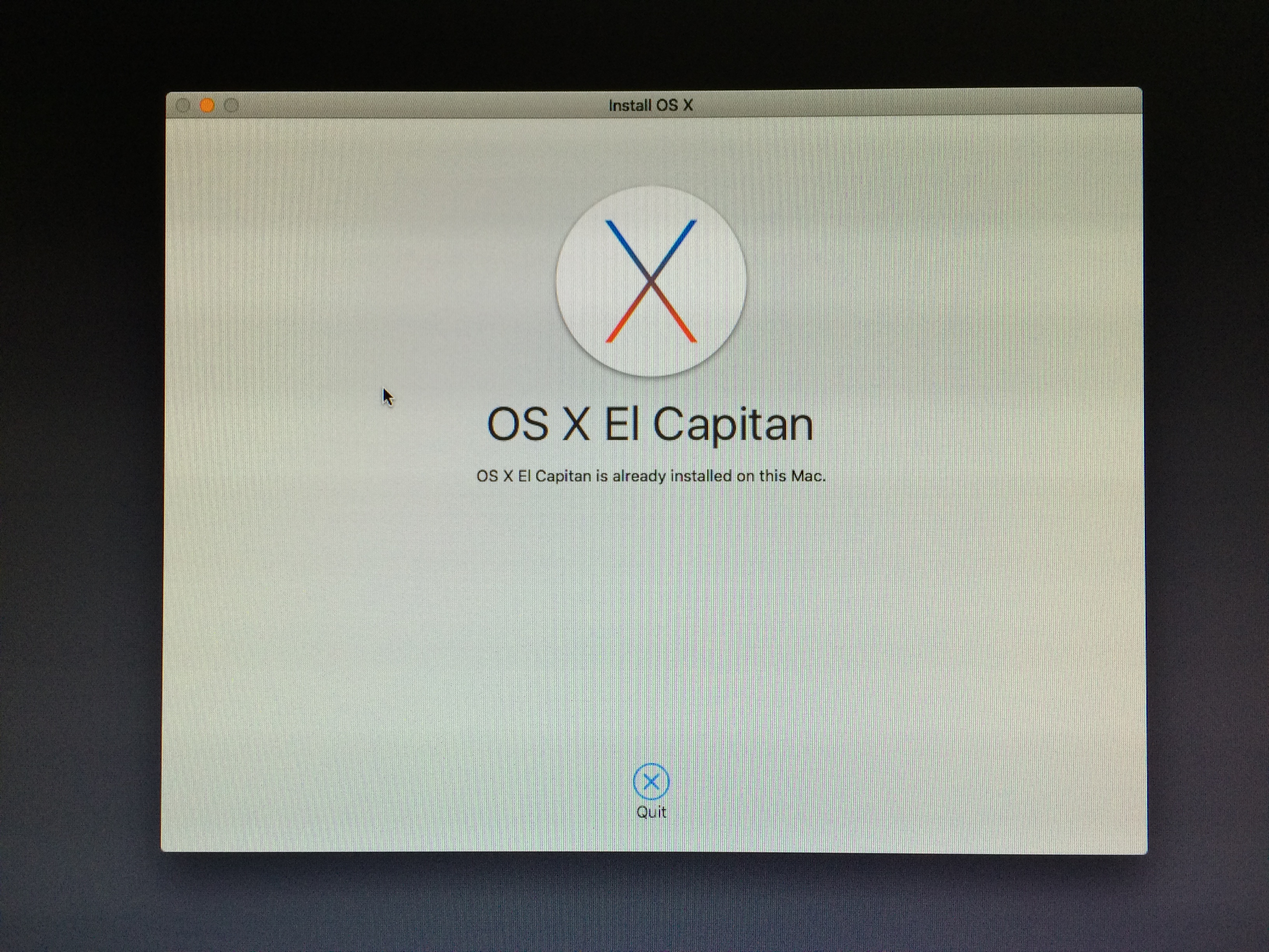

hm, when I'm attempting to actually install El Capitan, I'm getting this:
of course I then removed all the other disks that were installed in the system.
but this didn't change anything...
EDIT
ha! after adding the appropriate Board-IDs to "Distribution" in
/Volumes/Install OS X El Capitan/Install%20OS%20X%20El%20Capitan.app/Contents/SharedSupport/OSInstall.mpkg
the installation process runs right now as I'm typing :cool:
EDIT
