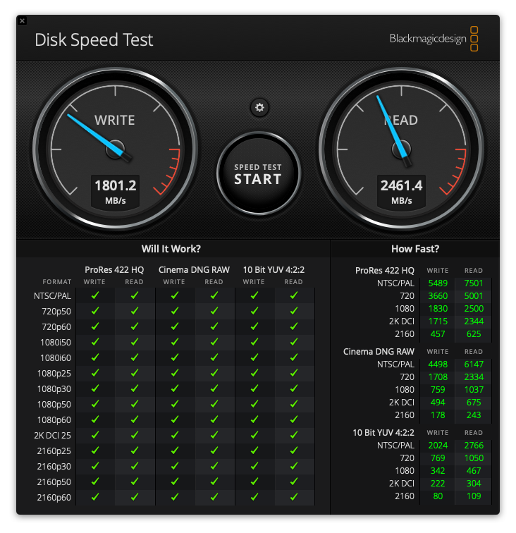

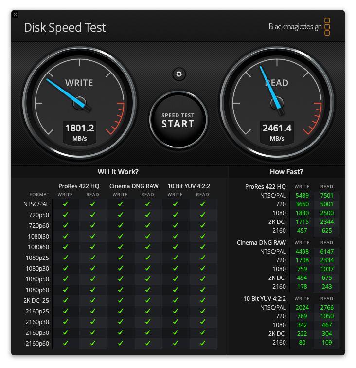

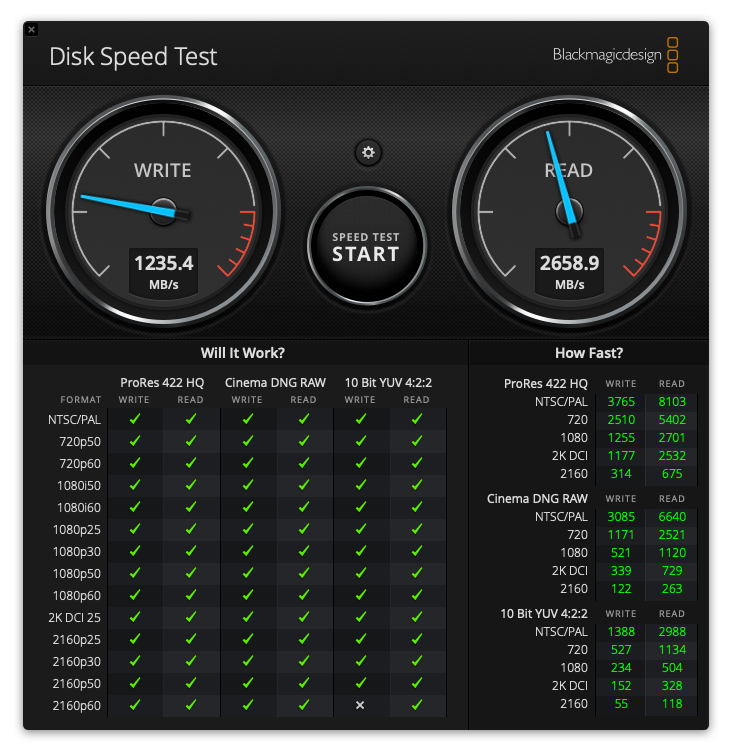

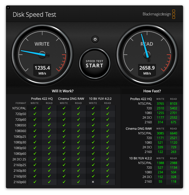

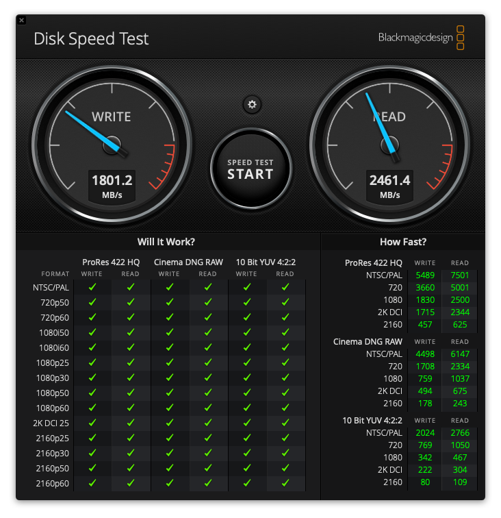

here are a couple of tests i just did:
2018 mac mini (256GB SSD)
Samsung X5 (500GB) over thunderbolt 3, connected to same mac mini
Interesting numbers in #19 above.
The read speeds are all-but equal.
But the X5 has write speeds that are about 50% faster than the internal Apple SSD.
