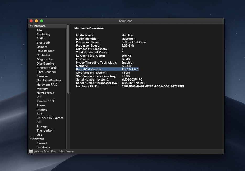

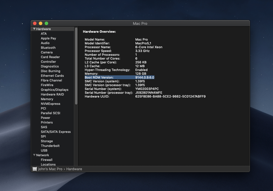

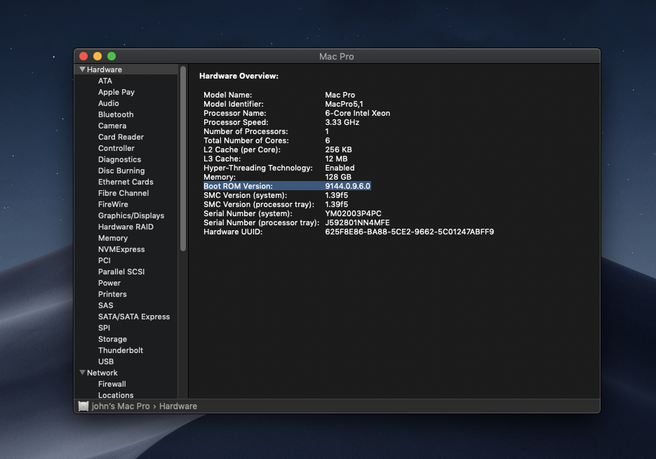

Hi Tsialex,
Have you seen this before? any idea how to fix it, I can not downgrade back to 2009! I can install Majove, but I can not upgrade to Monterey, it will ask for the requirement firmware need to be upgraded, then only I can do is shut it, I use Apple Metal Graphic Card, and reset fifth times of the NVRAM.
Thanks for the help, sorry about my English

Hi Tsialex,
Thanks for the help, sorry about my EnglishView attachment 2317380
System Information is showing BootROM Version 9144.0.9.6.0 because you booted from OpenCore instance that spoofs it, boot native and you will see the real Mac Pro firmware version. Since it's a cross-flashed early-2009 Mac Pro, you can also have BootROM issues.
If your real BootROM/System Firmware version is currently 144.0.0.0.0, your issues with installing Monterey are not related to the spoofing itself, since it's just a clever way to avoid unwanted EFI firmware updates from the spoofed Mac:
You are probably doing something wrong or your BootROM is problematic. I'd first check the real version, then be sure about the BootROM integrity. After that, go to the thread for the OpenCore solution you are using, probably @h9826790 package, and ask help there about the upgrade to Monterey.
Thank you so much for letting me know what happened, I did do the clean install, and now it is back to 144.0.0.0.0, but now, it seems can not upgrade to Monetery, I can not even install it, it shows the device can not be install any idea?
Thank you Again!
No problem, I fix it!
Thank you
