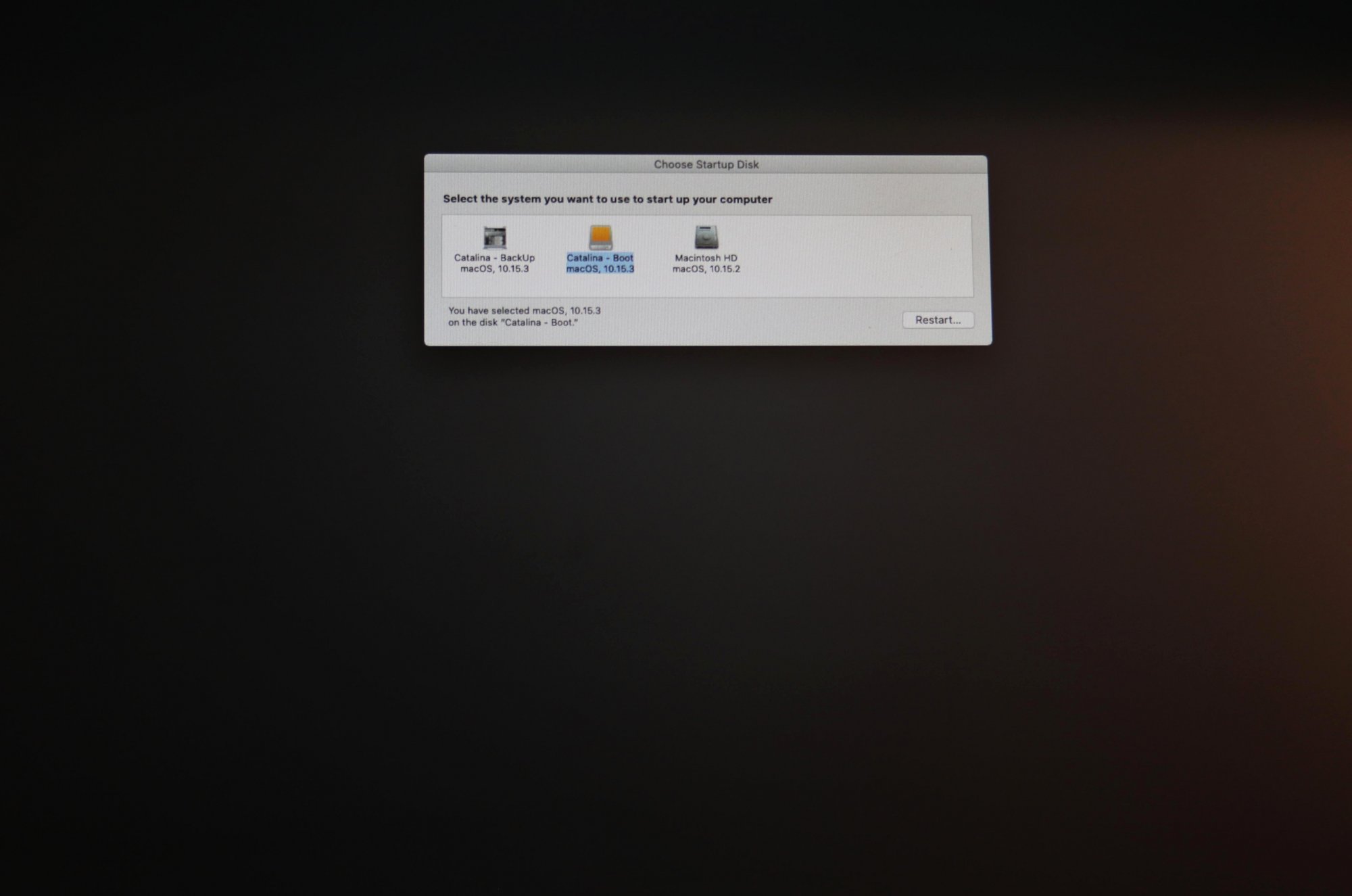

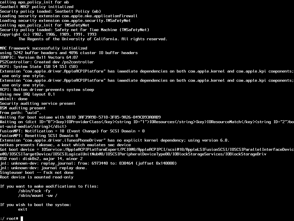

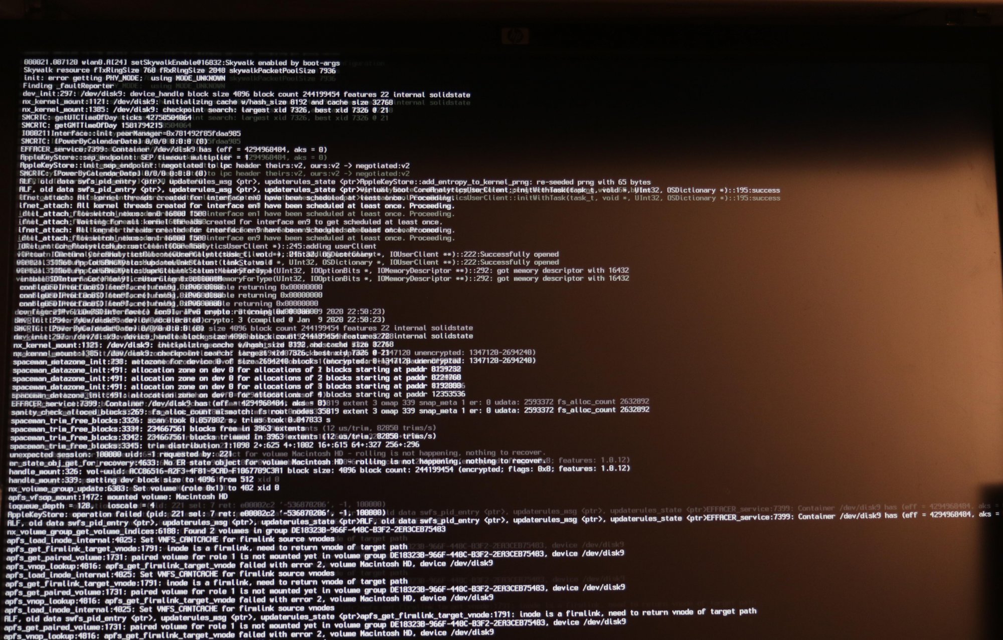

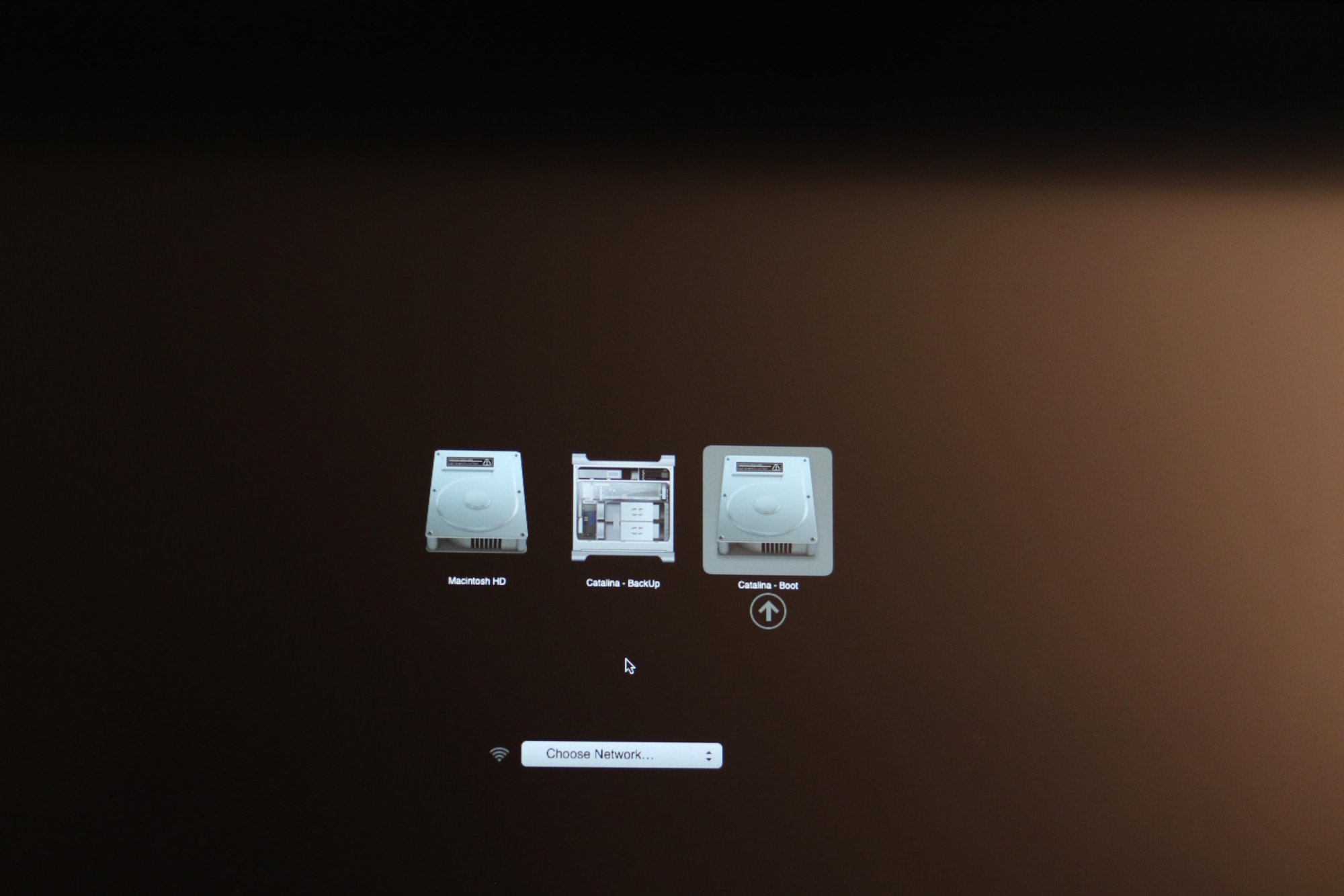

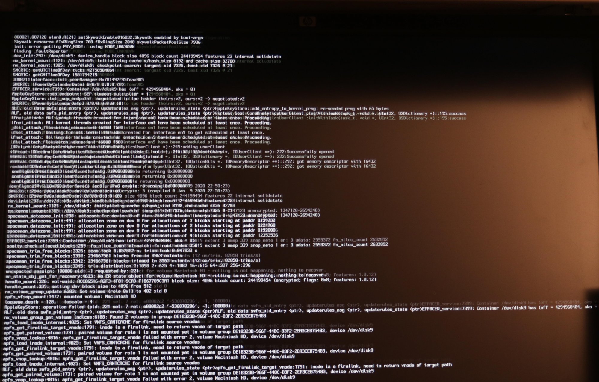

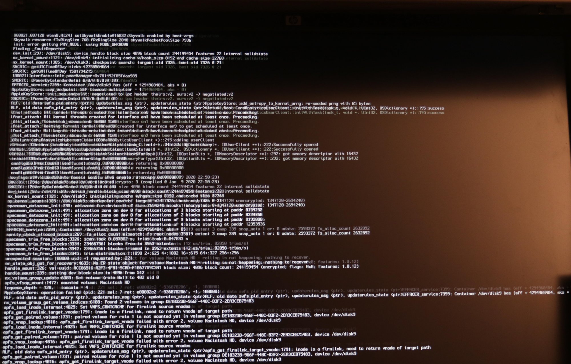

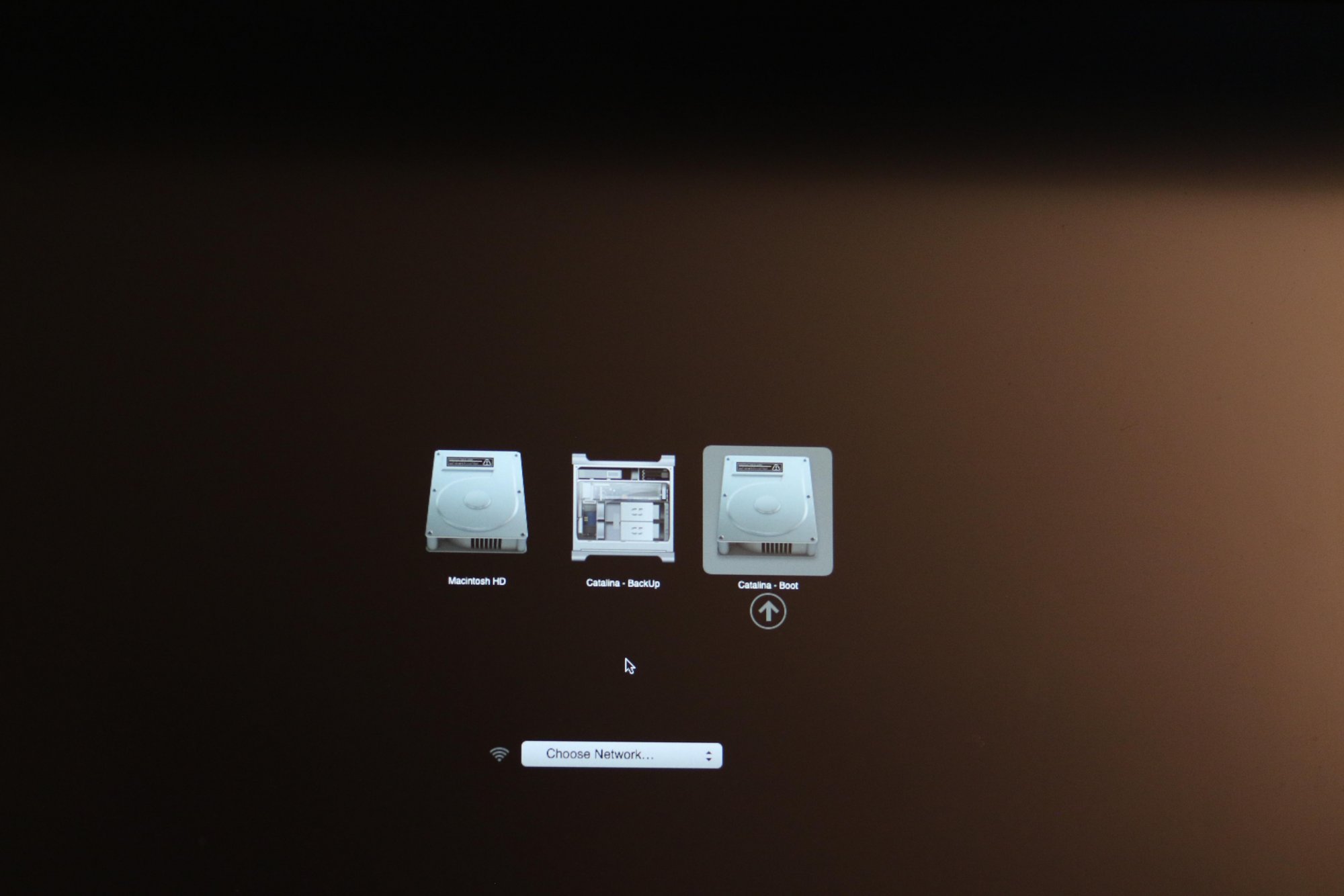

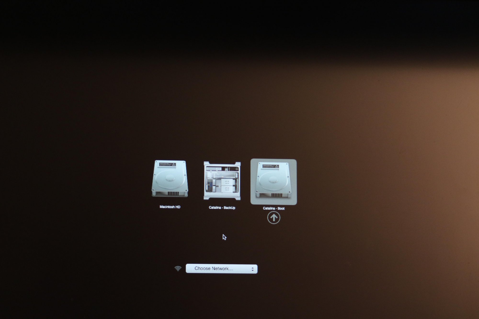

BootPicker and single user mode/verbose boot is what most people want to see.
OK
Lou
the bootpicker looks like this:
with ALT key at start
and single user mode like this:
cmd + s at start
if you can do booth, then you have a real bootscreen !

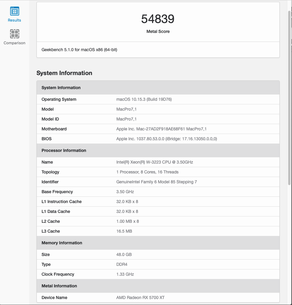

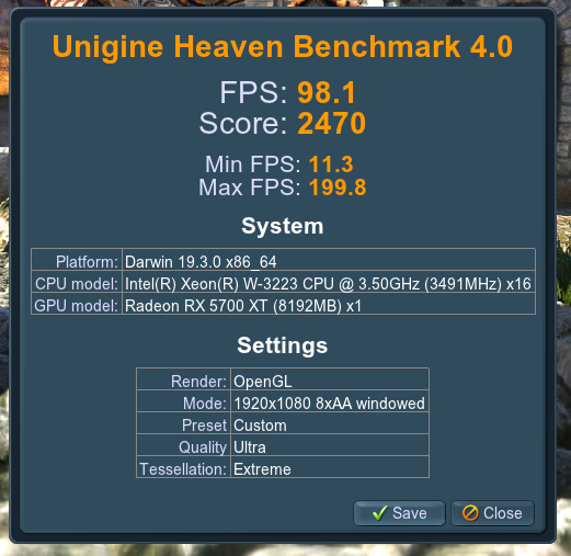

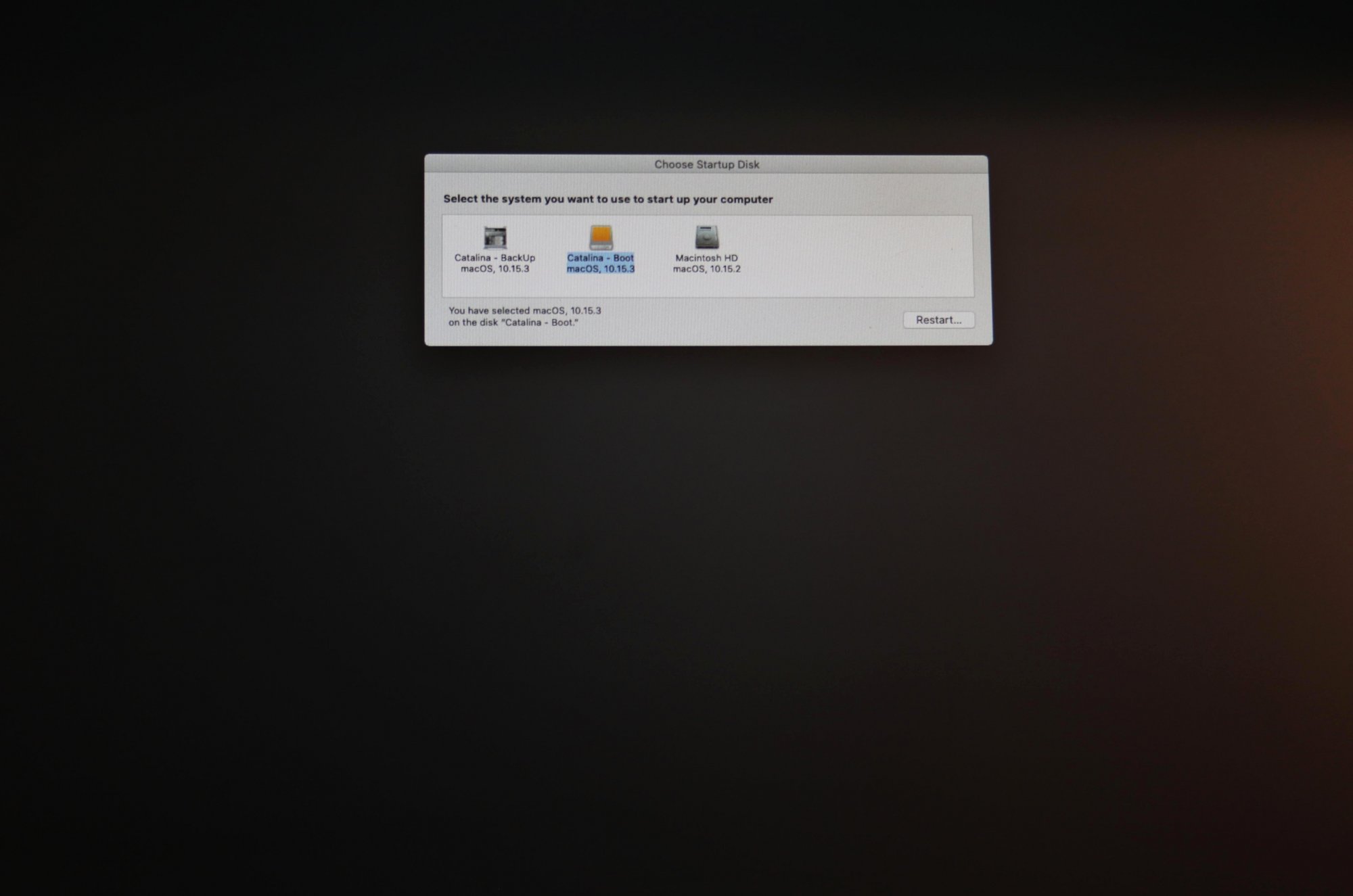

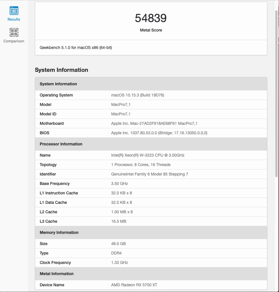

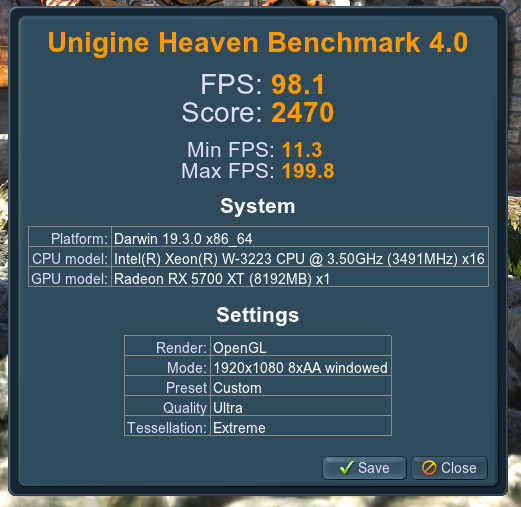

Put my Aorus RX 5700 XT in yesterday. Pulled the Pro 580X. Running fine for me. Boot Screens - A little strange, but I got it. On a cold boot, I get a stretched Apple and a long progress bar. On a Restart, the screen shows with the proper resolution. Also, the boot screen acts like a flashed card does in a 5,1 cMP. Near the end of the UEFI, transitioning to the desktop it will go to black screen then to the tail end of progress bar then to desktop.
Ran a couple of benchmarks:
View attachment 894160View attachment 894161
