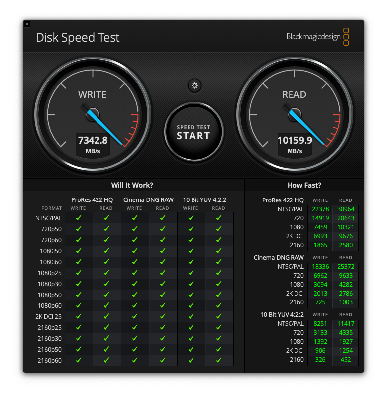

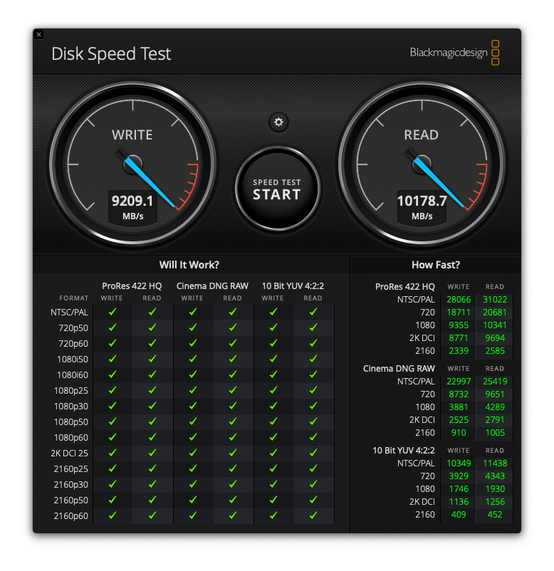

Anyway, thankfully, the machine booted with no issues and I did the work of getting the HighPoint driver and utility installed by disabling Secure Boot. Once that was done, I made a RAID0 volume on the first card just to do a test:
Pretty much in line with what others are seeing. I then destroyed that volume and created a RAID01 volume using the HighPoint utility. The results were again as expected: slightly slower writes but reads just as quick:
Again: the drop in write performance is expected since the controller is writing 2 copies of everything. That's going to cause a hit, no matter how good the controller is. But I can deal with 7.3GB/sec writes. Heh.
