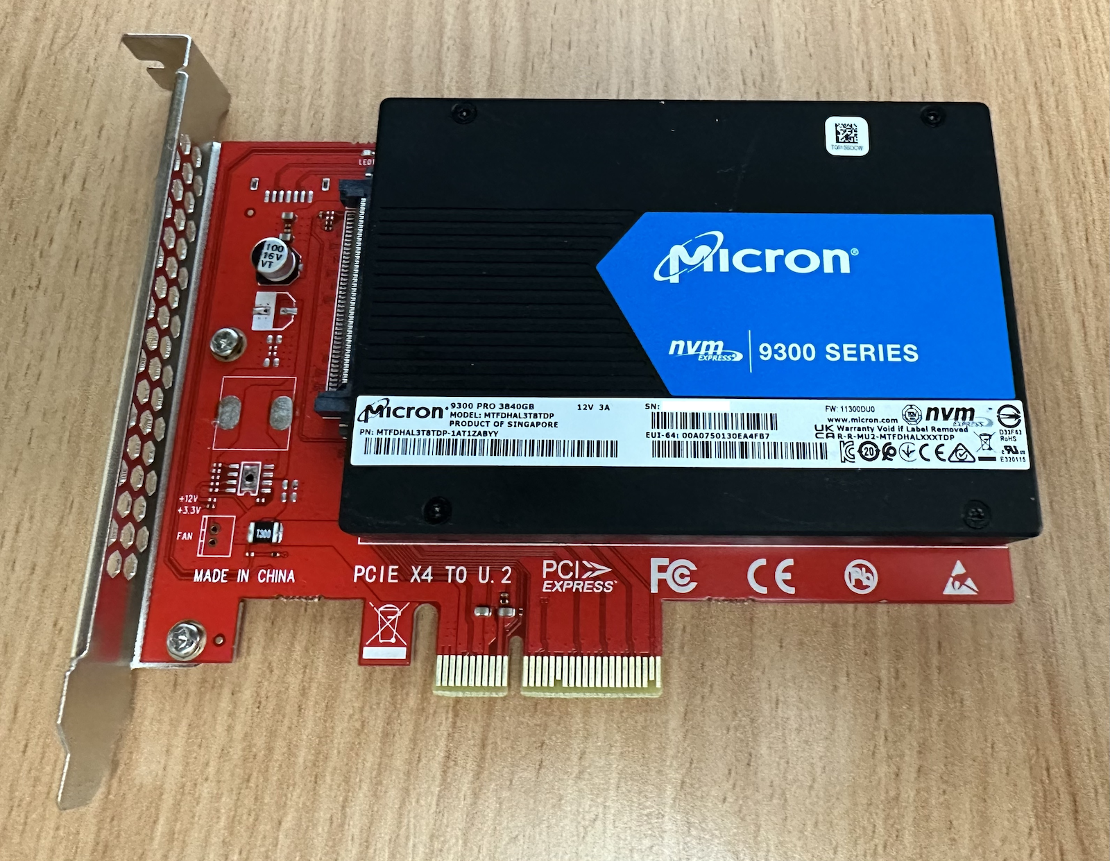

I have interesting situation with this model: Micron 9300 Pro 3840GB (U.2 NVMe):
When inserted in Mac Pro 2010/2012, machine doesn't chime. Tried in slots: 2,3 and 4.
Interestingly, Mac Pro 2.1 chimes with this adapter and El Capitan recogniose it as NVMe Express Controller but of course drive is not detected because it needs High Sierra.
Any thoughts why 5.1s doesn't even chime with it ?
