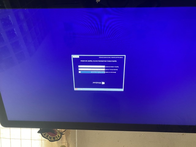

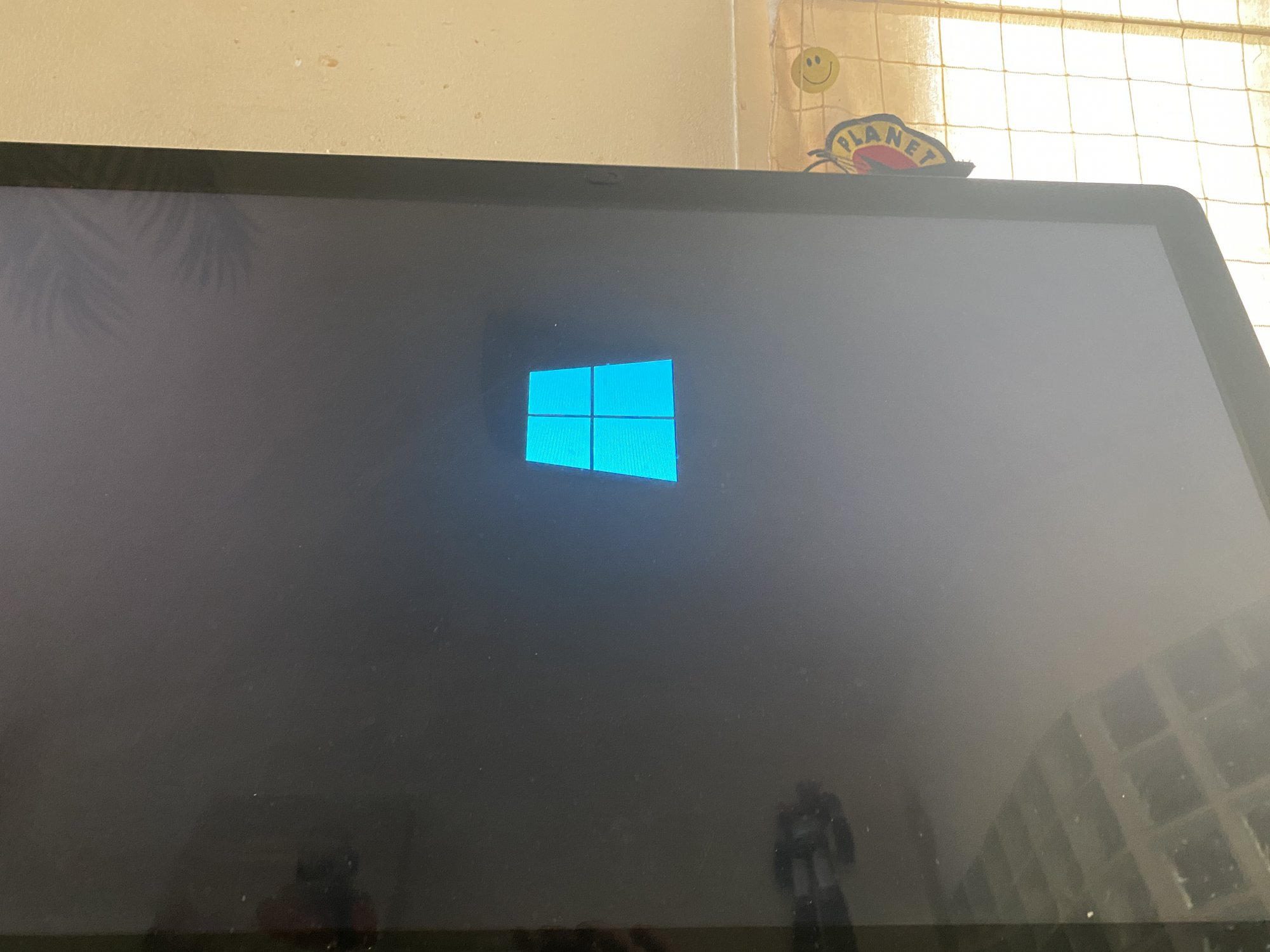

Reading the article. Im gonna try in an ESATA III. SSD.
There we go
Reactions: SystemHasFailed

how did you install Windows on that SSD? by usb or DVD? and how did you burn the Disk, on Mac or Windows?
Usb efi installs on the 5,1 are a very bad idea, unless bios is protected by open core, windows will write all
Kinds for stuff to bios, and brick it.
If not running opencore, do not install efi, install legacy mode, all info needed on all this is on this site....

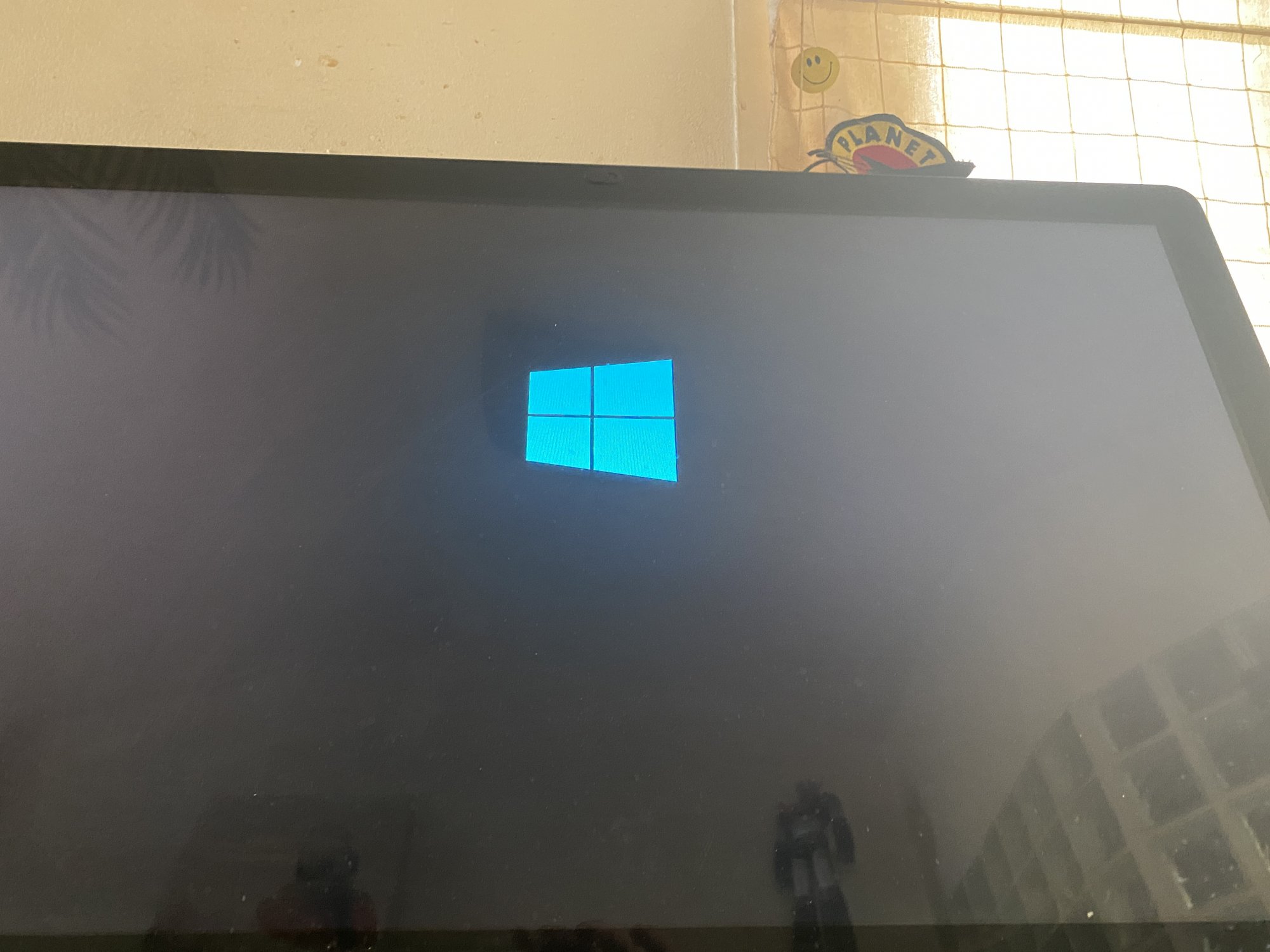

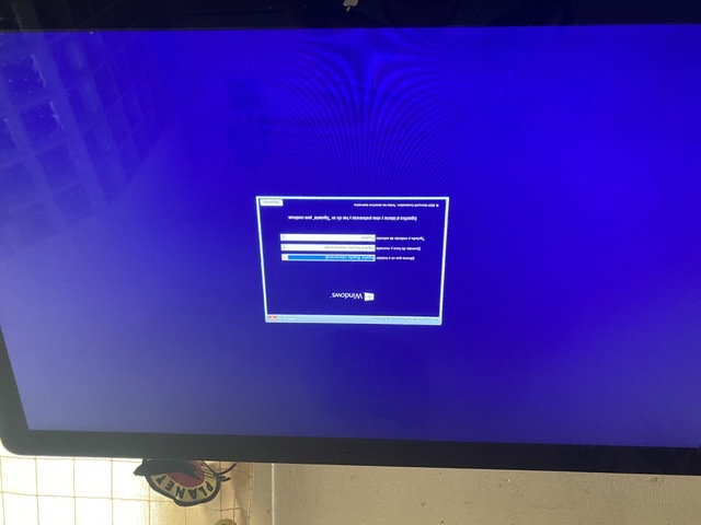

I just used a win 10, dvd, cheep on eBay, and a blank ssd, very simple install, no bootcamp needed.
Windows found every driver I needed on its own, except the updated WiFi/Bluetooth card...that was a pain...

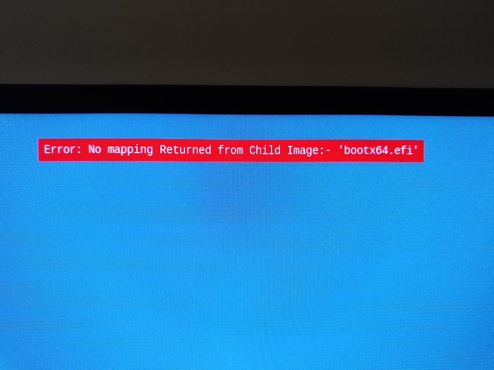

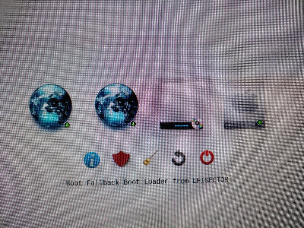

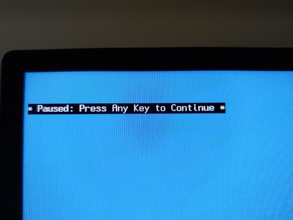

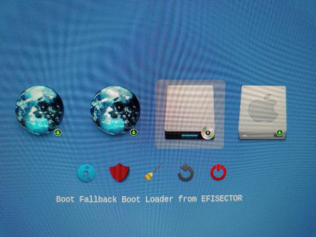

BTW, here's what I see when inserting a Win10 Pro OEM DVD into my cMP 5,1:
Selecting 'Boot Fallback Boot Loader from EFISECTOR' results in the following:
Along with:
Pressing any key just brings me back to RFP boot picker, but this time with a blue screen instead of custom banner:
So @Dayo, I can't install Win 10 via Mojave BOOTCAMP, nor will RFP allow me to boot the a Win10 installer DVD.
Thoughts?
Along with:
Thoughts?
I was never able to install Legacy Windows through RP. You will be able to from the Apple boot Picker with the DVD. You may try rEFInd chainloaded from RP. I always succeeded with VirtualBox method.
Along with:
Thoughts?
you can try remove every ssd / hdd but the empty ssd you want to install windows to.
avoid everything with the term efi in it.
fire up the mac, hold the c key and windows installer should boot from dvd.
Reactions: amstel78
