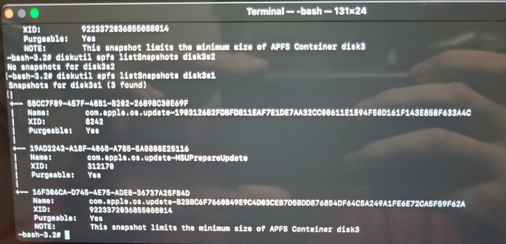

I am having the exact same problem in Beta 2. Managed to delete 2 snapshots in Recovery Terminal using the diskutil command, but the 3rd one says “insufficient privileges”. Annoyingly, this is the one that says “NOTE: This snapshot limits the minimum size of APFS Container disk2”. I suspect this is in some way related to the problem.

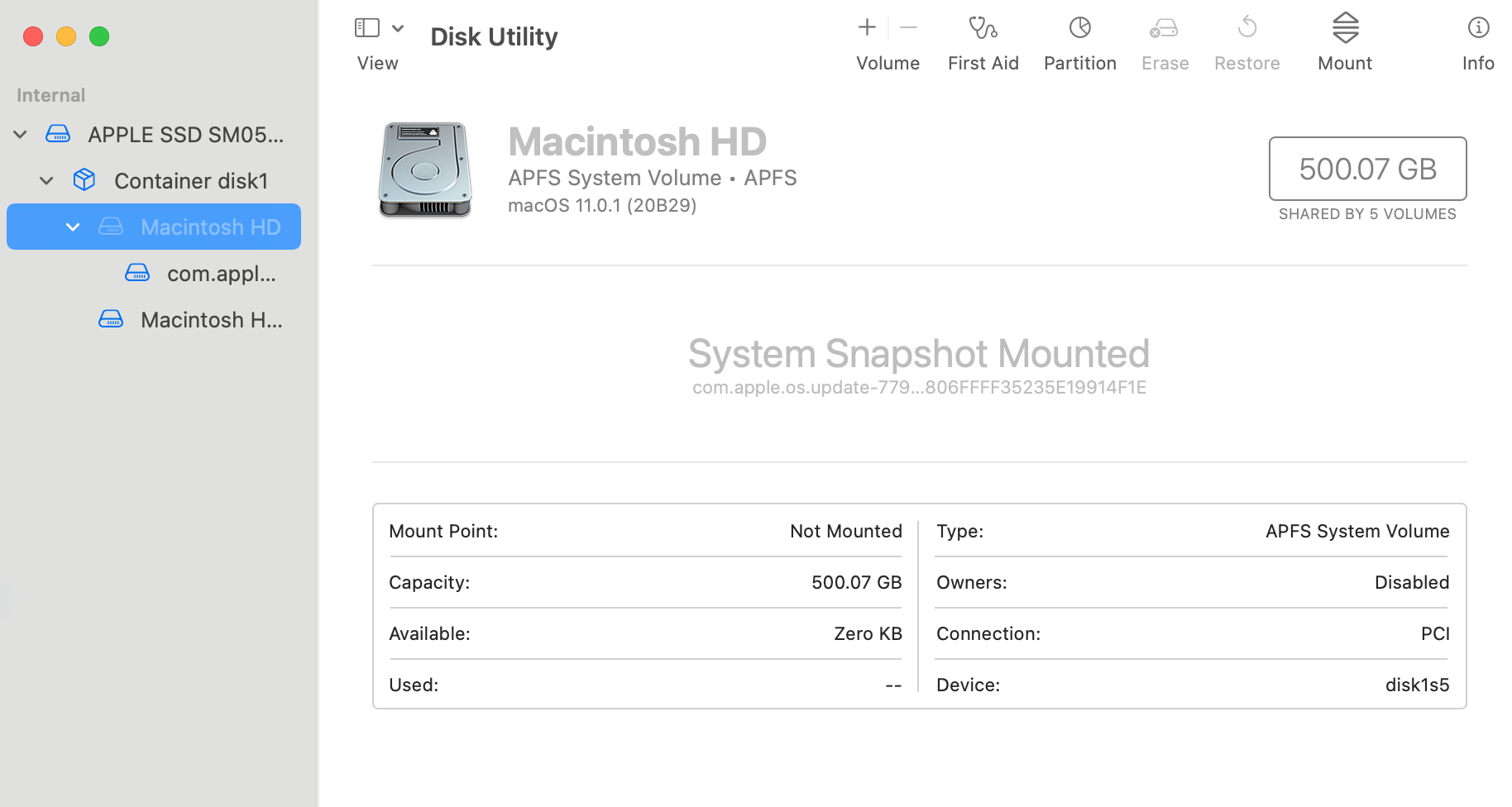

I am having the same problem as others in the thread: Boot Camp failing to partition the disk. I haven't been able to fix the problem using First Aid in Disk Utility (I am not experienced, though, and have perhaps missed something). I have never used Time Machine, but there is seemingly one System Snapshot on the device (com.apple.os.update-779BDF1556C6F68), presumably generated during the Big Sur install. I would like to know if it would be safe to try and delete that snapshot, seeing as someone earlier in the thread mentioned that the OS may be booted from it. Indeed, Disk Utility seems to indicate this, but only after running First Aid. Please let me know if you do or don't understand what I mean.

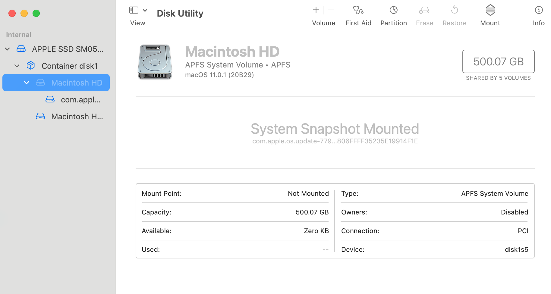

Thanks. I'm leaning towards just trying it. The fact that Disk Utility looks like this makes me apprehensive, though:
Like I said, this is how it looks and stays after running First Aid. If I try using Boot Camp again, I get to the partition failed alert, but then everything looks more normal in Disk Utility, with Macintosh HD not greyed out and the snapshot just sitting there looking more expendable. Not sure what to make of it, tbh.

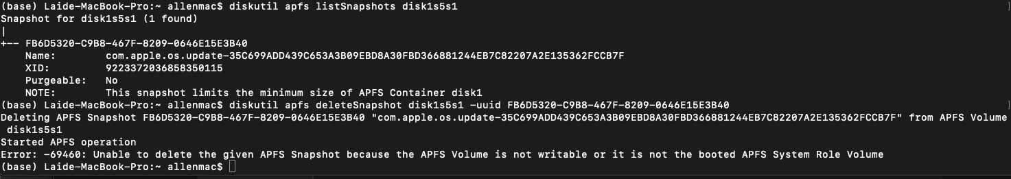

Thanks. It appears to be the one and only snapshot on my system. But yeah, at the moment it is seemingly mounted instead of the normal Macintosh HD. When I run `diskutil apfs listSnapshots` on Macintosh HD (disk1s5) I get: "Error getting list of snapshots for APFS Volume: A disk with a mount point is required (-69854)". I have read and been told elsewhere that the disk not being mounted is normal in Big Sur, though, but I don't really understand. And like I said, this changes after I run and fail Boot Camp. 🤷‍♂️

So I went ahead and tried to delete that single snapshot in Recovery and, yeah, it's the insufficient privileges one. I tried Boot Camp again anyway after restarting and unfortunately no luck— it still fails when partitioning.

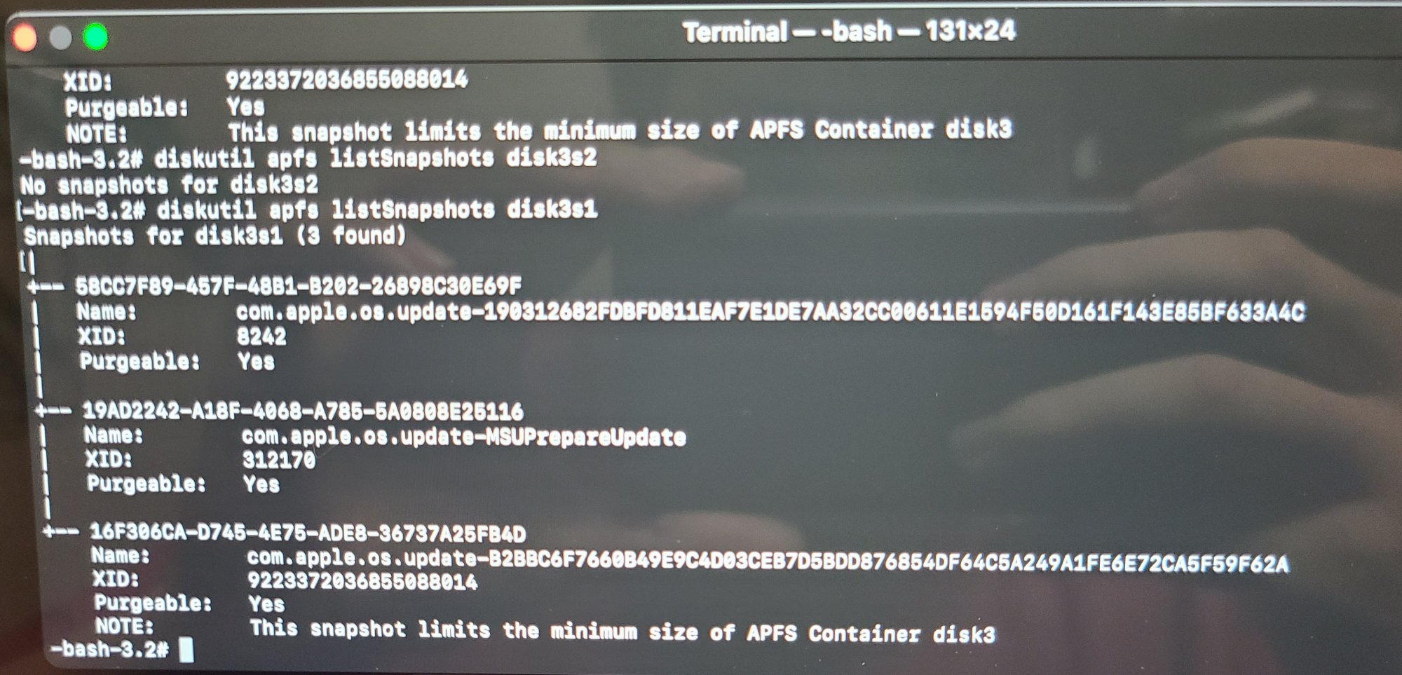

I just found old photos I took of my screen before I deleted my snapshots. Do the snapshots say they are purgeable? Here's what it looked like. I don't know if it would help, but I'll share anyway.
Nope, it's just the one snapshot, and it's not purgeable. I think the problem is that I must have deleted my old (I think pre-APFS) Windows partition using Disk Utility, or at least done it wrong somehow. Unless you can think of a fix for this off the top of your head, I'm just waiting for a call from Apple on Monday. Cheers!
