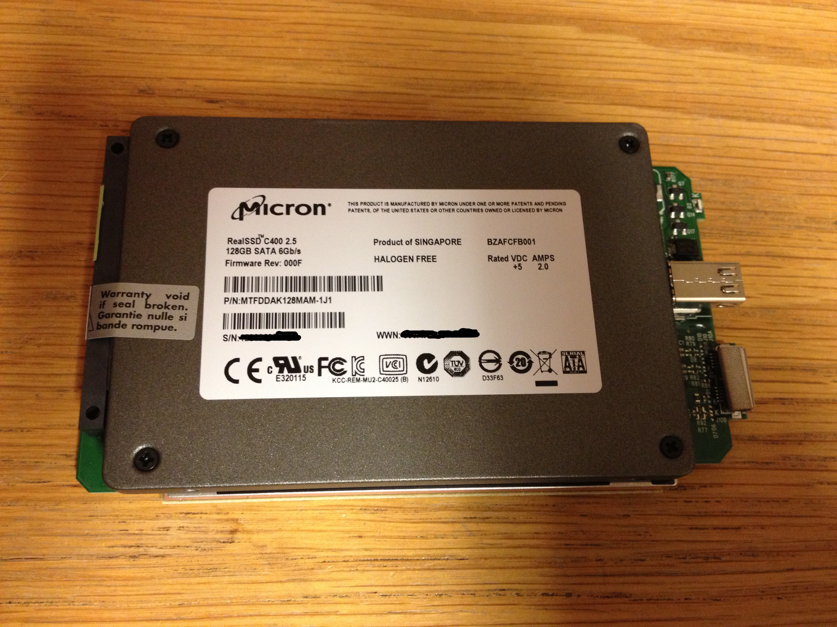

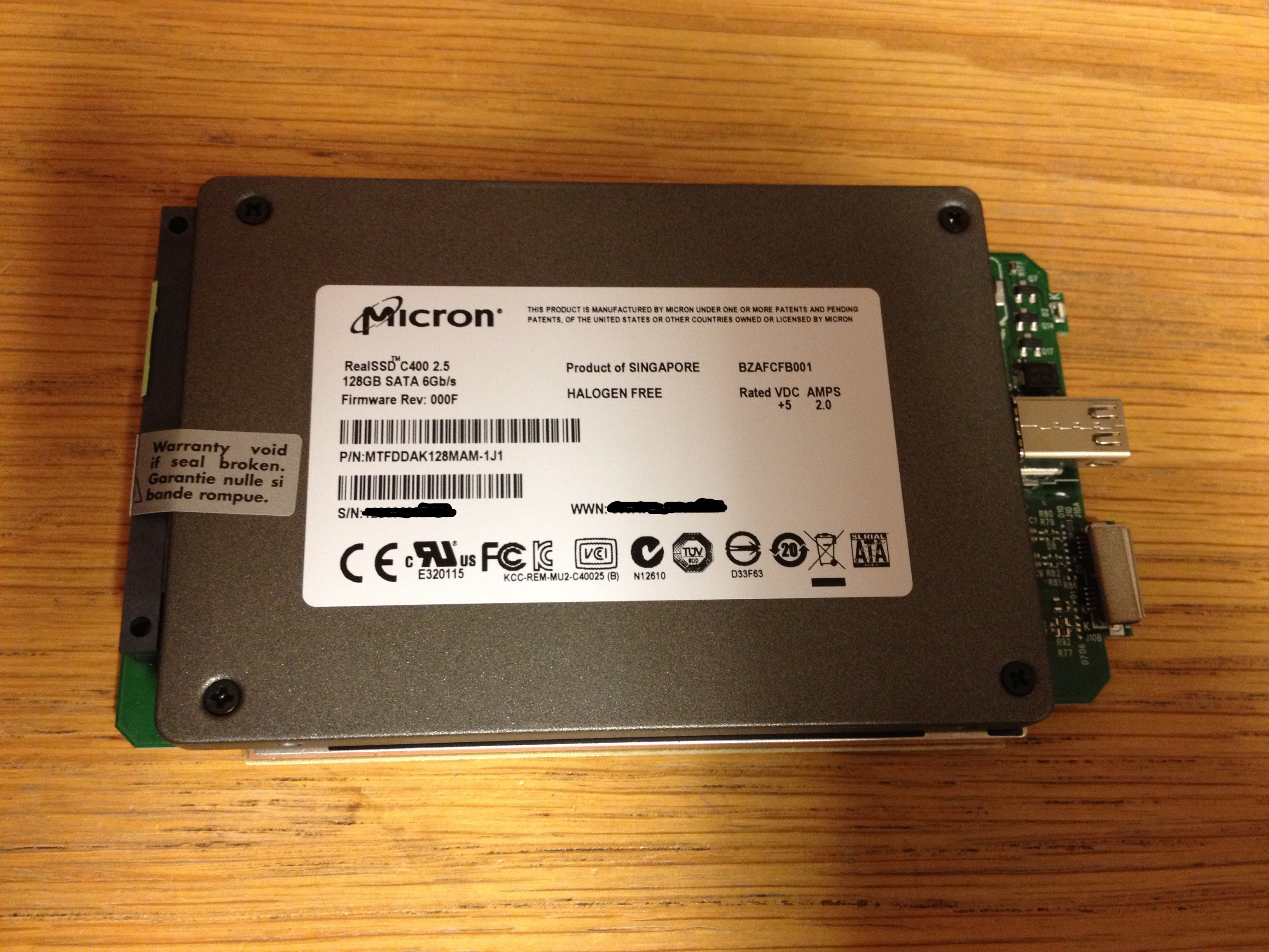

I can also recommend the use of LaCie Rugged Thunderbolt SSD to be used as the boot disk! (2011 27" iMac) I hooked up the TB SSD disk this weekend and installed a new clean copy of Mountain Lion on it. It is a nice overall speed increase and definitely worth it!
In my case it is the 120GB model as it was the budget limit at the moment, so it will only contain OS and programs.
While not as fast as a dedicated internal SSD it was in the end the better solution for me (family politics 🙄).
I believe that the TB to SATA controller in LaCie's setup limits the performance somewhat, those who wan't to try it out can easily swap out the SSD for a more extreme one, as it at least looks very standard to me:

Is that the only warranty sticker in the drive?
Yes, that is the only one as far as I could see. No special tools needed.

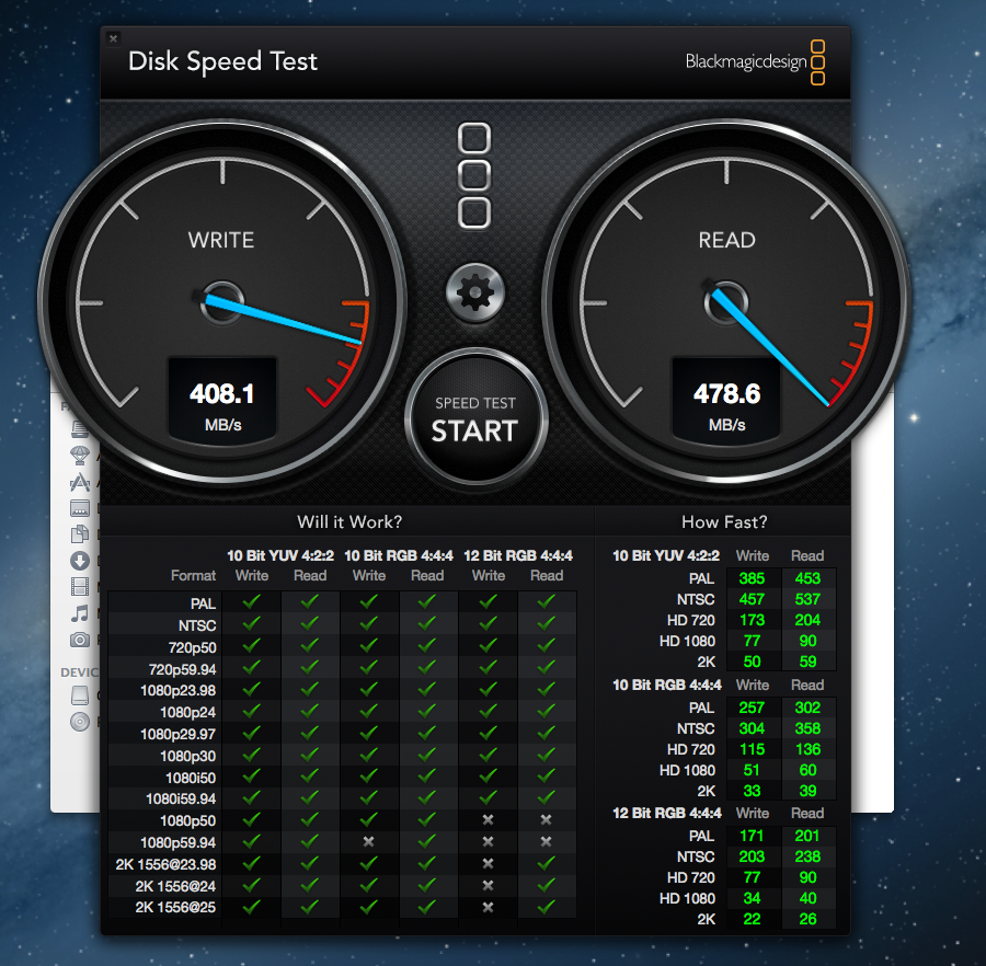

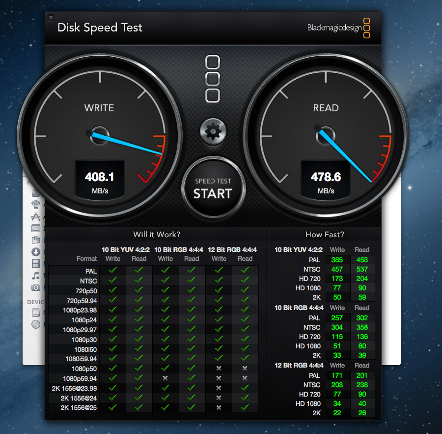

After reading this i decided to get myself a LaCie drive, 256gb SSD version.
I got roughly the same blackmagic results as yours on thunderbolt, But.... USB3 Read is FASTER?.
USB3 - 241MB/s Write, 436MB/s Read
Thunderbolt - 250MB/s Write, 381MB/s Read
If you have USB3 would you try yours on USB3 and see if you get the same results.

I still say something other than the drives in the TB enclosures are slowing things down.
Shouldn't be the case. I'm going to run some Samsung 840 pro SSD disk benchmarks later in a MyDuo TB case and see what going on there.
The drive in this enclosure (m4) is rated at 300 MB/s write and 550 MB/s read. so something is slowing them down, its appears something to do with thunderbolt is slowing it down more than USB3 which i just dont get.

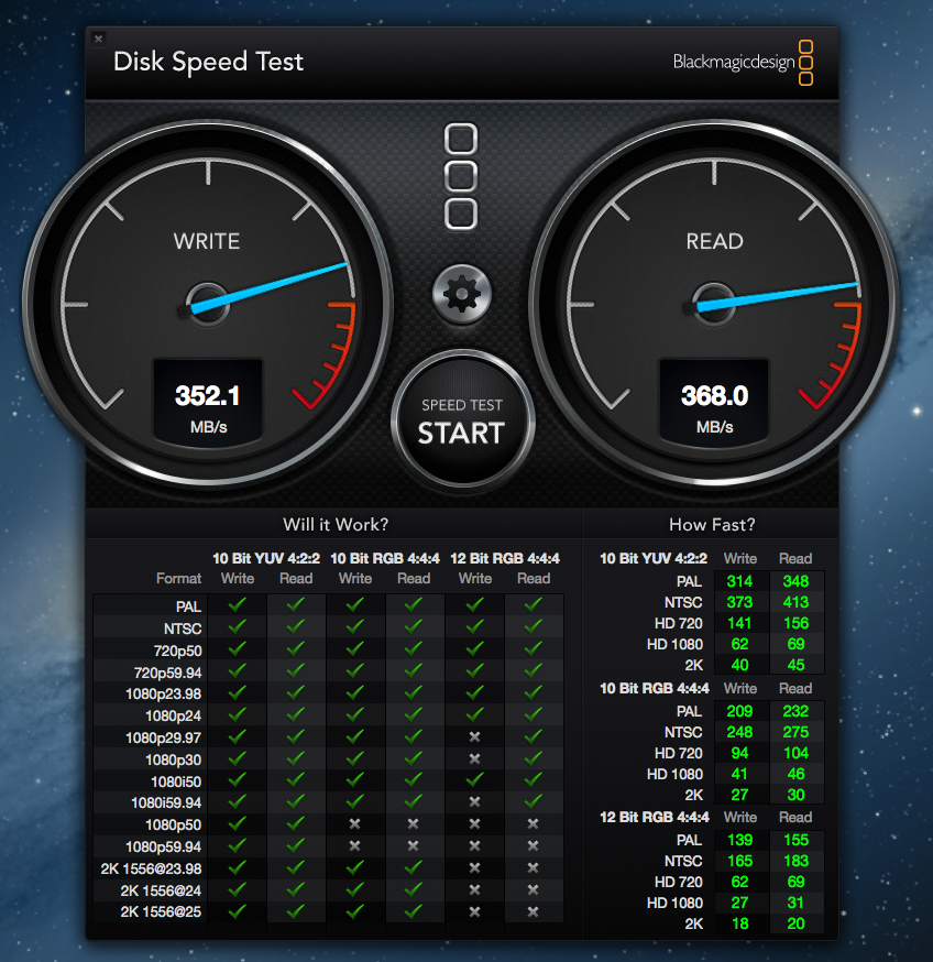

With an OWC Mercury Extreme Pro 6G, I found the same result. I really expected only a very small slow down due to the TB to sata bridge, but it is very noticeable.

is there some reason im only getting 199mb write and 350 read or is the 128gb lacie rugged a little slower than the 256? this is on a 2012 imac 27"
I have a OWC Mercury Xtreme Pro 6G 480gb ssd ina TB enclosure and a Fusion drive in the imac. The read speed is noticeably slower on the TB SSD. In fact Geekbench is about 1000 points slower. And I have more than filled my fusion portion of the ssd, so some of the i/o should be on the 7200 drive I would think.

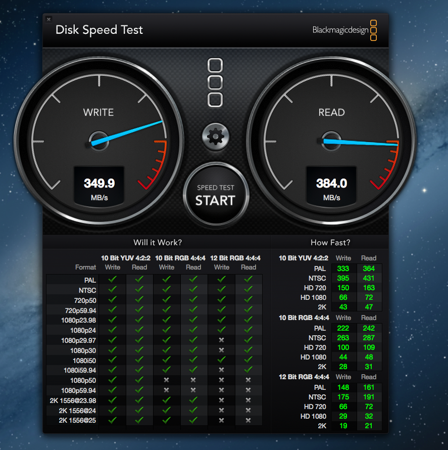

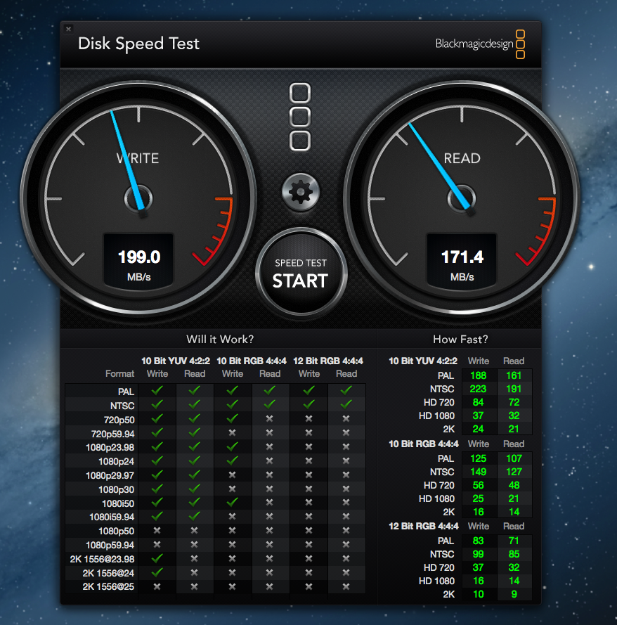

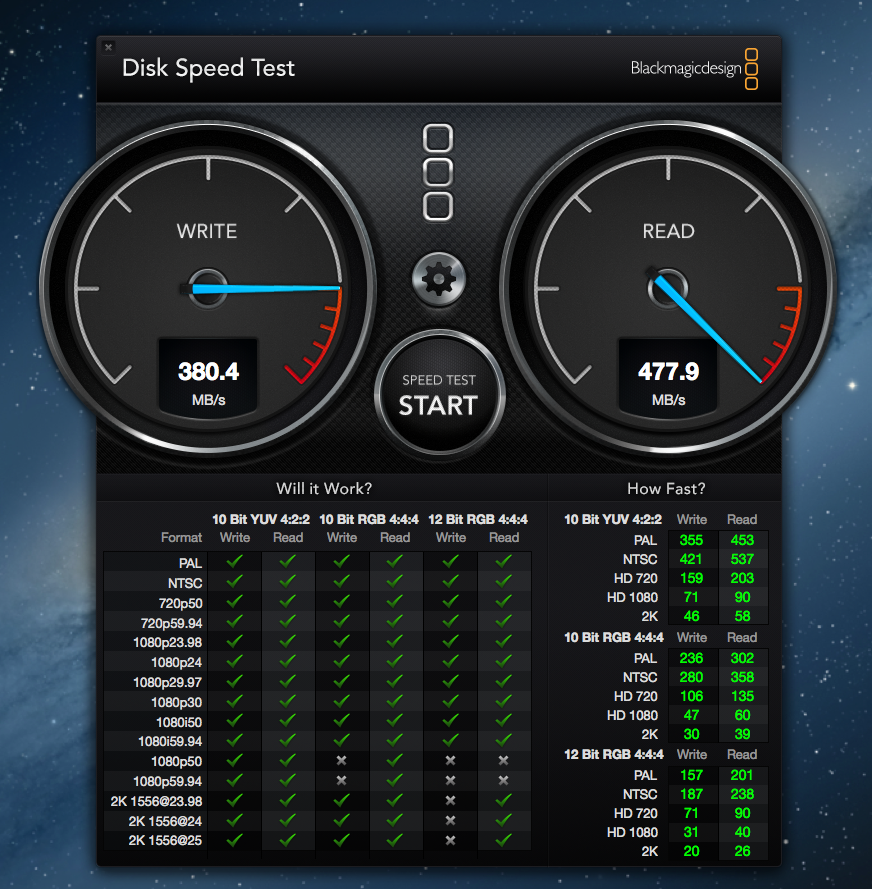

I thought I'd join the discussion by posting my findings comparing USB3 vs. 2 Thunderbolt solutions for those with SSD's that they want to use externally via TB. Note that cost might be a factor if you have to buy the SSD and the adapters. That will just have to be weighed against just getting an all in one TB unit from LaCie or USB3 units from other manufactures. My tests were really to find out what were the best performing options through Thunderbolt for my SSD's so I can pair that with my incoming 2012 iMac with 3TB Fusion.
Here are the 3 scenarios I tested using the Black Magic Disk Speed Test (used this so everyone could compare against the tests already on this thread) on a 2012 MacMini i5 I had handy.
SSD's:
Samsung 840 Pro 128GB
OCZ Vector 512GB
What you'll immediately notice is that the enclosure components make a huge difference where thunderbolt throughput is concerned. The OWC + X2 gets me the closest performance to what the drives full capabilities are but, at a price to my wallet. Secondly, the Seagate works well but, something in the SATA III to TB translation is slowing the unit down hitting performance. Third the USB3 performance was interesting considering ste0803 opposite results again proving that spec implementation of USB3, SATA III and Thunderbolt are key to the performance of our SSD's.

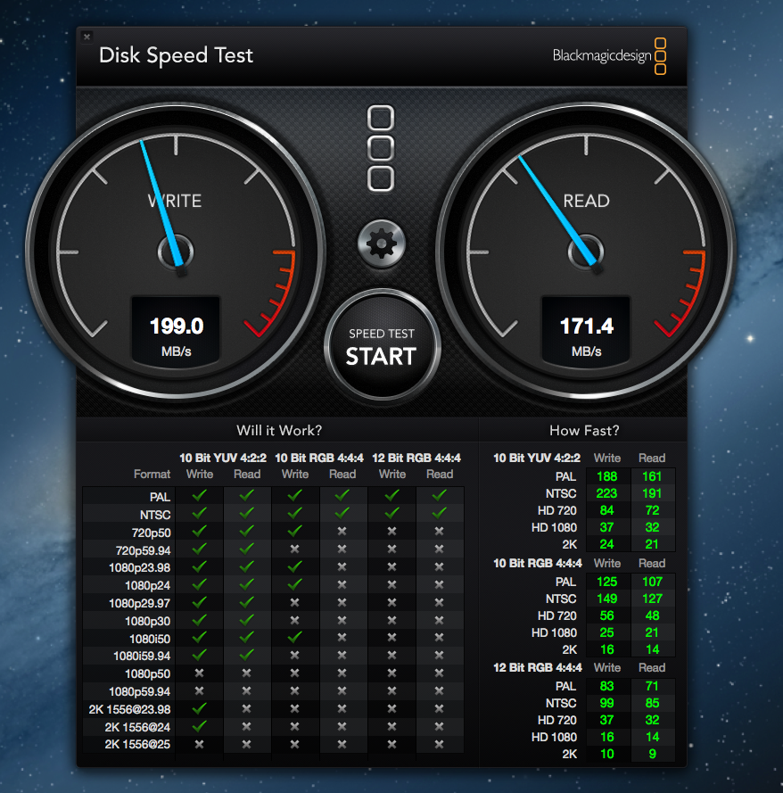

Here are the further results.
Samsung 840 Pro Performance (mouse over each image to see label)
*Note: the 840 Pro wouldn't connect via the ICY Docks USB3 connection so, I don't have results for that drive via USB3.
In the end I'll stick with the Helios solution. Two things stand out the X2 PCIe card allows for 2 SSD's to be connected but, only allows power to 1 drive. I talked to Apricorn already that perhaps their next revision allows for 2 SSD's with power. I also think that the Helios is being held back from fully utilizing the 840 Pro and Vector due to the X2's throughput (although it states 550Mb/s)
