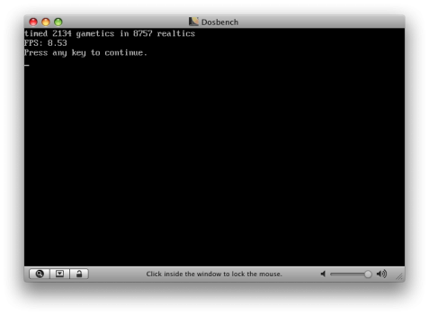

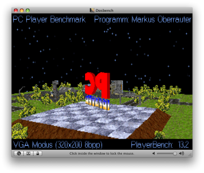

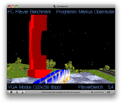

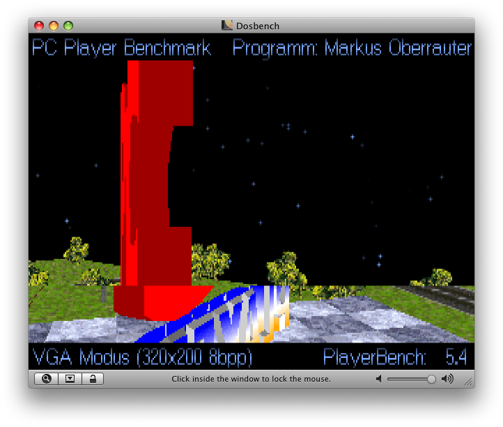

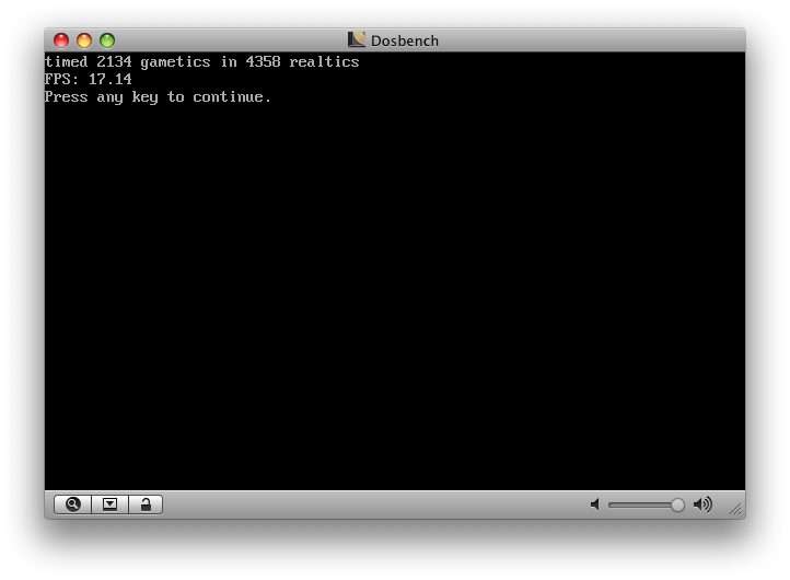

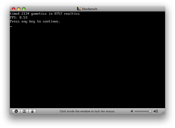

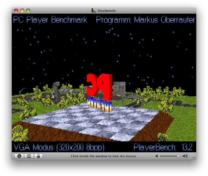

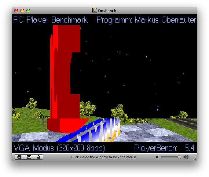

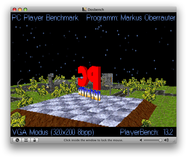

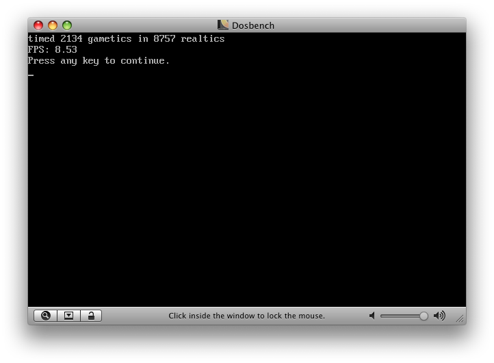

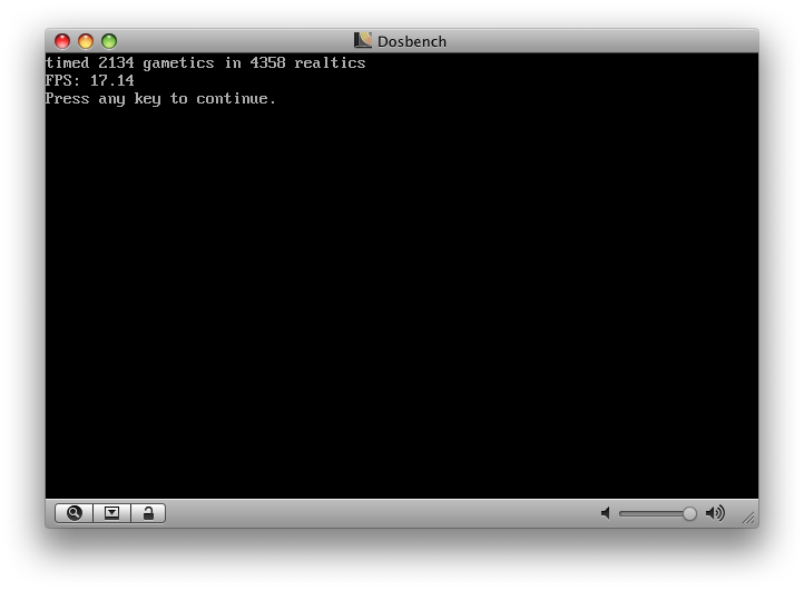

For years, I've been wanting to see the DOSBox PPC JIT patches brought into Boxer. For those who have not tried it, it's a really nice OS X interface that makes using DOSBox easier. Today, I would like to introduce the availability of a functional release of the Leopard Legacy branch of Boxer that does just that! You can see the peformance before and after the PPC JIT compiler in the attached screenshots.
It backports the work of jmarsh on vogons and the patch that built on this work distributed by Dr. Cameron Kaiser on SourceForge.
