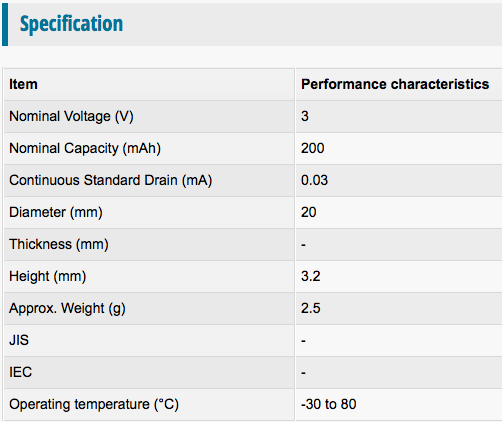

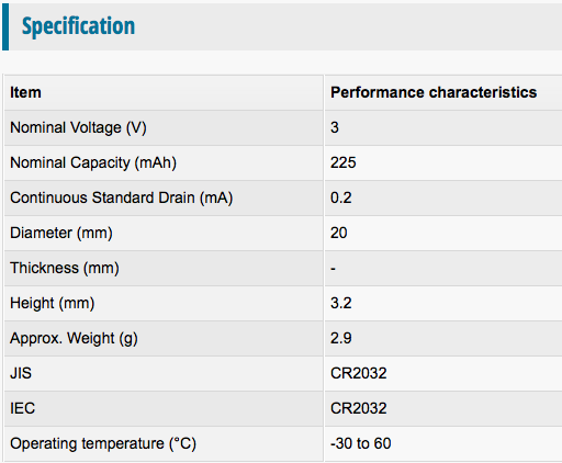

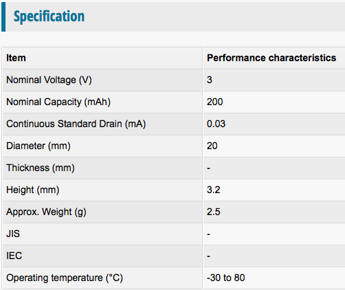

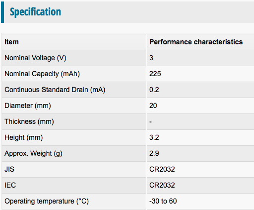

Another difference between BR2032 and CR2032 is the chemistry tolerance for high temperatures of BR2032, BR2032 is rated for 80ºC wile most CR2032 are rated for only 60ºC.
Panasonic BR2032:
Panasonic CR2032:
This is important for a Mac Pro or a Mac mini, since both are located in high temperature areas. A CR2032 in a Mac mini will fail in less than a year.

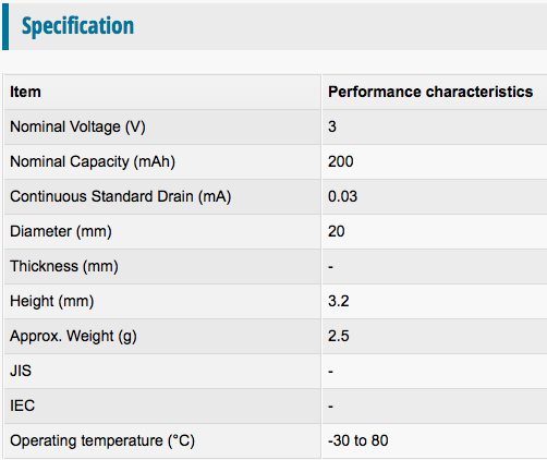

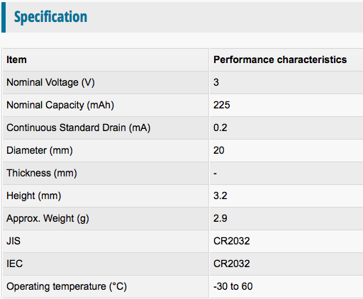

Panasonic BR2032:
Panasonic CR2032:

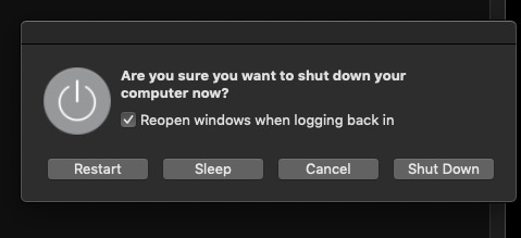

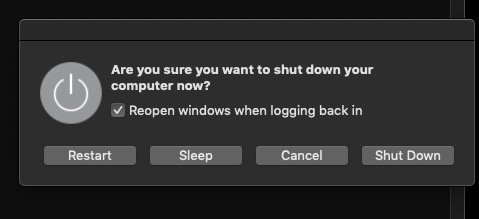

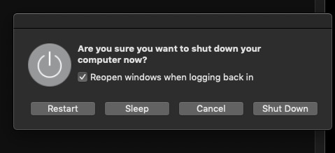

Could a faulty battery cause this message - see attached picture - on an MacPro 5.1?
Or could this be related to any issue on the connected 30" Cinema Display?

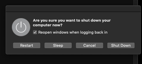

When the RTC battery is below 2.9V a lot of crazy things start to happen, but I never got this exact one.
Anyway, you should check the BR2032 battery with a voltmeter/multimeter and replace it whenever below 3.00V.
Think of it another way, a 5.1 is about 10 years old now and replacing that battery is just cheap maintenance.
I replaced mine about year ago, and the spurious hang during boot went away. Before the battery replacement, I would constantly need to hold Opt during boot and select my boot drive!
