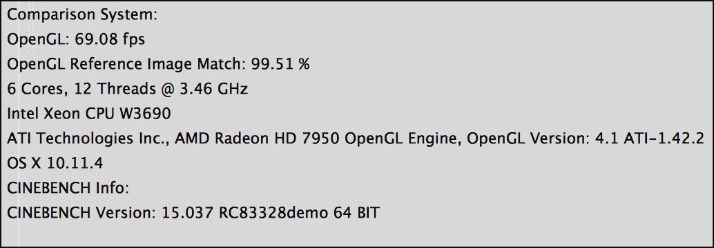

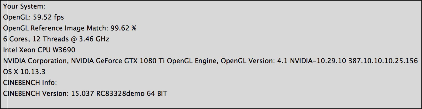

CineBench OpenGL test is a well known very CPU single thread limiting test. And my 1080Ti is 15% slower than my HD7950 in this particular benchmark. Which indicates that web driver is more CPU single thread limiting then the AMD driver in MacOS
