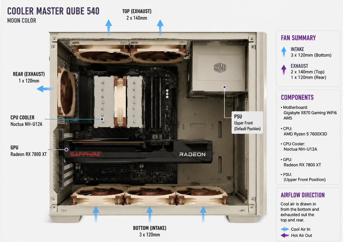

I researched fan placement and used chatgpt to visualize how the fans should go
The reality is that I was unable to get a 3rd 120mm fan in place due to the PSU wires. More about that in post #2

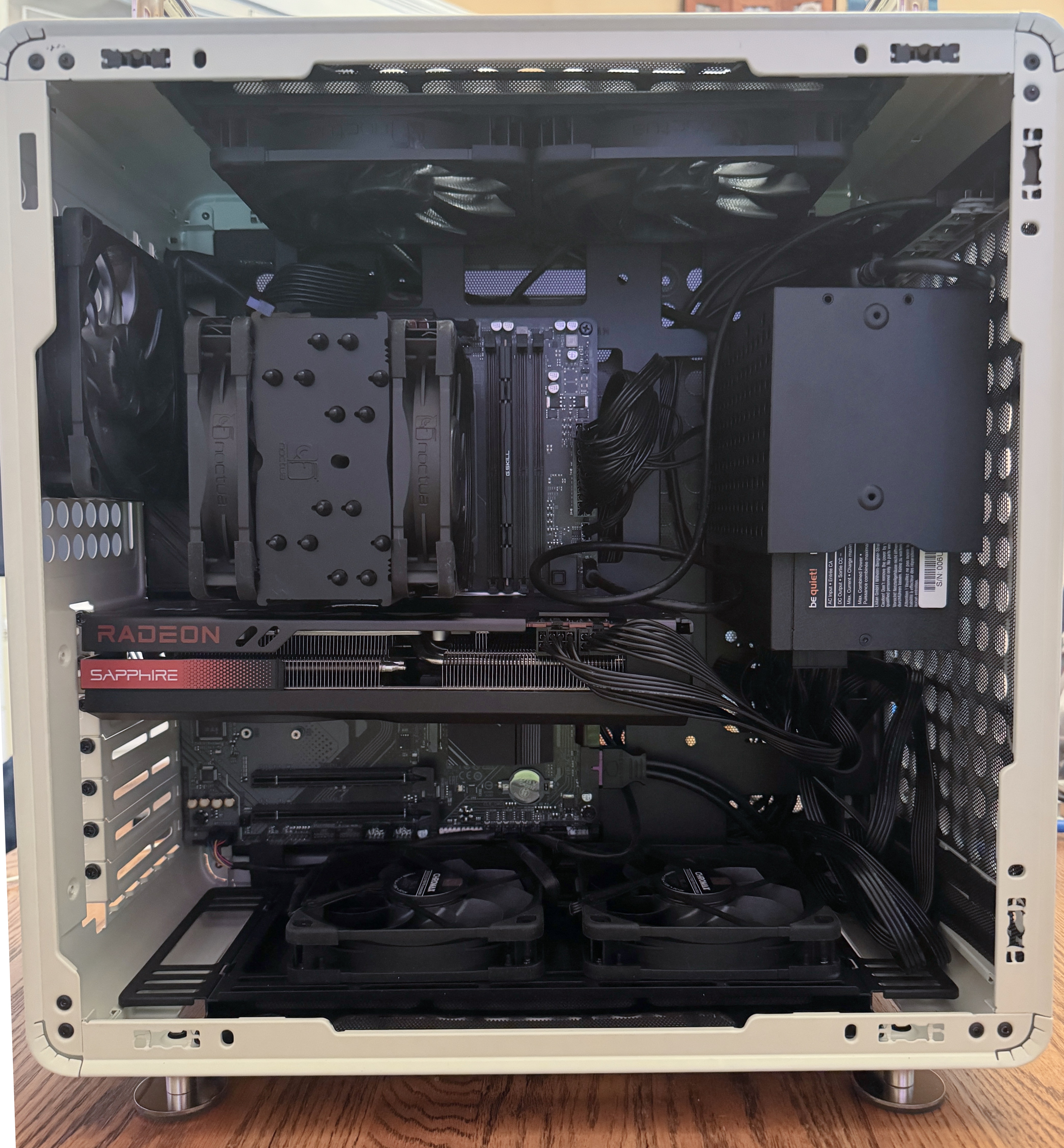

This is my first non mini-itx case in years and you would think working with a larger case and motherboard would be easier but not so. The back of the case was extra slim - somewhat of a surprise to me, cable management was one of the very first stepsI needed to do in this build not delay it till the end.
PSU the be quiet power supply is a platium 80+ which is why I bought that over a seasonic or corsair gold 80+ (at the same price) but I'm somewhat unhappy with it - largely the cable which are non-brainded/sleeved and working with them was harder then I was expecting. I'm not sure if a different PSU would provide different results but I was unable to use a 3rd case fan at the bottom because that's where some of the cables sat. Also the back of the case lacked sufficient room for me to use cable extensions for a cleaner look.
The Noctua NH-U12A is smaller then the massive NH-D15 which I've used in the past and was overkill for my usage. Also that larger cooler blocks access to the ram slots and the CPU power headers in the top left corner of the motherboard - Now with a smaller cooler I have access to both.

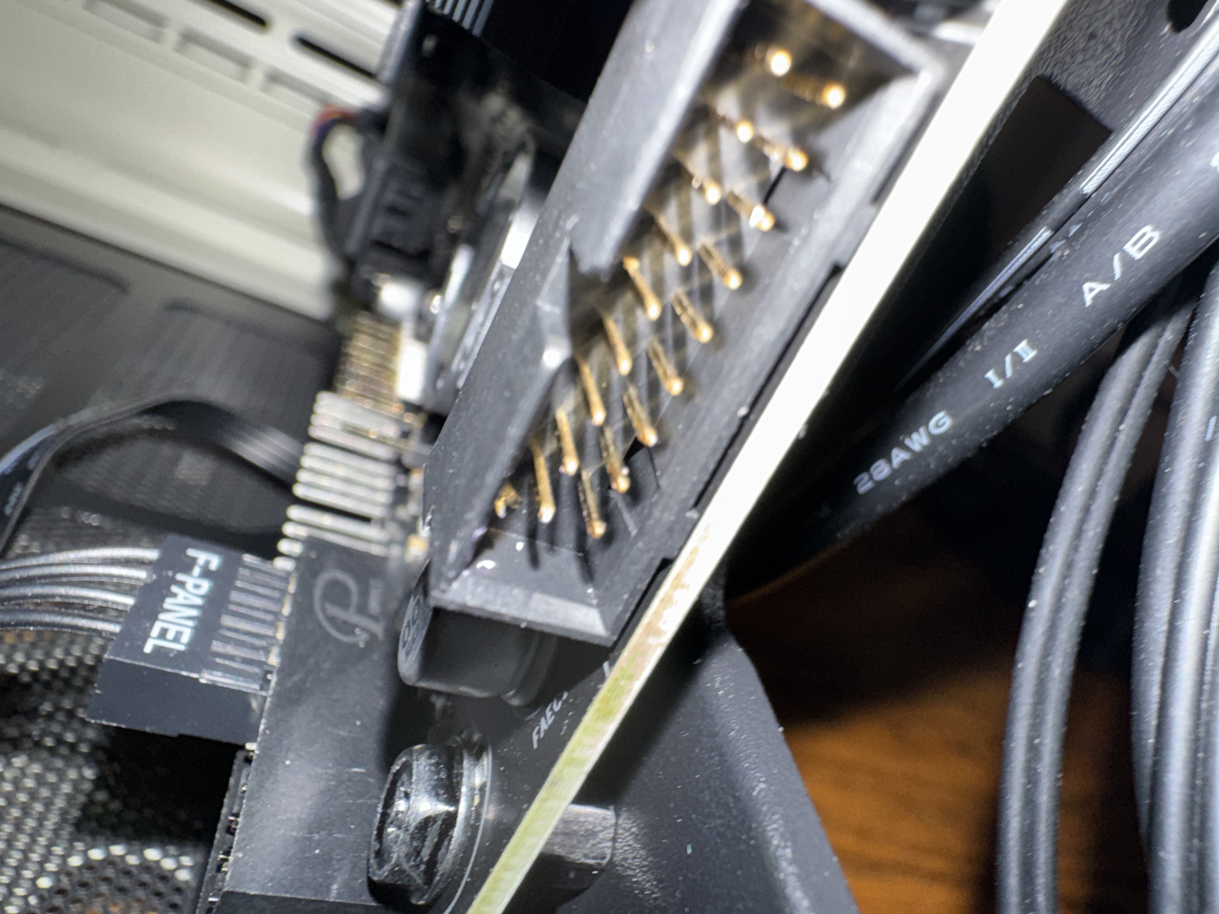

I struggled with USB headers as I always seem too, I again bent the pins in the USB 3 header, luckily it was pin 10 which is not used and with a bit of work I was able to straighten the pin enough to insert the connector
The USB-C header was also a pain, the cable just didn't want to go in and stay in, I later learned it "clicks" in. Maybe because I was running the PC for a while, and things warmed up, but when I re-tried adding it back in, the bad boy finally clicked in and now my front panel as USB-C and the regular USB connectivity.
Overall the build was headache free except for the above issues, and I didn't rush the build, taking over the course of a couple of days, spending a few hours each day to slowly add each component.

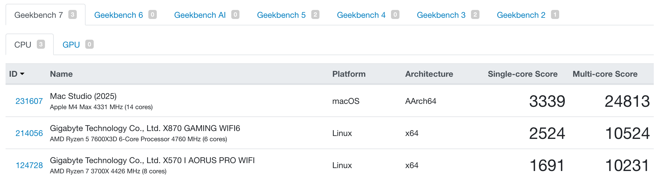

The Geekbench performance is a little surprising, single core is quite a bit more then my 3700X, but the multi-core is not so much, at least until you realize the 7600X3D has 2 less cores then the 3700X, so I think overall its mult-core performance is impressive - that's my story and I'm sticking to it 🙂

A lot of Windows PCs are aimed around 8K - 12K for multicore these days. It is easy to find CPUs with far higher scores, but, as far as what a typical consumer needs, around 10K is the sweet spot. Mac users may be spoiled by much higher numbers but I think that the vast majority can't really use that higher performance.
My Windows desktop is 8,846 but it could handle all of my trading if I needed it to and it handles some media processing too. This is part of the reason why Microcenter sells so much older hardware. I just heard that nVidia is bringing back the RTX 3060 because they can get process space on the older node: https://videocardz.com/newz/nvidia-rumored-to-bring-geforce-rtx-3060-production-back-this-quarter
Ii updated Post #3 to include my Studio's Geekbench 7 results and the results are telling - my M4 Studio is a beast of a computer.
