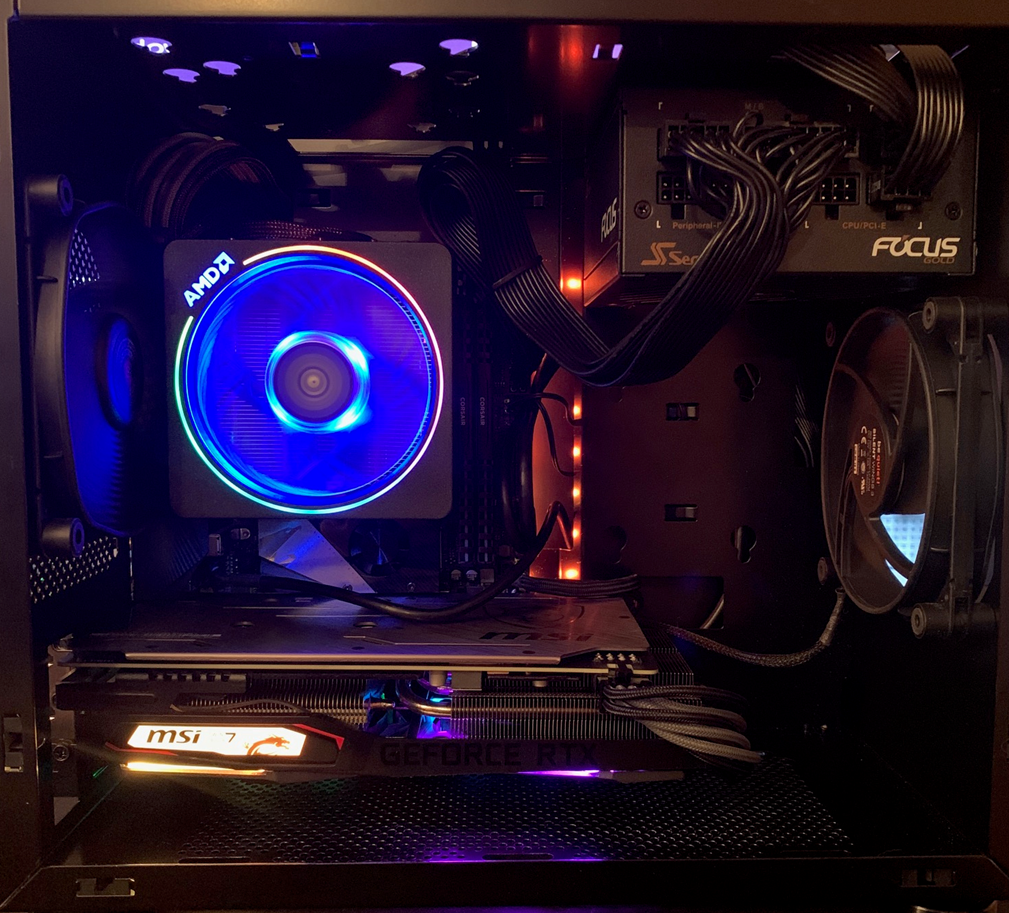

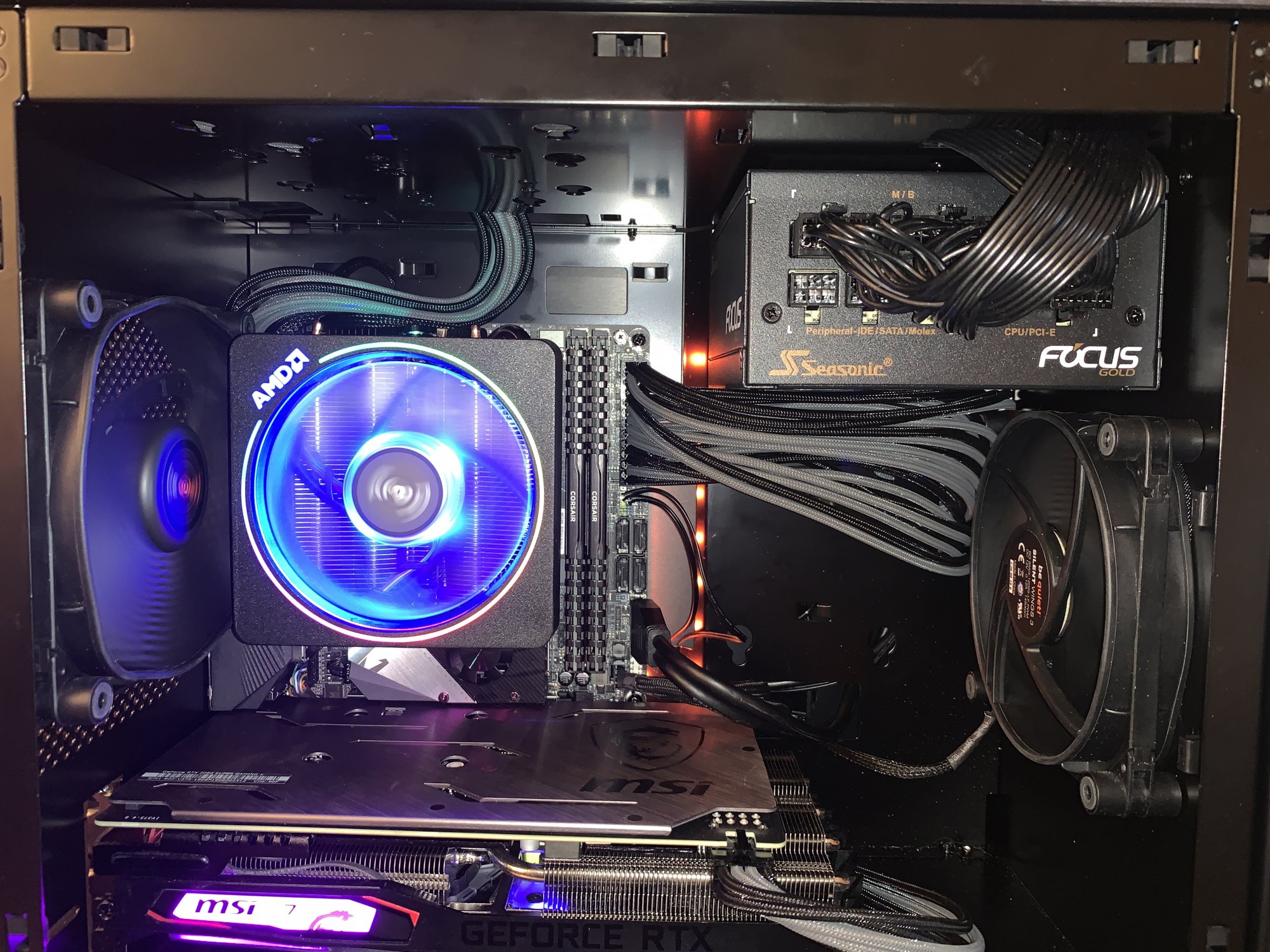

Anyways, here's the semi-finished result. I'm not entirely happy with my cabling efforts, particularly the motherboard power cable, I'm thinking, of re-routing the motherboard cable to the back using the extension cable, but the back of the case is really tight right now. I suppose it will be a project for another weekend. The audio cable is bugging me as well, you can see that running parallel to the GPU. I may try to move that under the GPU, or I'll just cut it, as I really don't have much use for it.
I picked up a Gigabyte ITX X570 motherboard, which was the best motherboard they had. For the CPU, I opted for a 3700x, mostly, since I was dealing with such a headache, let me bump up to the next tier processor. Plus the supplied cooler on the 3700x seems to be more robust cooler then the 3600x. I opted for the supplied cooler over the Noctua - If temps are decent I'll stick with it. Between the GPU, and motherboard and cooler, I'm seeing more LED bling then I prefer, its not rainbow puke level but its there.
After putting everything back together, and saying lots of prayers, the system booted up into the BIOS. I'm at a point where I'll see if there's any updates for the BIOS and then load windows.

Looks fine to me. That cable is the only thing that sticks out but I don't really see what you could do with it to make it any neater.
I have to do some work on my system to make the cabling neater. The thing has been up and running since I built it outside of Windows updates so it would be strange to take it down. Maybe tonight.
Definitely interested in the temps with the stock cooler, I have heard AMD do their coolers pretty well.
Agreed, while I do like the look of the Noctua and even DRP4, the Noctua was a royal pain to work with in such tight confines. Another benefit is the cooler had the thermal paste pre-applied - a nice benefit.

I like the LED bling. It's perfectly understated.
Use extension cables and route up into the top and down the back. Use cable (zip) ties to anchor the big cables to the chasis.
I largely was doing that, the only exception was the motherboard power cable.
Temps will be find on the stock cooler, but noise.. it won't come close to the big boys.
I think the build looks good! It looks like you could ziptie the 24 pin up above and out of sight. I know the TU150 has a blacked out portion of the TG. Usually the HD Audio/Bottom Left connect has enough length you can run between the slot and the port end of the graphics card and down across the bottom.
The Wraith Prism is far beefier than the Stealth that comes with the R5s. I bet your cooling is fine. Noise will depend on your subjective tolerances. My Stealth has a rather obnoxious tone and a bearing rattle at it's 'idle' state. NZXT H1s are back on sale so might make the switch to that or go and pick up an M22 on the way home from work.

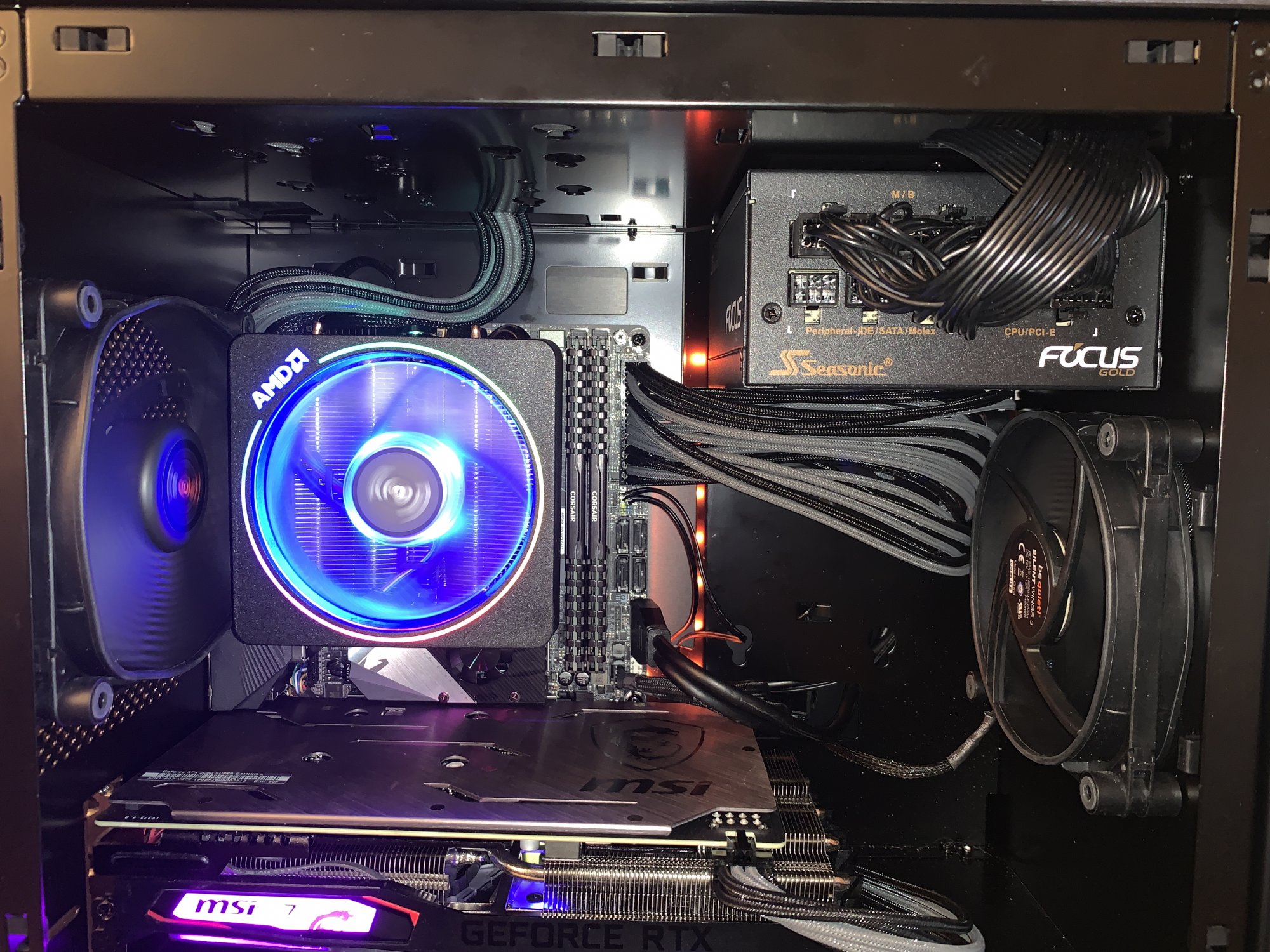

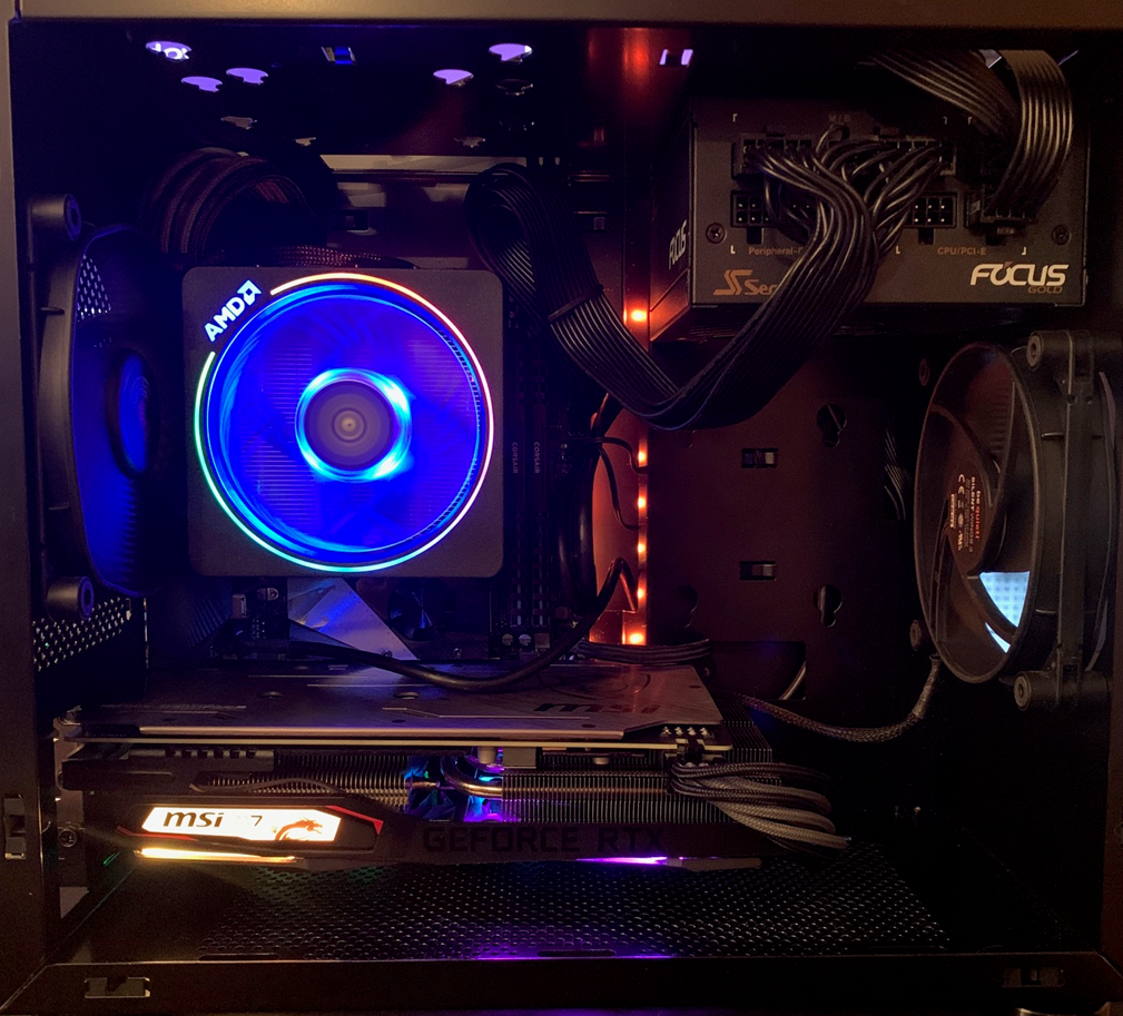

The cabling was annoying me so I redid the wiring at lunch hour. I'm now using the extension cable for the motherboard and I cleaned up the audio cable as well

I'm playing with the fan profile, what bugs me is the speeding up and slowing down. I'll probably increase the case fans but slow down the cpu or try to minimize the ramping up. Ultimately I'll be replacing the stock cooler for the Noctua but for now, I'll live with it :)

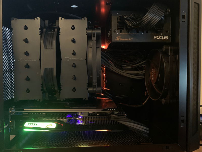

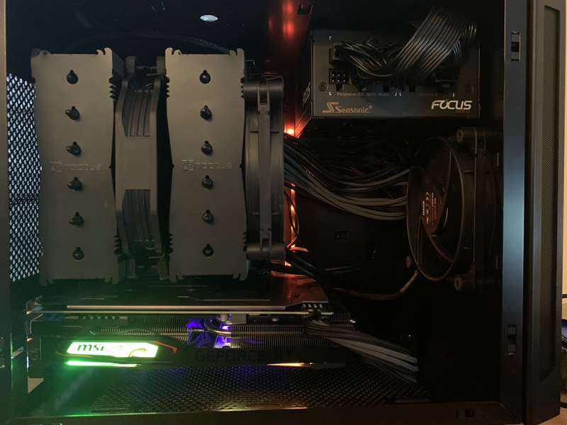

I pulled the stock cooler over my lunch hour and put in the Noctua. I already knew this, but yet I probably need to re-learn this. Every board is different. The MSI motherboard that I had, could easily accommodate the cooler, and I was able to squeeze in a fan in the rear.
The Gigabyte motherboard, is different enough that I wasn't able to get a fan in the rear, and the motherboard power cable was impacting the Noctua 140mm fan. I lifted the fan up highter but then putting the glass side was problematic. Instead of forcing it (I learned in life, never force anything ;) ), I put the 120mm fan that was originally going to go in the back. Its fits nicely and I'm really happy with the result.
Temps are certainly cooler with this bad boy, Idle, I'm seeing temps about 35 - 40c and underload about 67c while doing an Aida64 stress test. The fans do ramp up, and I can hear them, but its much better over the supplied cooler. There's much less ramping up and down as well.
For comparison sake, when I had the stock cooler, Idle temps were about 40 to 50c, and underload high 70s (about 77 to 78c)

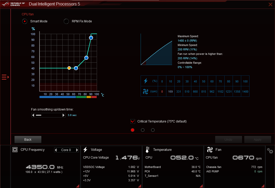

You need a flat fan curve up to about 60c, with a delay, or smoothing to stop fans ramping.
Here’s what my fan curve looked like in the Asus.
Ryzen likes to bounce about between 50 and 60c on the desktop so you need to essentially ignore anything that isn’t over 60 for an sustained period. You don’t want the fan responding to all the blips which is what the smoothing does.

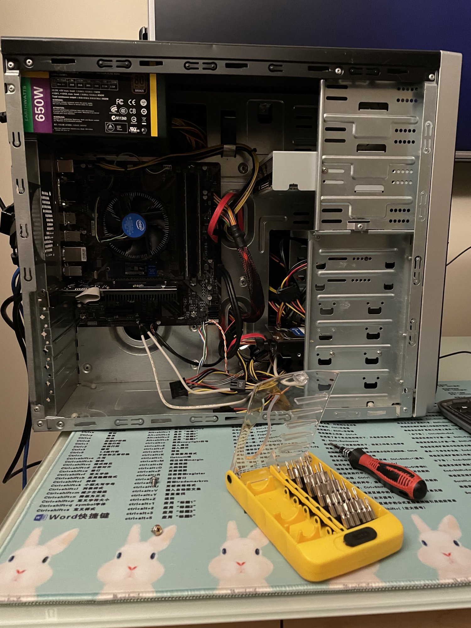

Everybody here has some bad ass build. But I am just going to throw some crappy little build of mine, done today.
I was digging my old house, which tenant was moved out. I found out this old case with old components, which is AMD Sempron 2800+, 512MB DDR 1 memory, 100GB HDD and ATi Graphic card..
This was my first computer I build during my high school. I was working at McDonald's back then, and I was buying component by component each pay check. It took me while over 3 months to get all hardware together. It was not a powerful build back then, well you know how high schooler's budget. They funny things is that during early 2004's, AMD's Athlon64 was kicking Intel Pentium 4's ass where AMD Sempron was kicking Intel Celeron's ass. Who knew, 15 years later, AMD's is again kicking Intel's ass with it own Ryzen processor.
