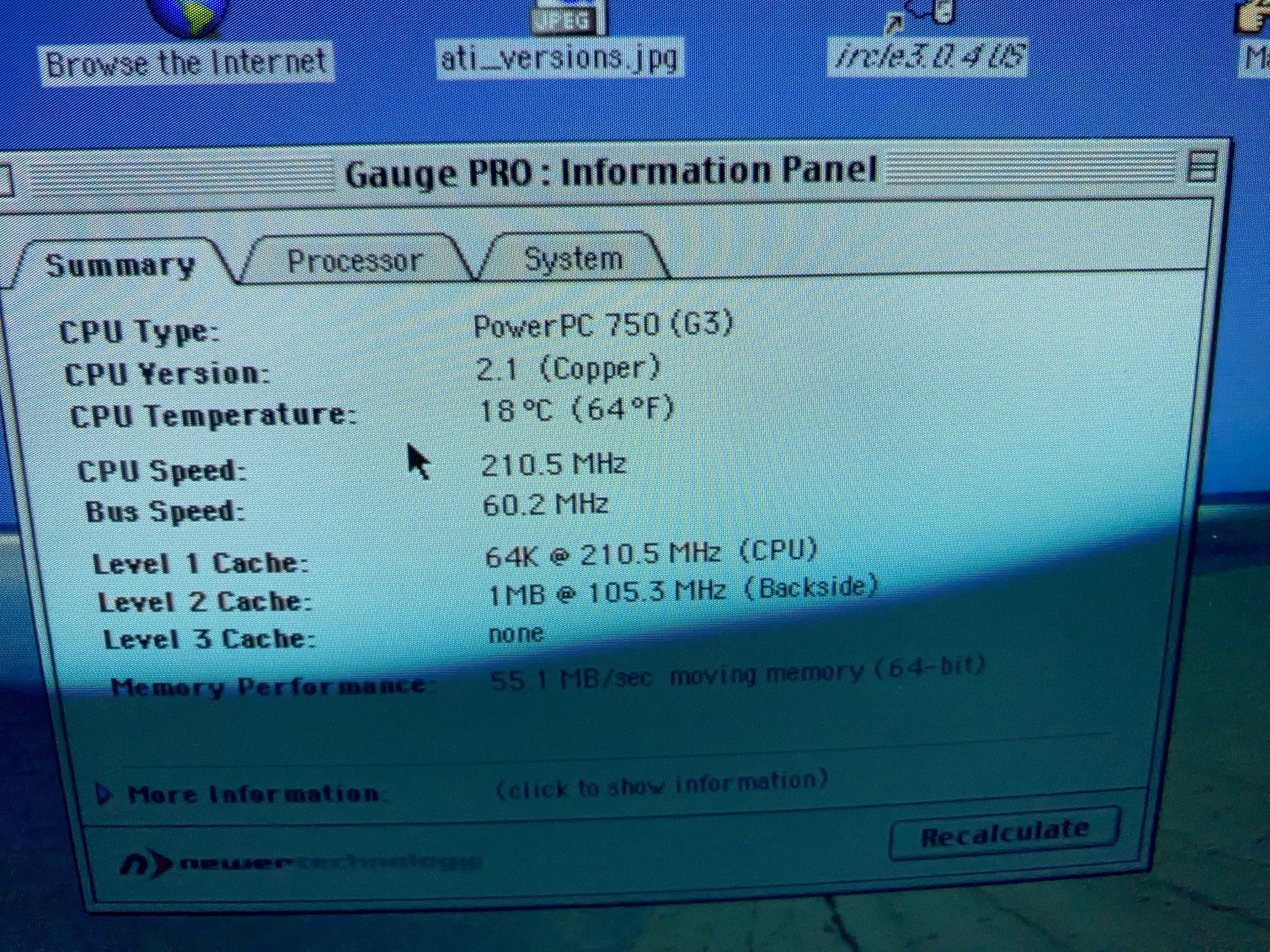

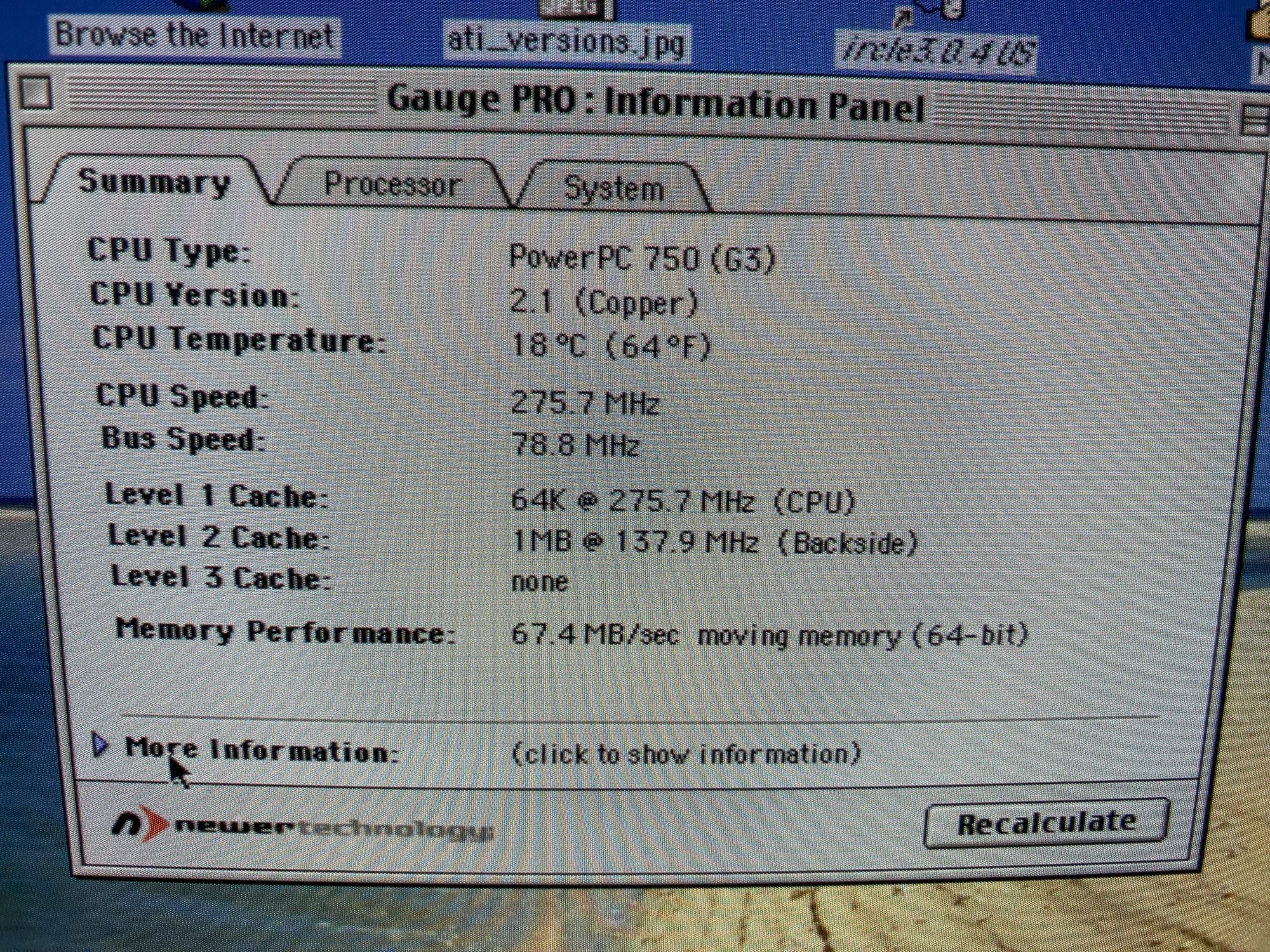

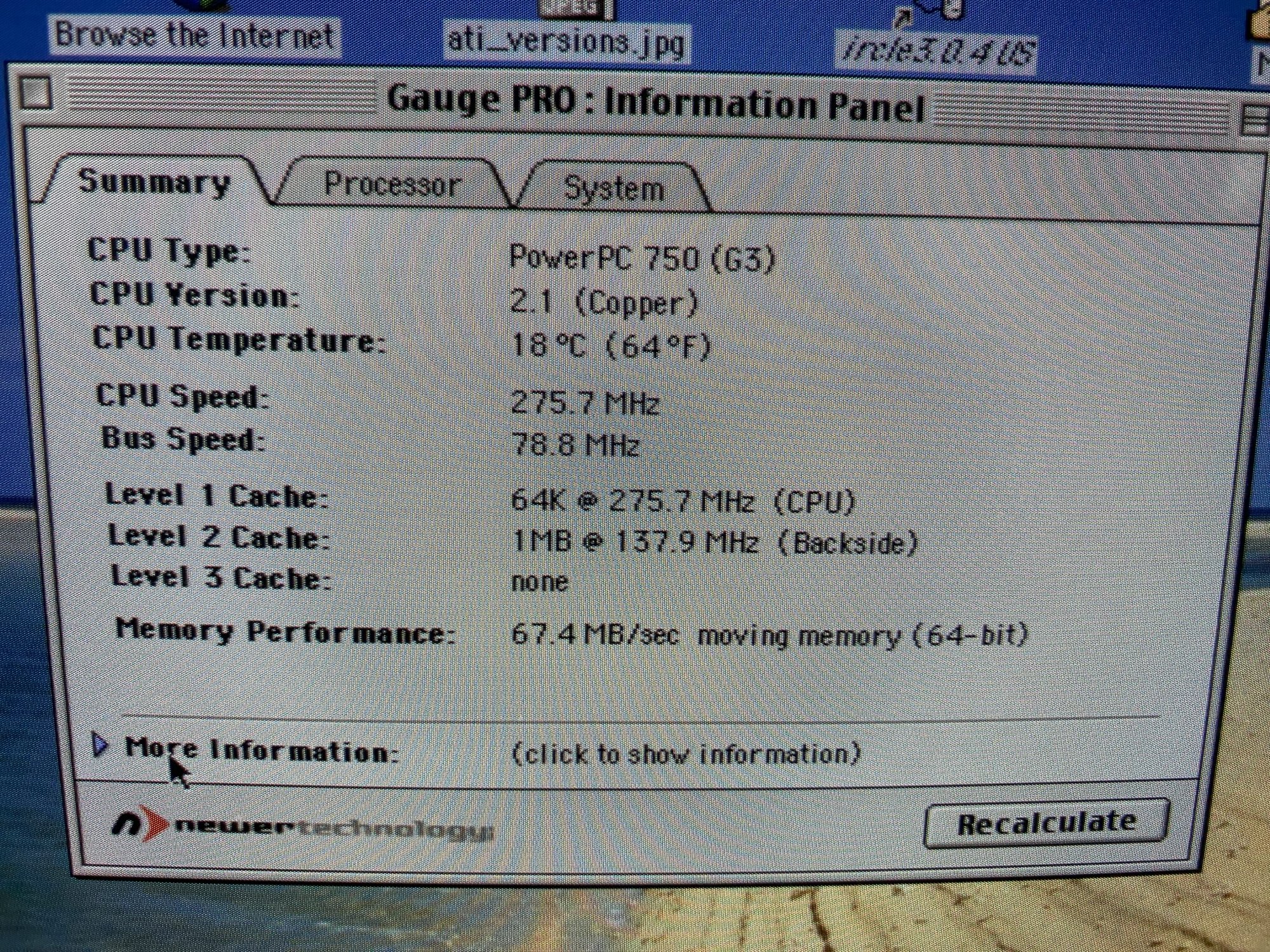

I was tinkering a bit with the Beige jumper block today, and found a couple of new bus speeds that haven't previously been documented. This is assuming that Gauge Pro isn't lying – but it reports the known bus speeds of 66.8, 83.3, 75Mhz correctly, and I verified everything with Tattletech.
Bus SpeedPin 5Pin 6Pin 7Pin 8Pin 9
60.2 MHzSxxSx
60.2 MHzSSxSx
78.8 MHzxSSxS
78.8 MHzxxSxS
S=set, x=not set
60.2MHz must be using a 30MHz PCI bus and a 2x multiplier, and 78.8MHz a 31.5MHz PCI bus and a 2.5x multplier.
As regards pin 5 and 6, it seems like both Sx and SS set a 2x multiplier and both xS or xx set a 2.5x multiplier. My theory is that pin 6 is not connected/redundant.
What's weird is that according to the diagram here a 60MHz bus speed i.e. (30*2) should be set by configuring the last 5 pins as SSSSx, but no, instead it's done like I've shown above. So there is some weirdness with this jumper block – or the website has misinterpreted how it works.

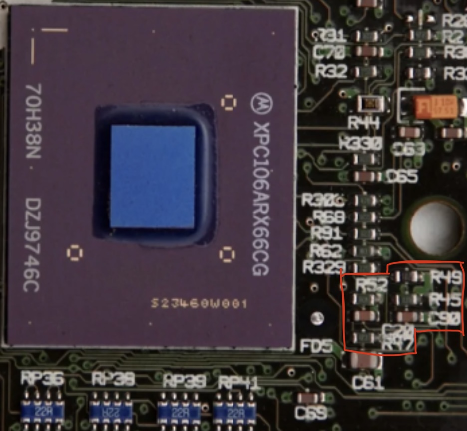

By the way, there is a chip visible in your first photo of the XPC106 labelled SC608AAB. Here's a datasheet, it's a 'PowerPC 603/604 motherboard clock generator'. I'm sure it's relevant.

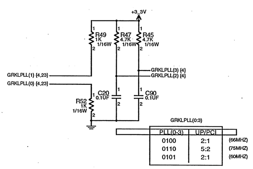

I think the Cypress CY2271A pull those missing two pins depending on the logic of the EEPROM it's connected to, but I could be wrong and they are pulled( programed ) by resister logic.
@joevt found the missing data to set the extra pins on the B&W/Yikes and there is a resister that can be removed to unlock 133Mhz Bus operation.
If we had a scope we could likely figure out what needs to be done for the Beige to unlock 100MHz bus operation. Sadly I lost my scopes in a fire many years ago, and really saw no reason to replace them.
It should be simple to work out. Desolder the XPC106 and then beep out where the relevant pads on the BGA footprint go to.
I will do this if/when I upgrade to an XPC106ARX100, but I haven't done any BGA rework yet.

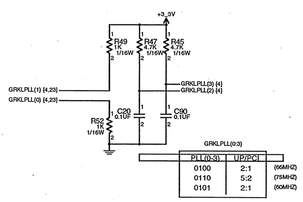

This is a screenshot from the relevant page of the Gossamer DVT schematics, looks like we have our answer?
hah I see you got the schematics that I was sent and forwarded onwards to my good friend who obviously forward them on to you :) indeed it looks like I was bang on the money about the last 2 PLL pairs
sadly im not currently in a position to mess with things, but its very promising :)
(also Be warned the 100Mhz MPC106/XPC106's on UTSource are fake, I mean they are real 106's but remarked, slower ones that cant clock to 100Mhz)
So you are able ti identify the correct setting for 100MHz?
It’s 1000, according to the MPC106 datasheet posted earlier. Remove R52 and R49, giving access to GRKLPLL0 and 1 which should be pulled high and low, respectively. Pins 5 and 6 should be set on the jumper block, which will pull PLL2 and PLL3 low. Super easy to do.
