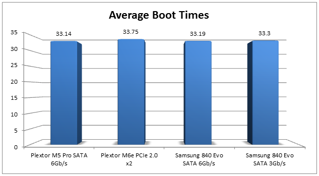

As you can see from the above chart. All SSD require virtually the same time to boot, regardless if it's PCIe, SATA II, SATA III or different model.
There is a big difference in their sequential performance. However, as I said earlier, for OS, it's the matter of low latency, but not high sequential speed. And almost all SSD that can boot form cMP at this moment have roughly the same 4k random read speed. Another good example is RAID 0 improve max sequential speed a lot, but zero help on 4k random read performance. That's why no matter how many HDD you RAID them together, the boot time still slow on HDD.
