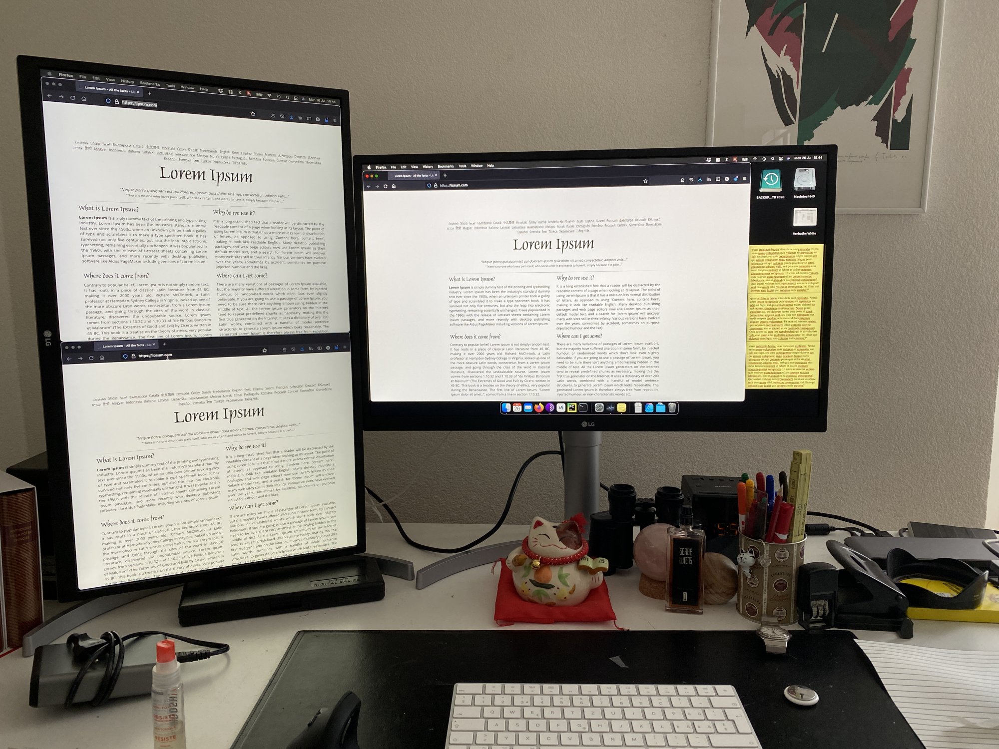

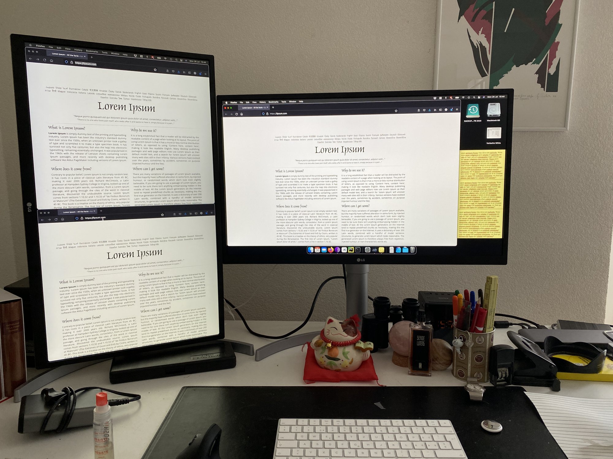

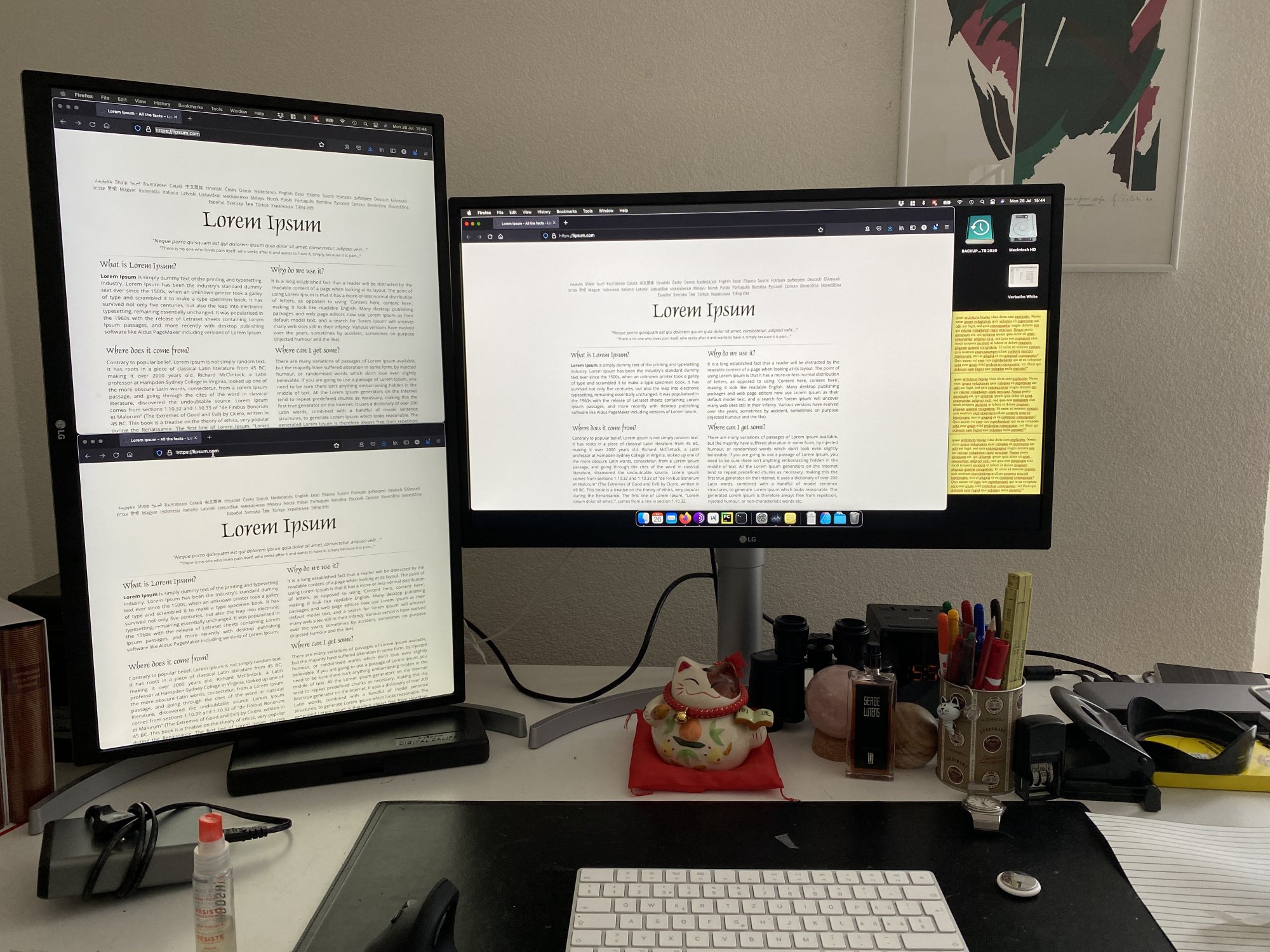

I have been using two LG 27UL550-W that I could see myself using for a lifetime (so long the input methods don't get deprecated too quickly) I can't inform you on the specifics of the different models and their differences but I found the ability to rotate and height adjust essential (my desk not being suited for clamp type arms).
my two cents are: If you can afford 4k, go for it, you will never regret it. As for higher resolutions, the market has not really matured enough to make these panels affordable and the returns are slowing down bigtime (considering you may end up paying 2x to 10x {that sweet pro display XDR})
I have been using two LG 27UL550-W that I could see myself using for a lifetime (...)
I see you're also a fan of that greatest of novels, Lorem Ipsum 😁🤣
