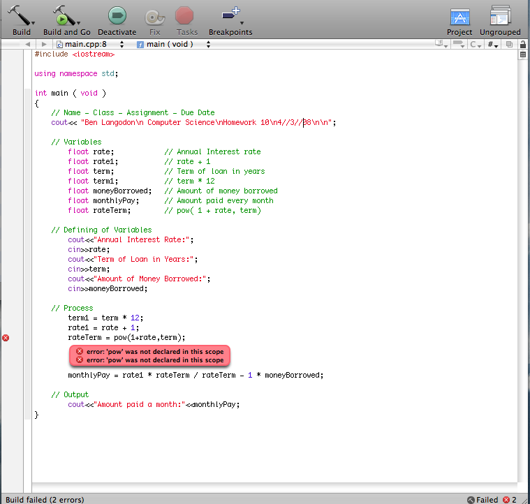

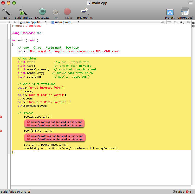

pow(1+rate,term);
Your variables should be of type double, or you'll need to cast them like so.
pow(1+(double)rate,(double)term);
pow() returns a double, also.
That simple. When in doubt, try consulting the documentation.
my teacher just told us about it and didn't give any paper on it.
thanks.
i have never used double but will give it a try.
when i declare the variables should i use float or...

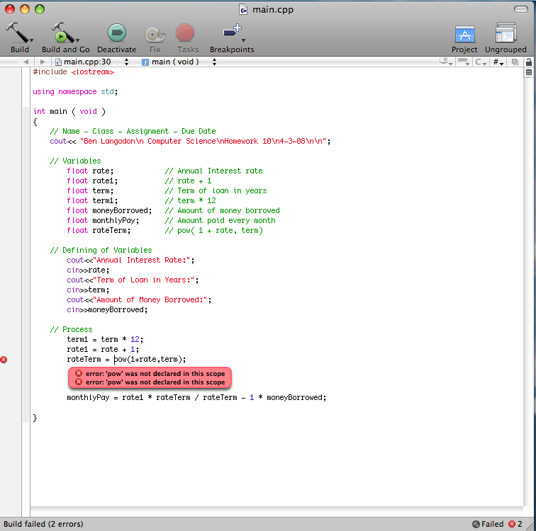

it only works if it goes pow(x,y) not pow(1+x,y)
I'm surprised your professor told you to use pow() and didn't mention including math.h or anything about how to use it.
You need to add "#include <math.h>" after your "#include <iostream>" statement.

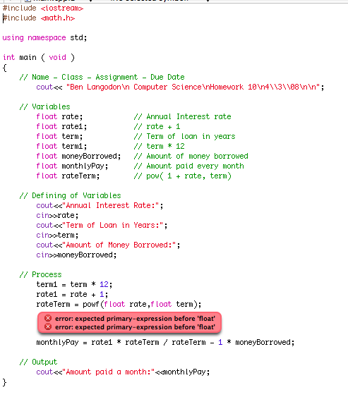

the bold is what i changed, i tried it all on one line also
like this, i just took this code from your post, [the code and /code]

Why are you declaring rate and term twice, or at least trying to? Delete the two float words in the powf() function.

That's not he was referring to.
This line: rateTerm = powf(float rate, float term);
Should be: rateTerm = powf(rate, term);
... because you are declaring the 'rate' and 'term' variables twice, not to mention that declaration in that form wouldn't work even if they weren't already declared previously. But it looks like you already figured that out.

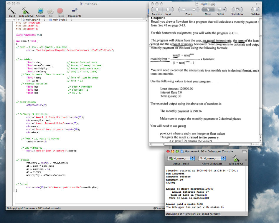

well i tried to tweak the processes area from having all as one problem to parts of the problem
it still didn't work
on the left is my work,
right top is the assignment,
right bottom is the compiled program as it ran
the values we are supposed to use are
money borrowed (moneyBorrowed) : 120,000
interest rate (rate) : 7
term in years : 30
and the answer is supposed to be 798.36
i will rewrite the processes part without the variables and post that if anyone wants it like that

Try figuring out where the calculations are going wrong, put a line that prints out the variable after each calculation so you can figure out where the problem is.
Your powf() function is still wrong. You need to keep an eye on the types you are using, or at least cast if you want to treat them as a different type.
His powf() isn't wrong as far as I see, he's using floats for everything.
EDIT: Nevermind, I missed the int declaration. benlangdon - Why exactly are you using int for term1?
EDIT2: Are you sure 798.36 is the correct result? Doing the calculation on my TI-89 resulted in 8400 which is also what I get upon compiling and running your code. By the way - if you're going to input the monthly rate as a percentage as the assignment says, then you're going to need to convert it to a decimal value first. (1 + rate) is not supposed to be (1 + 7), its supposed to be (1 + 0.07). You corrected this by inputting .07 as your input in Xcode, but technically that's not correct as the assignment says to do it.
