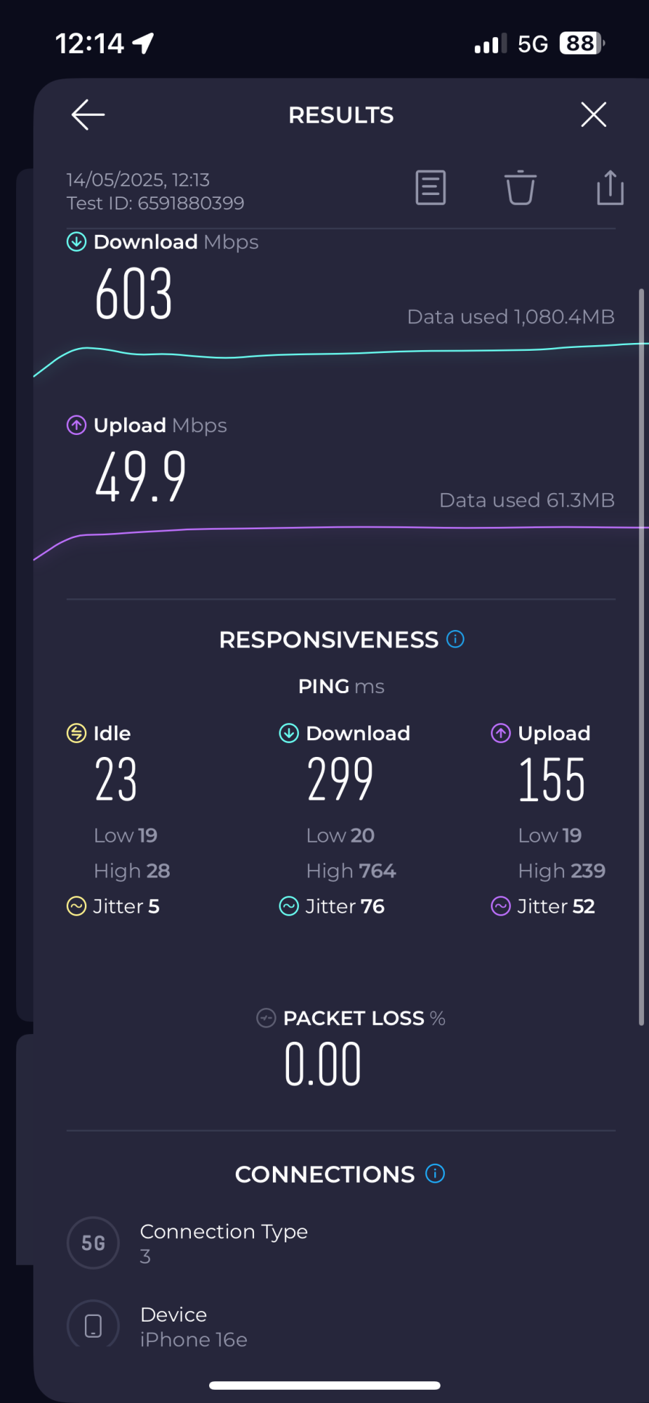

Seeing much better results today:

Also, I’ve realised doing just the basic speed test via Ookla etc means f*** all. It’s not the most accurate way of testing that’s for sure.
As you can see my last speed test was ok on the 16e. However a real life test was actually downloading a large file and the results were decisive. 16e is 3-4 times slower than my 14 Pro. Did multiple files etc. Not good enough for my user case. That’s why I decided to return the phone.
