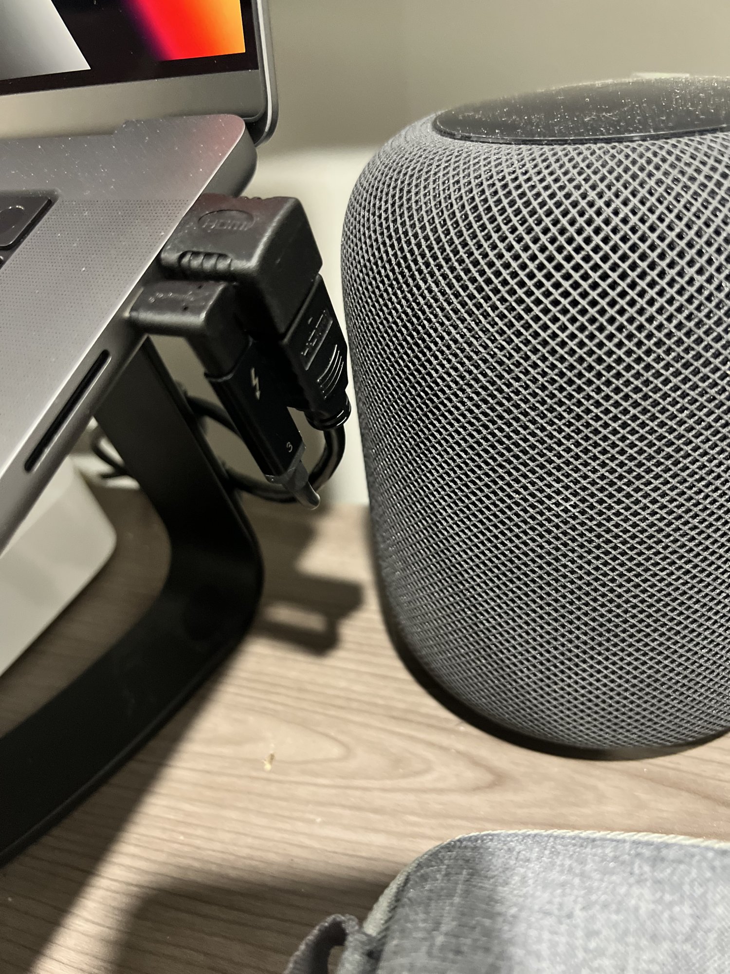

Third display hooked up with hdmi. Easy to connect two cables. I also got 90 degree adapters to prevent unnecessary strain on the cables.
