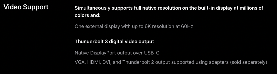

Does anyone know if Caldigit TS3+ with M1 Pro / Max have any issues with dual monitors using the doc with 1 thunderbolt cable?
I just got a macbook air M1 Mac and was disappointed that dual monitors did not work with my TS3+ and Caldigit said it was the chip's fault but M1 Pro / Max do work with the TS3+. That's what they said but not sure if there are any issues with this setup or not.
Thanks,
-- Jorge
[Edit: realised that this is an old thread, so probably too late for the OP, but leaving here for the benefit of others with the same question ]
The MacBook Air only supports a single monitor (plus internal display), irrespective of how you connect it, unless you are using a DisplayLink dock (that provides a kind of GPU software "simulation" via USB).
This fact is well advertised by Apple so your disappointment was to be expected if you read the specs before buying:

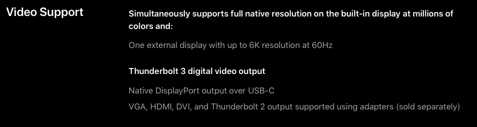

The disappointment comes from my expectation of owning several laptops. For the past 10 years or whatever it may be the Macbook had dual monitor support using thunderbolt 2/3 and now 4 and to all of a sudden to have thunderbolt but no dual monitor support is disappointing. Apple can give you 20-core CPU but no dual monitor support using one cable? Anyways, I got the MBA M1 for work and was testing it out to see if I could switch over. My logic was that it's Thunderbolt 3, something Apple developed and have full hardware and support control, so I am sure they can have dual monitor support but I was wrong. The sentiment from CalDigit was the same, which was that yeah its Apple's Fault this is not working. CalDigit has since updated their website and it's clear now but at the time they were trying to work with Apple on this but nothing came from it.
