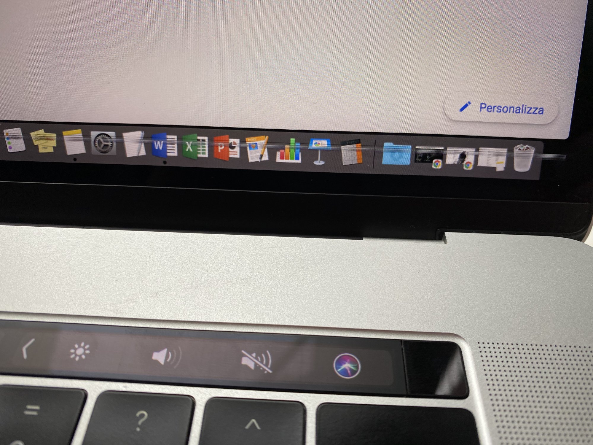

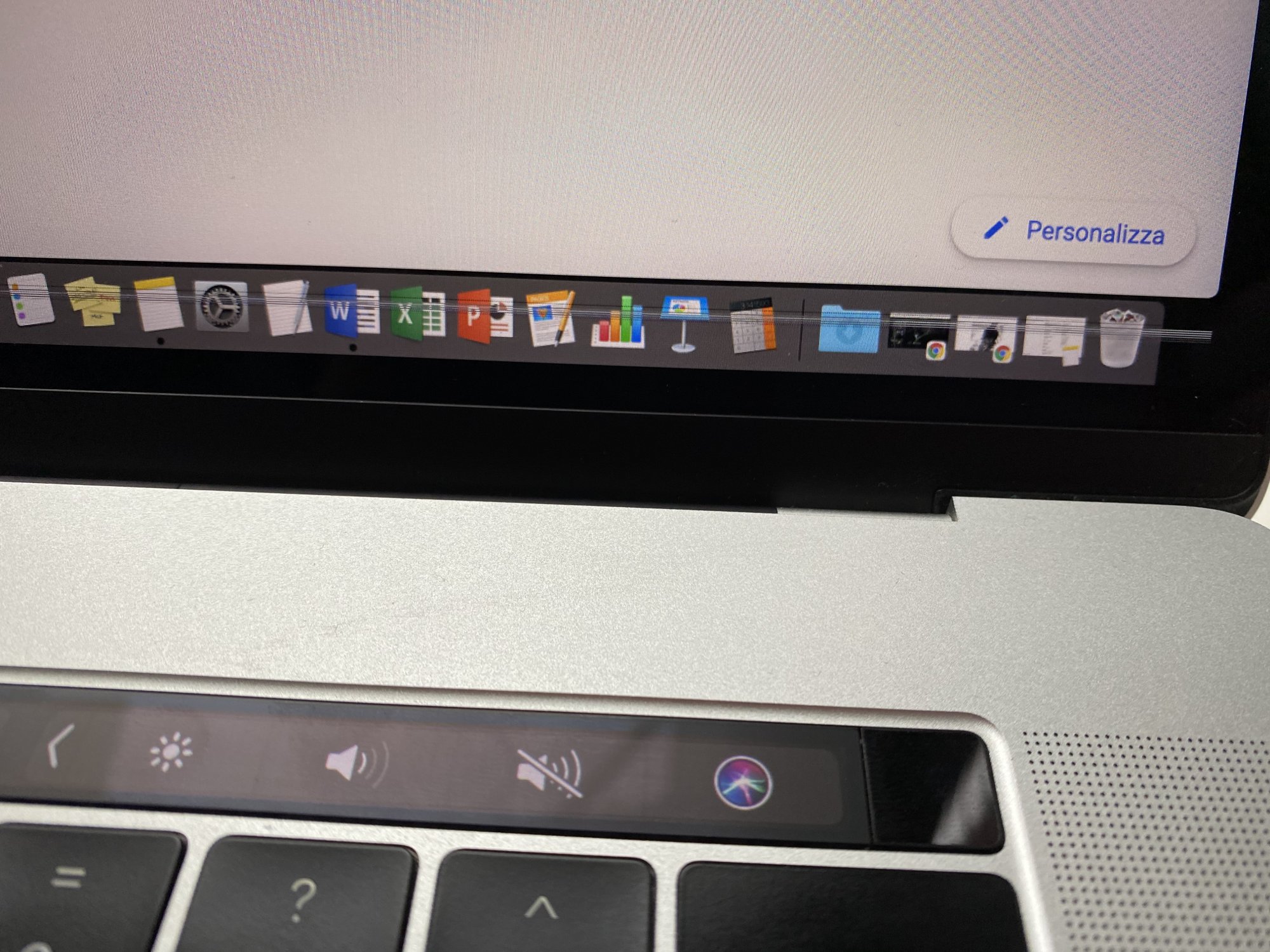

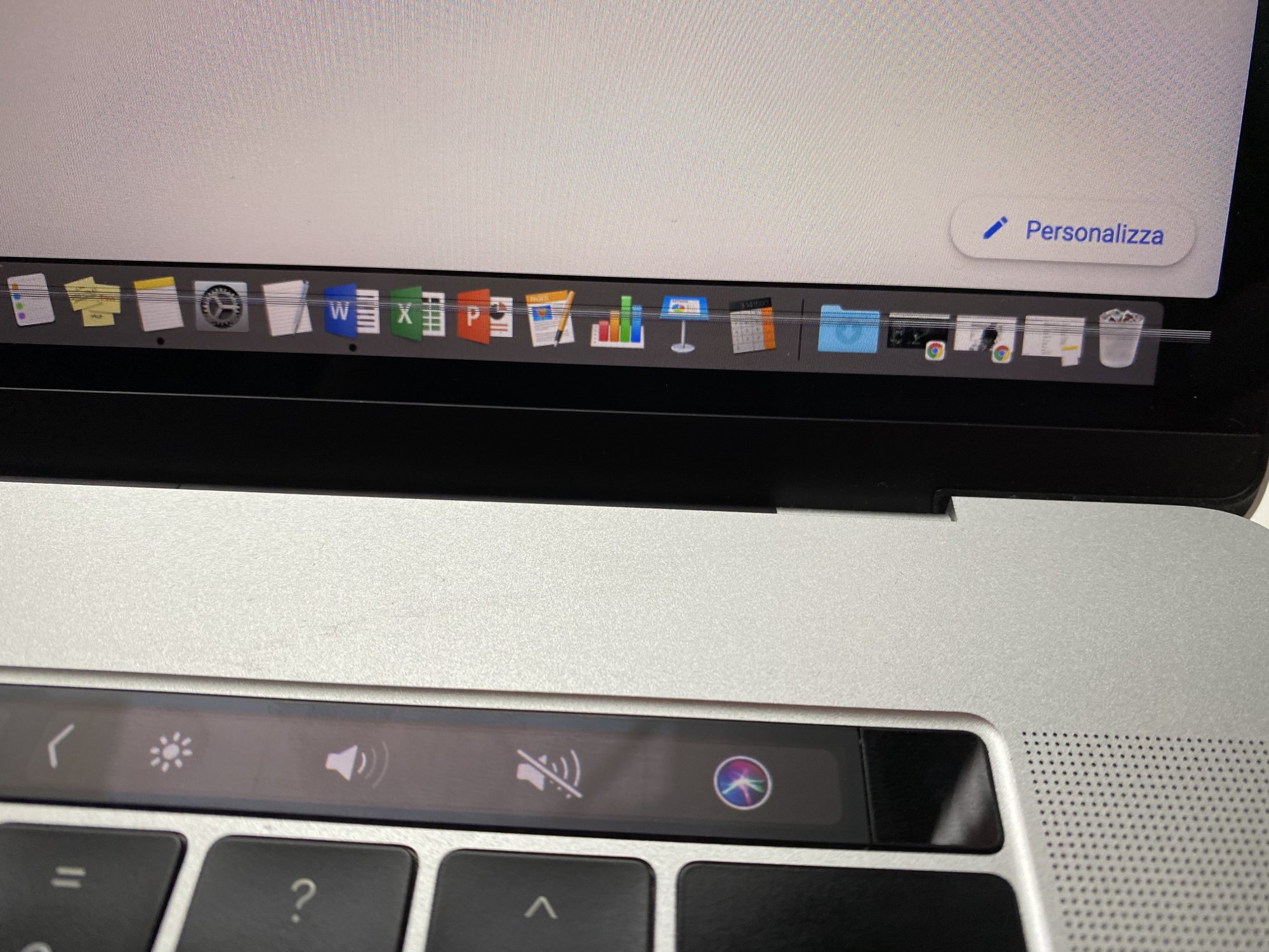

Hello Everyone,
I have a similar problem, I have a mac book pro retina 15 (bought in2018) now connected to the TS3 plus dock. The dock is then connected to the LG 5K screen. So with one cable, from the doc to the mac, I have everything connected.
the mac behavior has always been a bit “funny” since this set up. for instance after you disconnect from dock cable, in the monitor the applications doc would keep stay on i.e. if you are watching Netflix full screen you will see the dock. To fix that I had to go to system preferences move the dock either to the left or right on the screen and then back to bottom to have the applications dock working correctly again.
this morning the screen, just at the high of the applications doc at the bottom (image attached) started flickering.
i have spoken with Apple that said it is an hardware problem and to fix the issue the costs can be around £700. I find this crazy for a machine which has just 2 years and cost almost 3k. Of course on top the guarantee just run out last month after the 2 years passed.
i wanted to ask if you think this can be caused by the dock and the lg screen connected?
As well what do you suggest, I still have to finish to pay for the computer and I don’t want to spend £700. Especially now.
Do you think the flickering can get worst? Would you keep it like that since is not a big damage?
any suggestions are welcome, thank you in advance.
