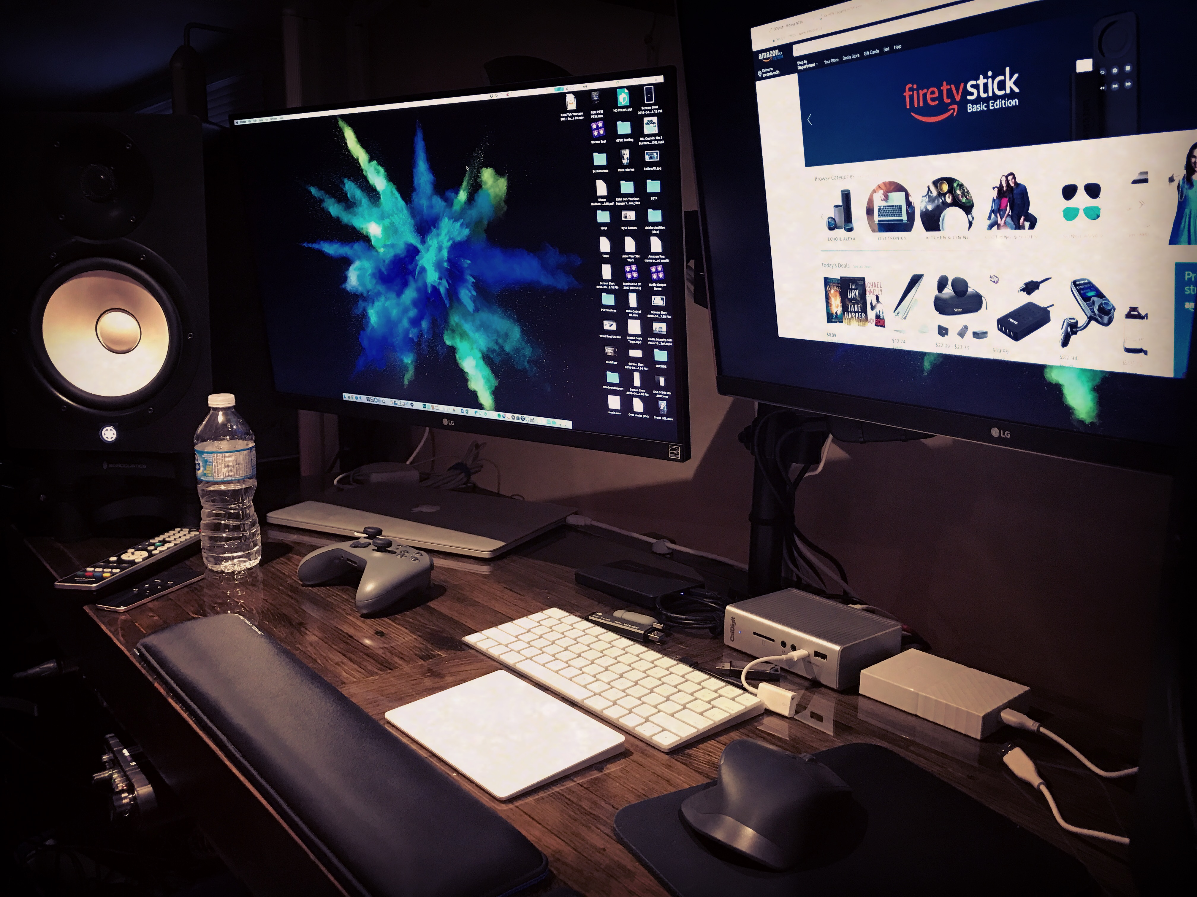

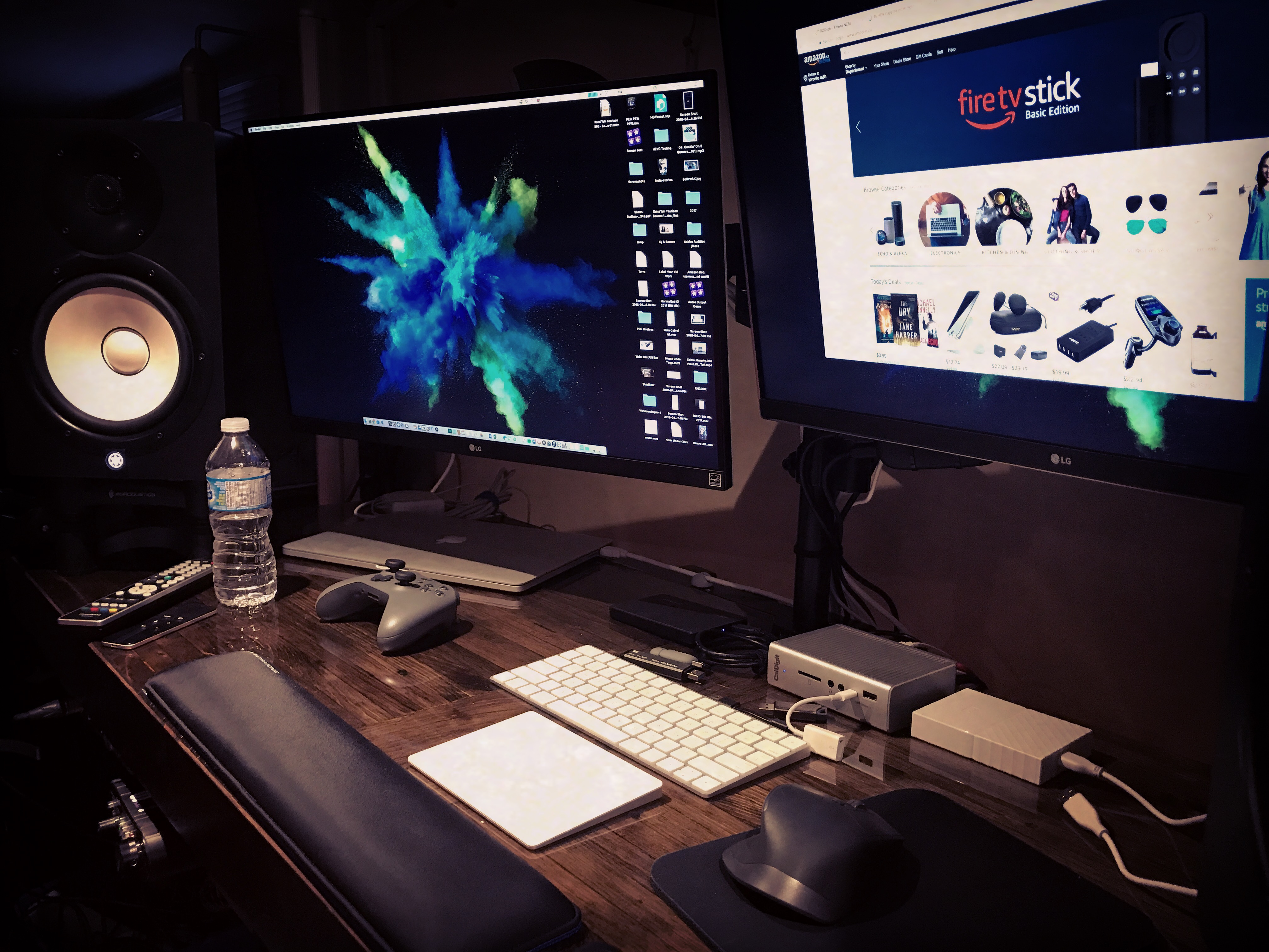

(Shameless post/reply hijack to show off the setup I just completed... sorry in advance!!)

Any DisplayPort to HDMI should be fine (although if you see DisplayPort to HDMI 2.0- grab that cable to be safe). I don't use those- I'm driving my LG 27UD88 with USB-C and my LG 27UK850 with DisplayPort and get 40k @ 60hz simultaneously just fine.

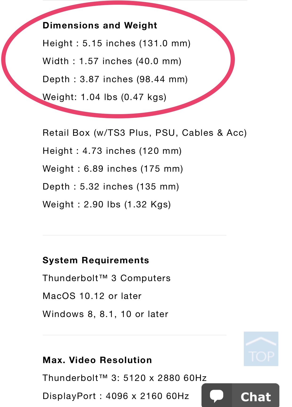

Here's the site:
http://www.caldigit.com/thunderbolt-3-dock/thunderbolt-station-3-plus/

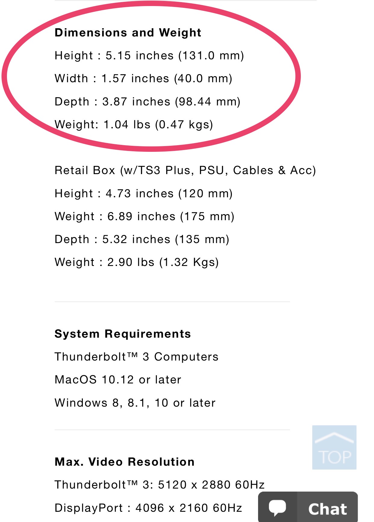

I know about these dimensions as I checked yesterday. I guess my question was not clear to you. What I wanted to ask is the recommended space between the TS3 plus (when put horizontally on a desk) and the monitor stand. I plan to put the TS3+ under the monitor stand. If the gap between the two is too close, the ventilation around the TS3 Plus might not be good and it might cause some heat issues.
When laying in a horizontal position, the vents are on the left side. The top (again, when in horizontal position) is just a series of heat sinc fins. No air comes out from there. There are no holes on the top of it. (If you decide to go with a vertical setup, the heat then escapes through the top above the Caldigit logo).
You don't want to put items on top of it, but you can probably (and I stress probably) place your display fairly close to it. (Again, in a horizontal configuration).

So upon looking at it closer, there are no vents on it. The entire thing is a giant heat sinc that just dissipates heat. If the monitor is thin enough, it shouldn't pose a problem. But under no circumstance do you want to put anything on top of it, it will heat up and possibly damage items that are on top of it during heavy I/O workloads (massive file transfers, and whenever you use those pesky questionable USB flash drives that get really hot).
