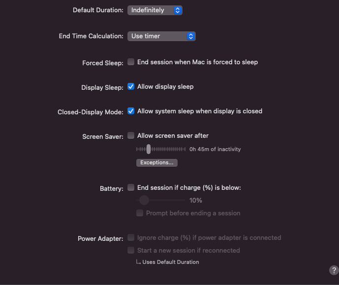

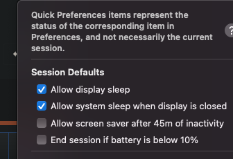

Installing and using Amphetamine seems to have permanently fixed the issue for me.
I checked "Allow display sleep" and "Allow system sleep when display is closed", i made Amphetamine launch at boot and activate a session immediately.
"Session default" tabs
My setting in "Quick prefs" :
To fix the need to login again when amphetamine launch (black screen), in "Security & Confidentialy" I changed "Ask for password" from "Instantly" to "5 seconds".
I also installed the two helpers in Amphetamine Enhancer.
If I understand it correctly, my config just doesn't change anything to my mac's sleep. But if I close amphetamine, CalDigit's TS3+ stop wroking correctly instantly, so that's how I do it for now.

Mebo
macrumors newbie
Dec 25, 2021
2
1
But wouldn't this config mean that MacBook is running 24 hours and never going to sleep?!
Starmina
macrumors member
Jul 7, 2020
46
14
Well, my mac is always in clamshell mode and display seems to shut off / wake up just fine.
But you raise a good question if anyone can clarify that

Could you try my Amphetamine solution just to see if it may work for you ?
I'd like to get some feedback about it, and also if the workaround actually really disable my mac's sleep or not (it does seem to sleep just fine with my Amphetamine configuration but who knows).
I know it may seems counter intuitive to use Amphetamine ¯\_(ツ)_/¯

Could you try my Amphetamine solution just to see if it may work for you?
I just tried it and Amphetamine does fix the problem of monitors not waking up after the monitors are put to sleep. I did not install Amphetamine Enhancer since the features it adds do not appear to be necessary for my use case (I don't use it with the lid closed and don't need additional triggers). The only config change I made after install was to check "Allow display sleep". So that's great news.
Unfortunately, it seems that this comes at the cost of the system not sleeping. Yes, the monitors go into power save ("sleep") mode, but the CPU does not sleep. That might be worthwhile for some people so I think it's still a good work around.
Ok thanks for the information.
Wasn't 100% sure about the sleep, as i don't know how to check if CPU is sleeping, while monitors are off.
