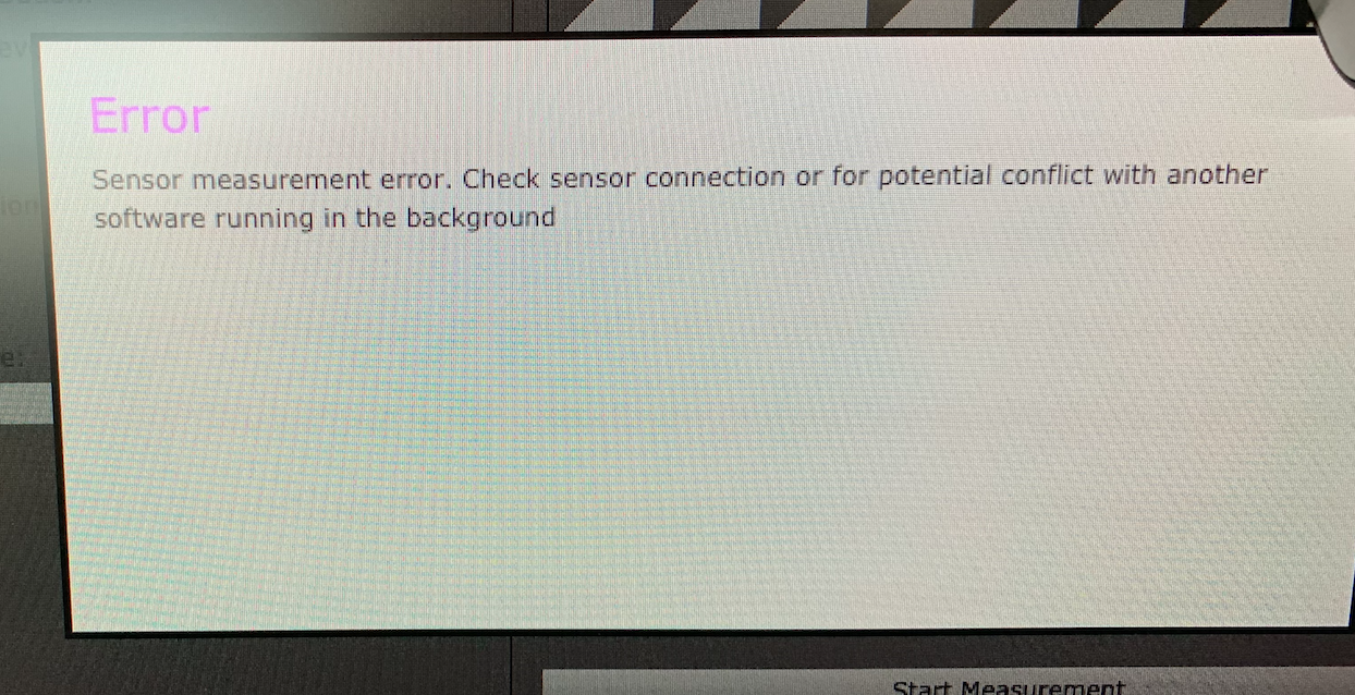

Sorry to jump into this conversation but I have received my new Benq SW240 and I am facing the same kind of issues running the Palette Master Element.
I am trying to calibrate a Benq SW240 monitor connected to my Mac Pro 2013 using the Palette Master Element software and I get an Error " Conflict with other software"
My setting is:
- Mac Pro 2013 with Mojave v10.14.2
- Palette Master Element v1.3.1
- Spyder4 connected to the monitor with USB
- Monitor connected to Mac with 2 cables DisplayPort and USB
I erase the Super software in the Mac. Anyone know what is wrong ? What I need to do more?
I tried several times and either the calibration or the validation processes do not work. They give error.
thanks

Appreciate your help. The message I got is " Conflict with other software".
A few more info on my set up.
-To delete the Spyder Software from the mac I just sent to trash and than clean the trash.
- To connect the mac to the monitor I use the DisplayPort and to ensure the PME connection I add the USB cable. So I have the two cables connected at same time.
Any possible mistake here?

Yes that is the error I get. I am starting to wonder if the Spyder device itself has a problem. Any suggestion to check it ?

Okay this error was my fault as I hadn’t seen Colormunki tray was running!
You should be able to check in the programs that launch at start up. Remove any Datacolor and Spider programs and restart your machine. Should be good to go after that.

You know what ? your guess was absolutely right. I received a new Spyder5 and when try to open PME it asked to be updated.
New version was installed and it worked with both Spyder 4 and Spyder5. So the unique problem was the PME itself which Benq solved now. What is amazing is that I was talking with them for a few days and several e-mails and even now they do not recognised that PME had a bug.
Thanks for your help. Problem solved. I am now testing the calibration. Not impressed with first try specially when compared with mas retina monitor.
