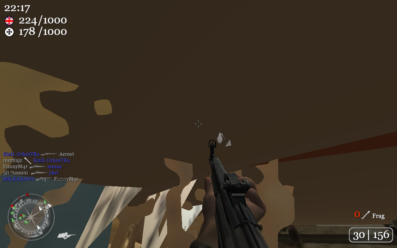

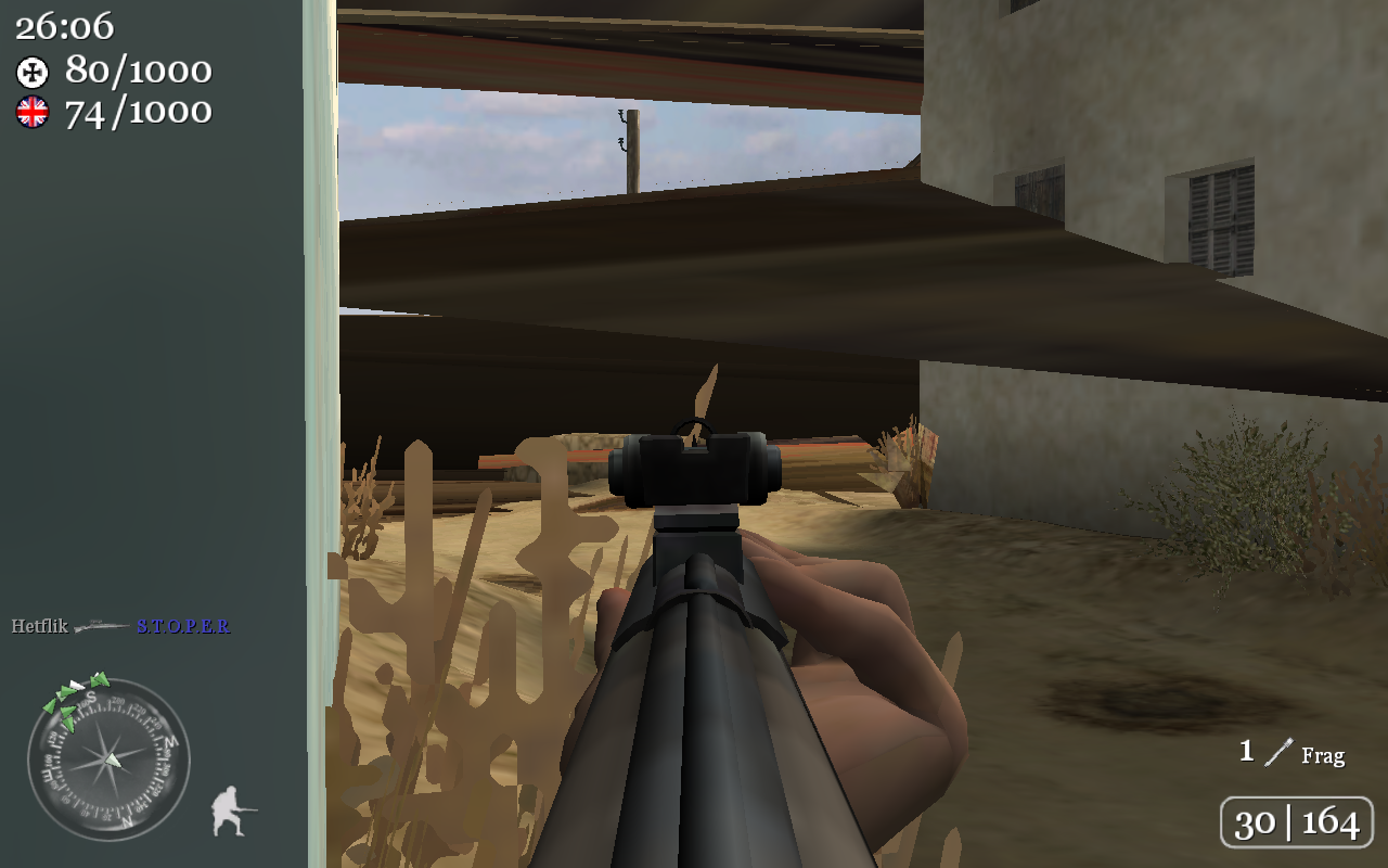

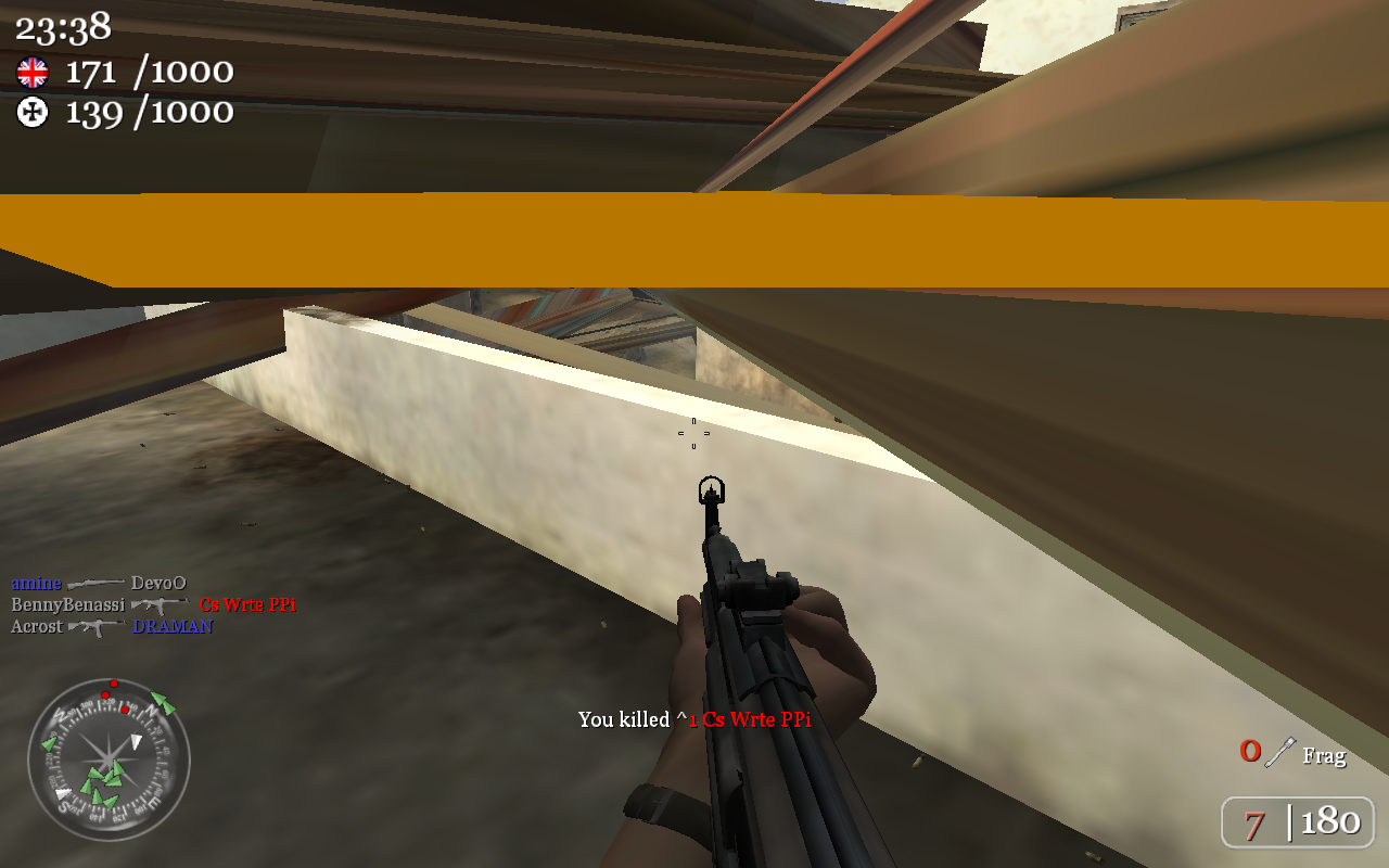

Hello,
I have got a Macbook Pro, purchased almost a year ago. Its in version 10.9.4 and it has 2.5 GHz Intel Core i5 4GB 1600 MHz DDR3. This week I decided to play CoD2 again, but after like 5 minutes, it seems like my video card can't handle the game, which i don't understand why. I saw that the problem was already posted around may 2014, but i didn't see a solution. Maybe somebody can help me?
I have three pictures, but don't know how to post these.

Looks like either overheating artefacts, or the graphics card not support needed features and effects.
Although since it happens after around 5 minutes it might be due to the machine overheating. :(
I strongly suggest you email Aspyr Support and attach those screenshots. Maybe they can help.
