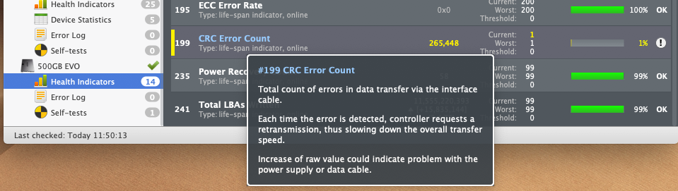

Well out of curiosity I ran Drive Dx on my system and it came back with this:
Since the "interface cable/power supply" in my case is actually the Velocity Solo card, I wonder if there's a problem with the card. I suppose a clean install on my forthcoming NVMe drive would be a good idea.

Would suggest you clone to another drive. Also worth seeing how that SATA SSD reports when connected directly via SATA sled (or optical bay) vs using the Apricorn adapter. That would troubleshoot the adapter issue vs potential drive issue.

I'm curious; I presume the RX580 is in slot 1 and the Velocity Solo card is in slot 2. Is the card in slot 2 perfectly seated and vertical, with slot cover also correctly aligned (no contact, strain, or displacement caused by the GPU)?
I've seen DrDx report CRC errors when an adapter is just barely mis-seated (looked perfect, but wasn't) and reseating the card in the slot cured it. Some cards are more finicky than others. Testing the drive in a SATA bay, as @bsbeamer suggests, can help determine whether the drive itself is producing CRC errors, however there is some chance that when re-installing the drive into the Velocity Solo and re-installing that into the PCIe slot the CRC errors will go away.

CRC errors are permanent and will be kept into the SMART, it can stop growing when installed into a south bridge SATA port, but that value will be forever with the drive.
Yes, you are correct and also precise!
Instead of telling "the errors may go away" I should have told "the errors may stop accumulating".
