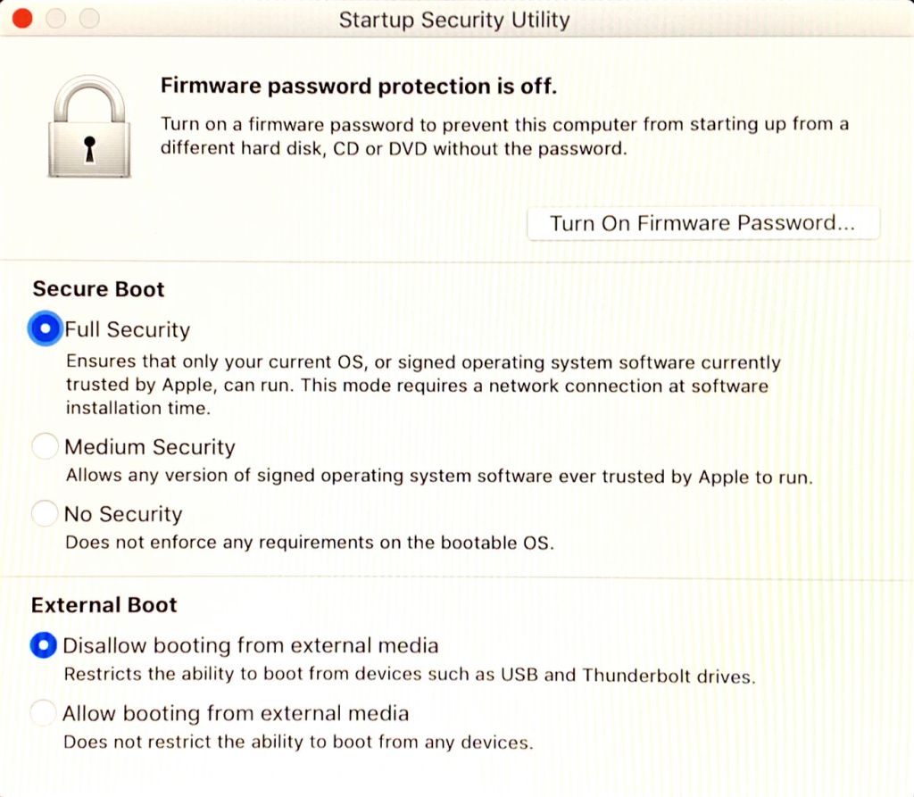

I think won't work exactly the way you want, you'll need at least Recovery working from the T2 storage since it's from that Recovery that you access StartUp Security Utility.

T2 settings: On my Mac Mini 2018 I had to enable external booting for M.2 NVME-drives, and for booting older systems I had to activate ,Medium Security'.
It's the same procedure on the Mac Pro 7,1 ?
Or are NVME blades via PCI-E now indicated as internal?

T2 settings: On my Mac Mini 2018 I had to enable external booting for NVME-drives, and for booting older systems I had to activate ,Medium Security'.
Nothing changed, still external to the Mac Pro firmware. My only doubt at this time is if the two SATA connections are still internal.
