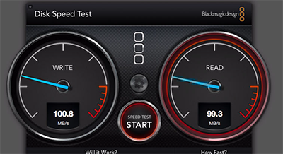

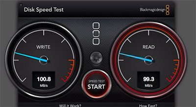

Just ran the test again on my 2014 1.4 ghz/4gb Mini with the stock 5400RPM internal hard drive. This is about that same that I saw on my base 2012 Mini with the same drive as well.

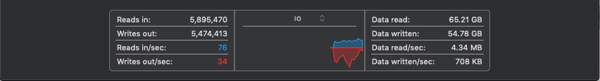

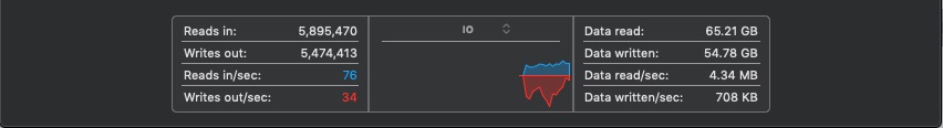

This is what Activity Monitor shows....

You need to read his posts again. The OP posted a screenshot of the disk speed test that showed (IIRC) 8MB/sec write and 35MB/sec read results. That’s ridiculous. I posted my own results from the 500gb 5400RPM drive in my base 2014 Mini and they showed 100 MB/sec read and write.
100 MB/sec is certainly slow, but it’s exponentially faster than the OP’s results. The OP also stated he was running the Mojave Beta software. So I have to disagree with you. Re-installing a non-beta version of MacOS may “overcome the speed” he is seeing. If it doesn’t, then there must be a hardware problem.

You will use the USB C to USB A cable. The USB C to C cable is for newer machines that have this newer type of interface. I’d be surprised (and impressed) if you get 540MB/sec on your Mini. The benchmarks I saw showed a slight speed increase from the older T3, but not that much (which would be about a 25% increase).
Before screwing around too much, if you have installed a non-beta version of MacOS then I would try the speed test again on your internal hard drive. If it isn’t close to 100MB/sec then you may have a hardware problem.

Could it be that the unusually poor data rates the OP experiences is due to the (new) system indexing? With that spinner HD I could imagine that this could take several days ...

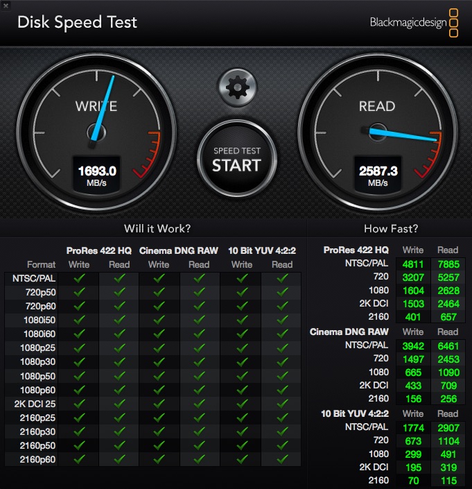

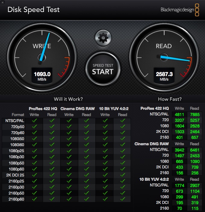

So I returned the Mini and the 13" MB Pro 2018 shows much better read speeds.
