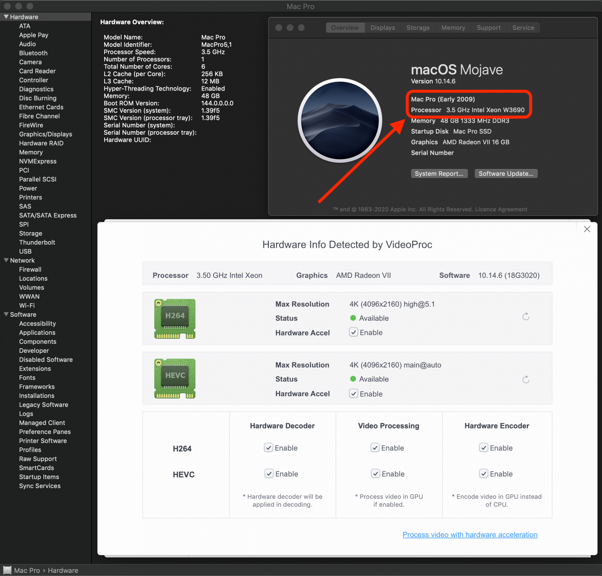

Update: haven't read the title correctly. 7,1 has HWAccel activated by default

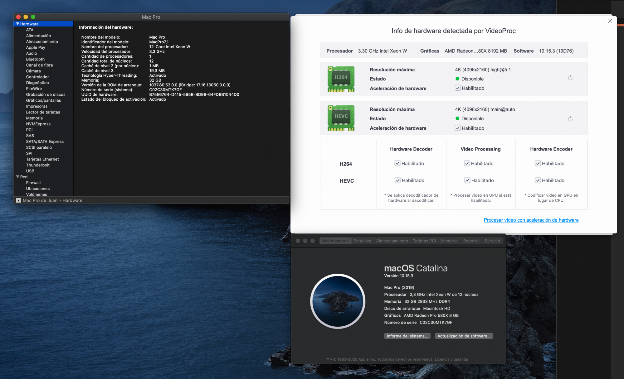

Is it necessary in new Mac Pro 2019?

Did you check if you config it properly to use HWAccel?

The 580X isn't that strong, but if my RX580 can edit and playback 4K 60FPS HEVC in FCPX timeline smoothly. I can't see why your 580X can't do that.

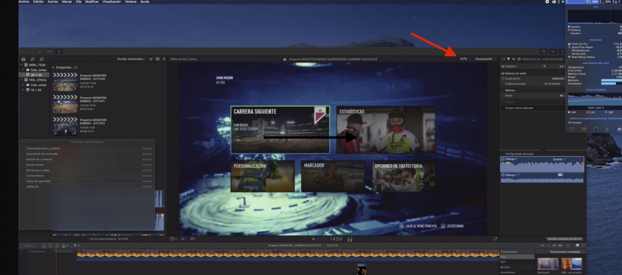

I edit in FCPX and my video is mp4 h264 1080p. Playback ok, but when I use several layer laggy. For example, look my video:

The OP claims the same project plays back smoothly on his 2013 iMac, but his new MP7.1 cannot playback the timeline smoothly!
I looked at his example video on you tube and he is playing back several layers of video with effects and transparency at 147% resolution - unrendered.

In the playback window you have the zoom at 147% maybe make this 100% or less and see if it makes it smoother?

The 2013 iMac use QuickSync to hardware decode the H264 video on the timeline. And the 780m to render the effects. I won't be too surprised that the iMac can play un-rendered timeline smoothly.
For 7,1, we still not 100% sure, but most likely the 580X use AMD UVD to decode the timeline. The question now become if the 580X can do BOTH hardware decode and render the effects in realtime.

I test it. Same problem. 100% or 30% it’s the same problem. I don’t know What Is it the problem?

h9826790 pointed out that the Intel process have quicksync to decode h264 the Xeon do not have this function so they need to use the GPU to decode.

I use this effects and two layers at the same time. No more. It is in this moment when I have the problem.
If a Render all no problem. All timeline smoothly. Perfect.
