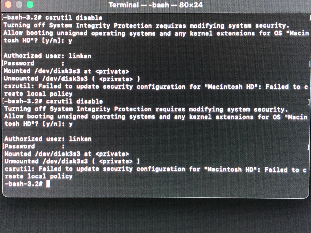

As I now are completely dependent on Xtrafinder, I want to install it on my Mac mini M1.
The first step is to disable SIP. Previously, it has worked well by starting in recovery mode running terminal and deactivating through csrutil disable. But now on the M1 Terminal also asked for username and password. See photo. Entered the correct username and password, but then only got back that it failed. Others have been successful with this, why not me? Running Big Sur 11.1.
I am having the same issue(s) you’ve described here. I utilized all of the same
Methods. When I attempt to change the boot security to reduced I get the same error (I think bc I speak English). I tried csrutil clear reboot, nothing. I tried csrutil enable, all good with that then status then csrutil disable again same thing failed to create local policy. What does that message even mean? People seem
Not to be attempting to help resolve the problem and are indicating youre doing something wrong. I don’t think you are. Sadly I’m only trying to do this so I can get a game pad configuration updated on steam so I can use my PS4 controller to play games on steam. Always states the update for this failed. It states on various forums to disable SIP and I end up with all of this. I’m not this technologically savvy and I don’t want to accidentally break my Mac lol

The most likely cause of this issue is that recoveryOS is not entered in an expected way for BootPolicy to detect that recoveryOS as "true" (1TR in short).
Please ensure that you enter recoveryOS as follows:
- shutdown the machine normally
- press and hold the power button until you see "Loading startup options". Make sure not to release the power button prematurely, nor press and release it several times, do it all in one press and hold.
- click "Options" and "Continue" to enter recoveryOS.
There are several ways to determine if your recoveryOS is 1TR:
- starting with 11.3 betas, open Terminal and run "bputil -d", it will show the current OS environment. The expected one is "one true recoveryOS", if you see "ordinary recoveryOS", you are not in 1TR.
- in any version, open Terminal and run "bputil -k" (this will attempt to enable support for 3rd-party kexts). If the command fails with error 11 (AP boot mode), you are not in 1TR.
- Try enabling user-controlled 3rd-party kexts (requires Reduced Security mode) using Startup Security Utility. If an attempt to enable it fails with error 11, you are not in 1TR.
Once you determine that you indeed are in 1TR, "csrutil disable" should work as expected.

1TR is defined as "primary recoveryOS + physical presence flag set by iBoot if power button is held correctly".
This is a relevant bit from bputil manpage:
By design, the SEP application which is responsible for making changes to the LocalPolicy will inspect the boot state of the main Application Processor (AP). It will only allow the below security-downgrading operations if it detects that the AP is in the intended boot state. When System Integrity Protection (SIP) was first introduced to Macs, it was decided that requiring a reboot to macOS Recovery would provide intentional friction which would make it harder for malicious software to downgrade the system. That precedent is extended here to detect the special boot to macOS Recovery via holding the power key at boot time. We refer to this as One True Recovery (1TR), and most of the below downgrade options will only work when booted into 1TR, not when called from normal macOS. This helps ensure that only a physically-present user, not malicious software running in macOS, can permanently downgrade the security settings.
What I'm suggesting is that somehow some users indeed end up in primary recoveryOS, but iBoot doesn't set the required physical presence flag for some reason (power button released too early, jitter, trying to force shutdown by holding power button, and then initiate boot into rOS, something else).
