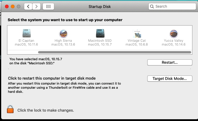

Re: K two,
I came across the above screen shot of the many macOS/X operating systems you were able to install at the conclusion of this thread and attempted to message you but it wouldn't go through (some error about "appears to be spam"). As a result, I am replying directly to this thread even though it was started in 2020.
I have been using Macs since the early 1990s but have fallen extremely out of date (still using a late 2009 Core 2 Duo 27" iMac (10,1), mid-2012 MacBook Pro (9,1). As a result, I failed to appreciate before I placed an order for a deeply discounted new 27" 2020 iMac (MHJY3LL/A, which is apparently an upgraded configuration of MXWV2LL/A) that I will have no way to run Microsoft Office 11 and CS6 web & design applications on Catalina, which apparently comes preinstalled..
Before stumbling across your posts on this thread, I scoured the Apple discussion forums and elsewhere for answers but it wasn't until I saw your screen shot that I had any hope that there may be a workaround that will allow an older macOS to install/boot.
I am somewhat hesitant to go the emulation route because graphics acceleration is apparently unsupported. (Having never worked with VMware Fusion or Parallels I am also concerned it could be slower than my current setup). So before I buy a license for Parallels or VMware Fusion, I thought I would reply to inquire if the methods discussed in this thread might work for a 2020 iMac that also shipped with Catalina? If so, is there another thread here — or a guide — that describes how to pull this off?

As covered earlier in the thread, there is no way to install an operating system older than Catalina on a 2020 iMac. A virtual machine would be the only option.
That's long what my understanding has been too — until I saw K two's screen shot in post #18 and post #10 from bogdanw.
K two's startup choices range from 10.6.8 to 10.14.6. I could be wrong but I'm not aware of any Mac that natively supported Snow Leopard but can also run Yucca Valley. Unless I'm mistaking that screen shot (from within a emulator?), it suggests that there are workarounds for macOS versions that predate the hardware.
Years ago I configured my existing setup on a partitioned drive containing Snow Leopard (native for the 2009 iMac) and a second partition for El Capitan. I had hoped to duplicate a similar setup this time with CS6 web & design and MS Office 11 running in a Mojave (or High Sierra) partition and the newest macOS running in another partition for improved security, web browsing and the like.
Optimistically, I would like to believe that the 27" i9 3.6Ghz 2020 iMac I just purchased will be such big upgrade from my existing hardware that even in emulation without the benefit of graphics acceleration it will beat the performance of CS6 web & design on my 2009 iMac and 2012MBP. But if that's asking too much — or if I am unable to obtain a license/support for what are apparently "depreciated" versions of VMware or Parallels that will run Mojave, High Sierra or similar — I may have to revisit my assumption that a 2020 iMac will do the job better than a 2019 or 2018 model (purchased used).
OpenCore is used to allow newer operating systems on older hardware. It won't work in the other direction. Yucca Valley is not the name of a macOS version, but it shows 10.14.6, which is Mojave. A 2010 or 2012 Mac Pro can natively run both of these.
You will likely find that Adobe apps are effectively unusable without graphics acceleration in a virtual machine.

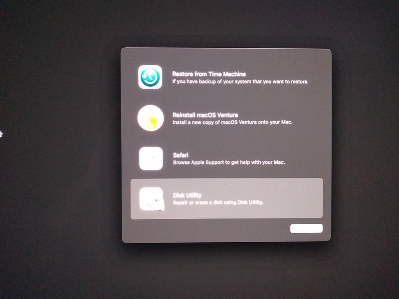

Interesting. 2020 iMac, preinstalled with Catalina. Installed Monterey then upgraded to Ventura. All is fine but I need to run some older software and printer drivers that only work with Cat. I'll just install Catalina on an external. Wrong. When I try to install from a Cat thumb drive in recovery I get stuck in a reboot loop. Reinstall Catalina doesn't show up any longer just Ventura.
IMG_20230909_151516529 by https://www.flickr.com/photos/146780422@N05/
