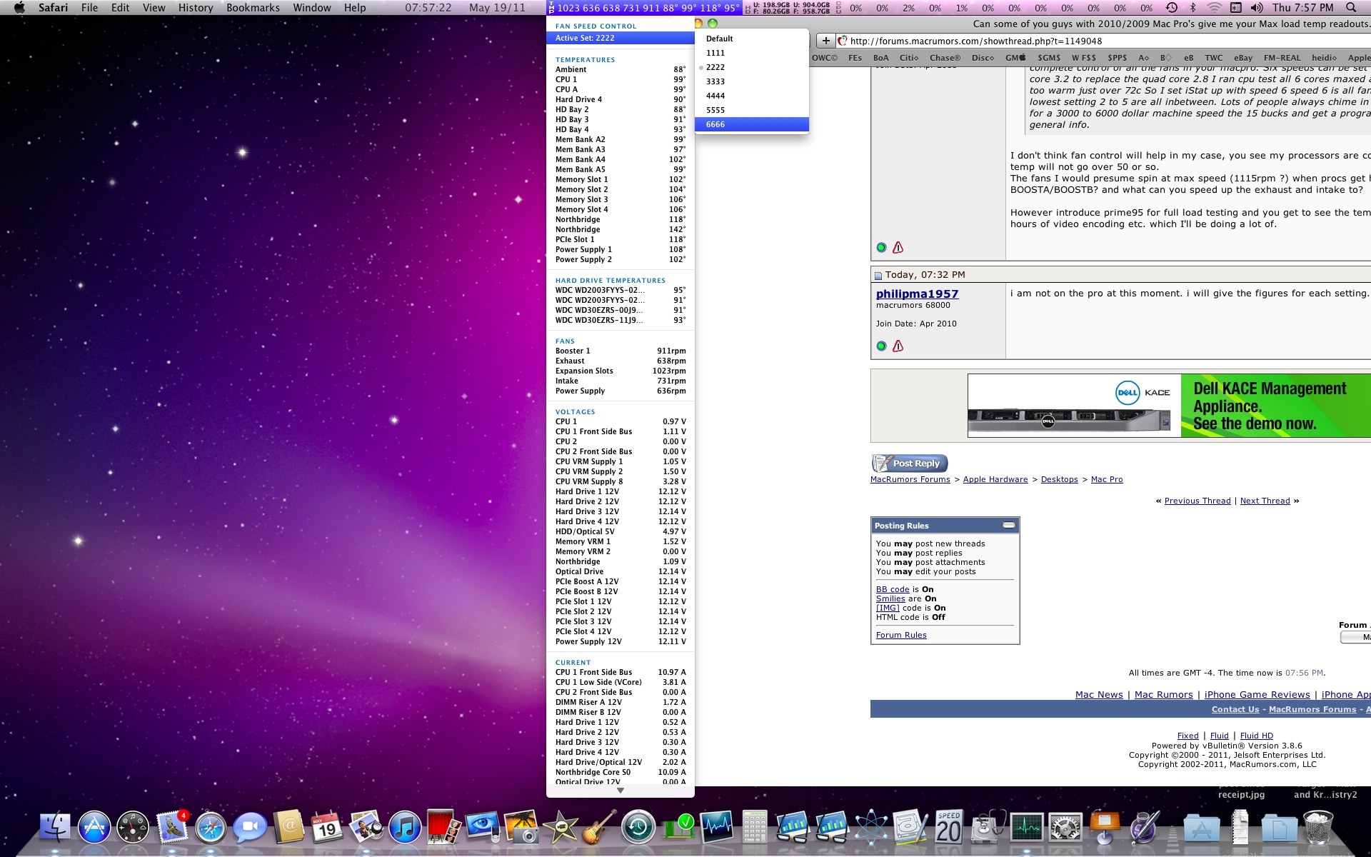

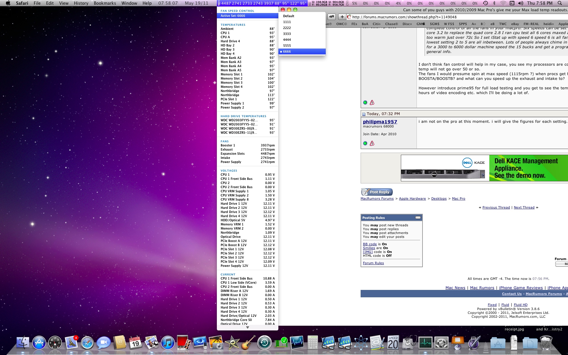

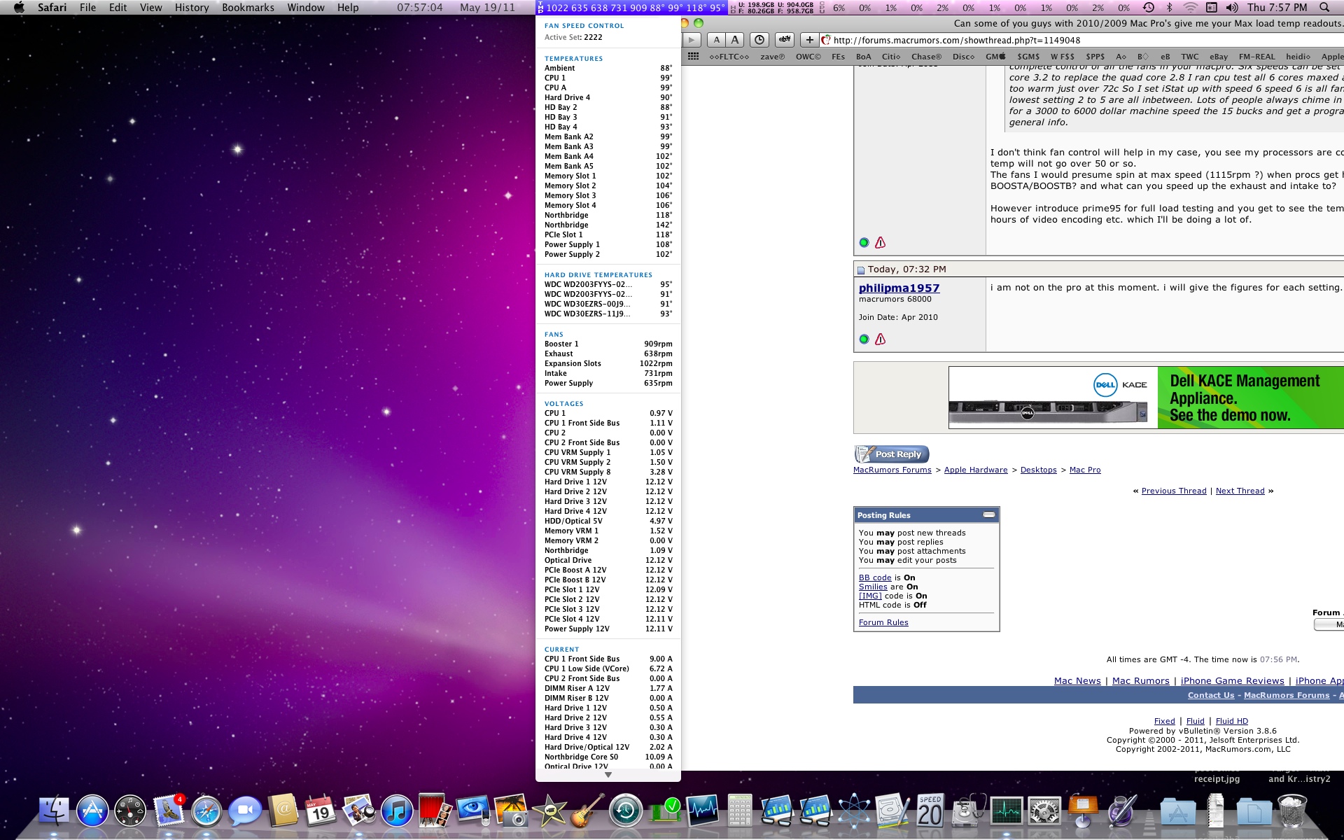

What are you doing for fan control? You know that a full iStat program costs only 15 dollars. You get full and complete control of all the fans in your macpro. Six speeds can be set for each fan. When I added the hex core 3.2 to replace the quad core 2.8 I ran cpu test all 6 cores maxed at 100% for 2 days. My cpu became too warm just over 72c So I set iStat up with speed 6 speed 6 is all fans at full speed. Speed 1 is all fans at lowest setting 2 to 5 are all inbetween. Lots of people always chime in and say smcFancontrol is free. I say for a 3000 to 6000 dollar machine speed the 15 bucks and get a program with much better fan control and general info.
I don't think fan control will help in my case, you see my processors are cool when just doing everyday things, the temp will not go over 50 or so.
The fans I would presume spin at max speed (1115rpm ?) when procs get hot. What is your max rpm for BOOSTA/BOOSTB? and what can you speed up the exhaust and intake to?
However introduce prime95 for full load testing and you get to see the temps the machine is likely to hit say after 8 hours of video encoding etc. which I'll be doing a lot of.
i am not on the pro at this moment. i will give the figures for each setting. in about 20 minutes. I took 3 screen shots first shows how my machine is set for surfing. speed 2222 that which I program look at the fan speeds. second shows how I just am about to change it to speed 6666. third screen shot shows full speed settings of 6666 the machine is really fast fans. I ran this machine at all 6 cores well 12 with the virtual cores at 100 % for 2 days my temps were at 55c with fast settings. I am just saying for 15 bucks this may be the right work around.
In fact I still have it at max speed and temps dropped even more. IN my hex 3.2 core mod I have a lot of test results. done with your needs in mind(heavy cpu users).
I tested the machine with all cores maxed at 100% for a reall long time and showed results. In fact the mod was done to help people that need a better machine for business at a better price.
  • Screen shot small 1 5:19.jpg
