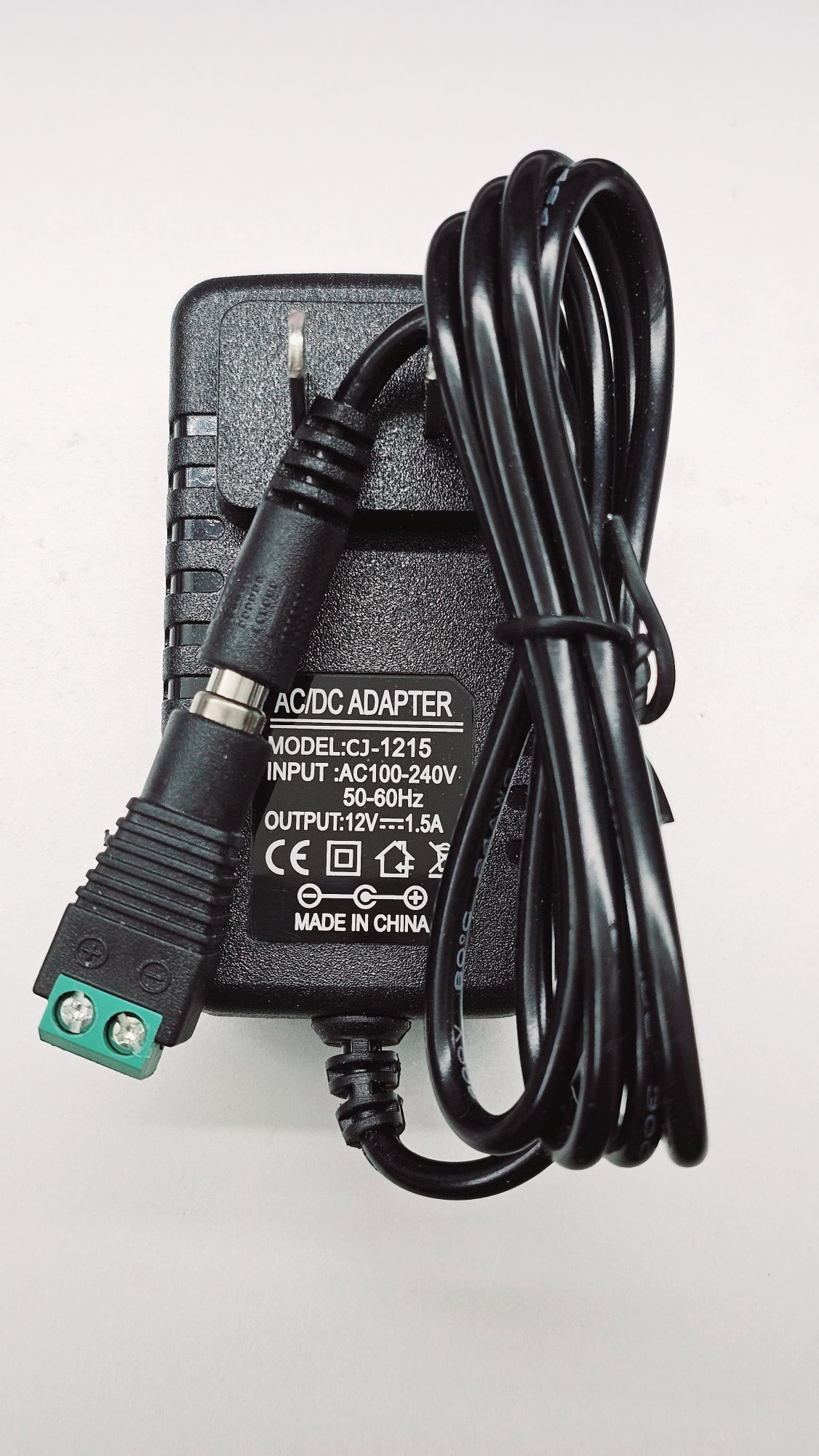

1st of many items delivered today!
AC:DC CJ-1215.jpeg

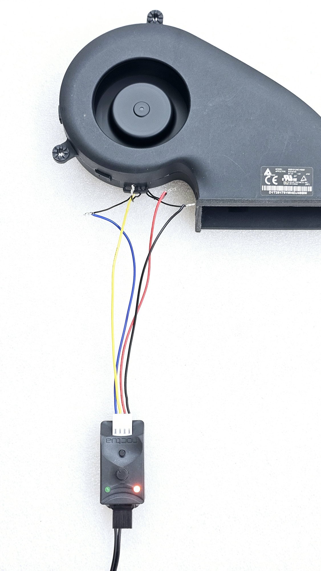

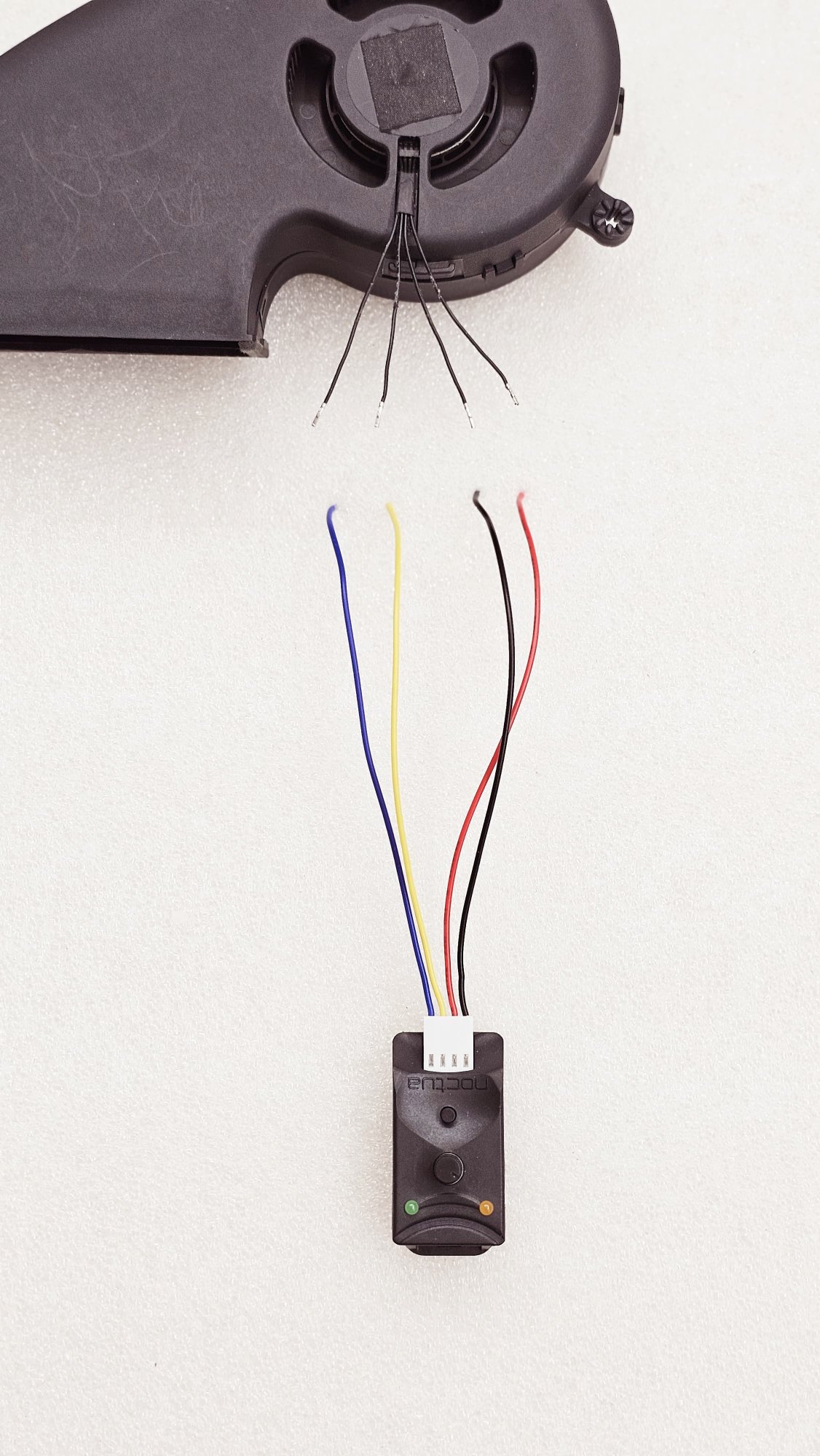

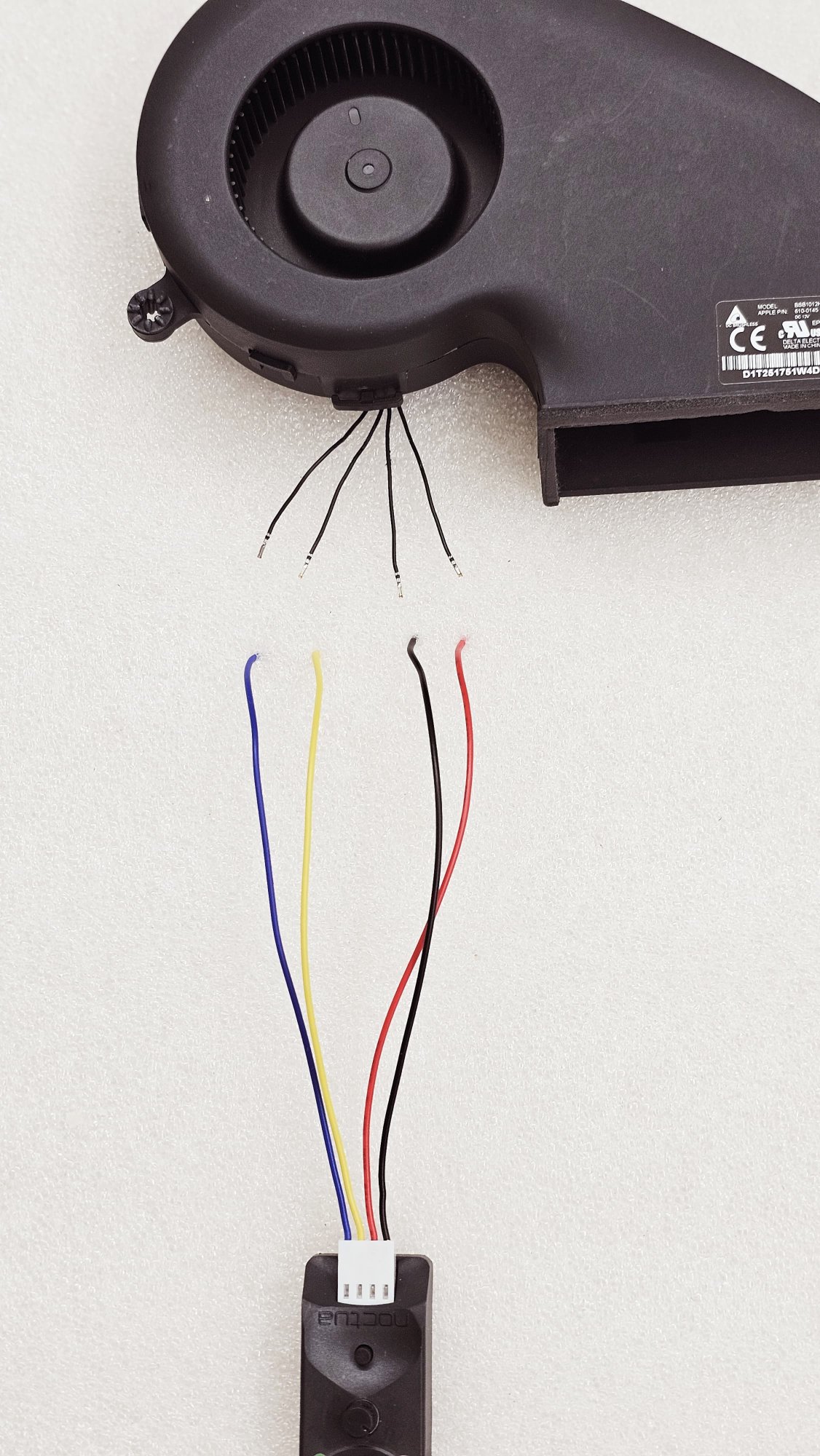

@PaulD-UK, finally, the noctua controller is here... what will be correct order to connect the wires of the OEM fan? Notice the crossed black & red wires & the flipped fan in 2nd image. TIA
PaulD-UK
macrumors 6502a
Oct 23, 2009
905
506
In your L/top pic the iMac’s fan wires from Left to Right are:
+ve -ve Speed PWM
So the R/bottom pic is correct. 👍

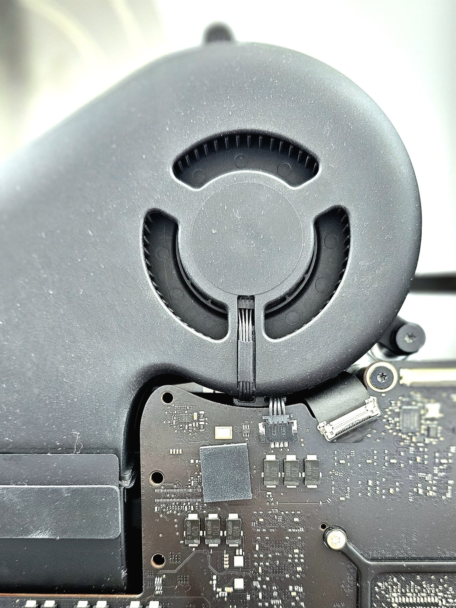

Great info in this thread - I'm attempting a similar thing with the fan on a 2018 mac mini (after trying to change the fan, and getting nothing from smcFanControl). I'm struggling to find information on the wiring though - the best I could find was in a comment on a youtube video (!) but, like the original poster, I'm not sure how to translate that to the wire coming from the fan.
The comment said:
Pin 1 Speed Control Pin 2, 3 no connect Pin 4 +12v Pin 5 Ground Pin 6 Fan Rpm
Someone else commented:
For future Mac repairs those are Molex Pico-EZmate connectors, part number 781715006 for the six pin type, 781715004 for the four pin fan connectors on various MacBooks.
Anyone know if this is accurate, and which side pin 1 is on in the attached pic?
Thanks in advance.
Neutral Singh
macrumors member
Oct 18, 2019
60
37
Thanks in advance.
Sorry, just saw this. If you are still looking for an answer, please see this message and subsequent messages for the clues...

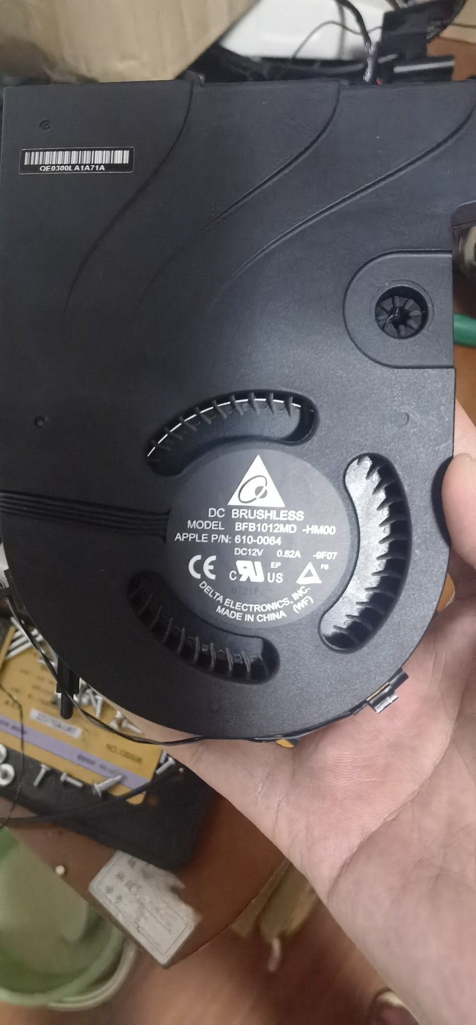

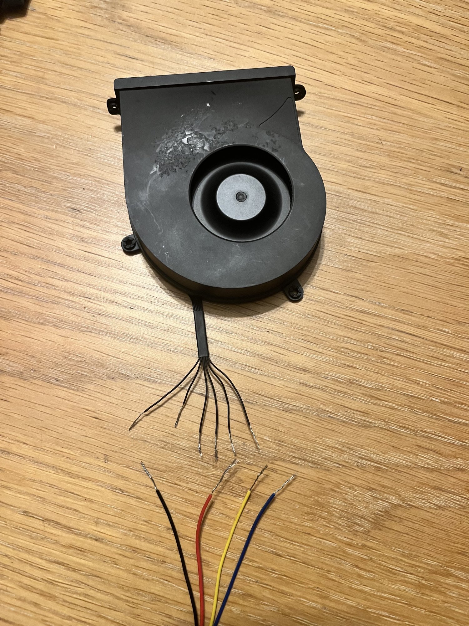

What about the fan of 27 imac 2010Mid?
Can it controlled by general PWM controller? Here's fan pic
PaulD-UK
macrumors 6502a
Oct 23, 2009
905
506
Quote:"What about the fan of 27 imac 2010Mid?
Can it controlled by general PWM controller?"
I can't see the power/control wires in you're pic, but if it's four wires then it will be PWM, and a controller will work.
Which wire is which needs to be tested...
