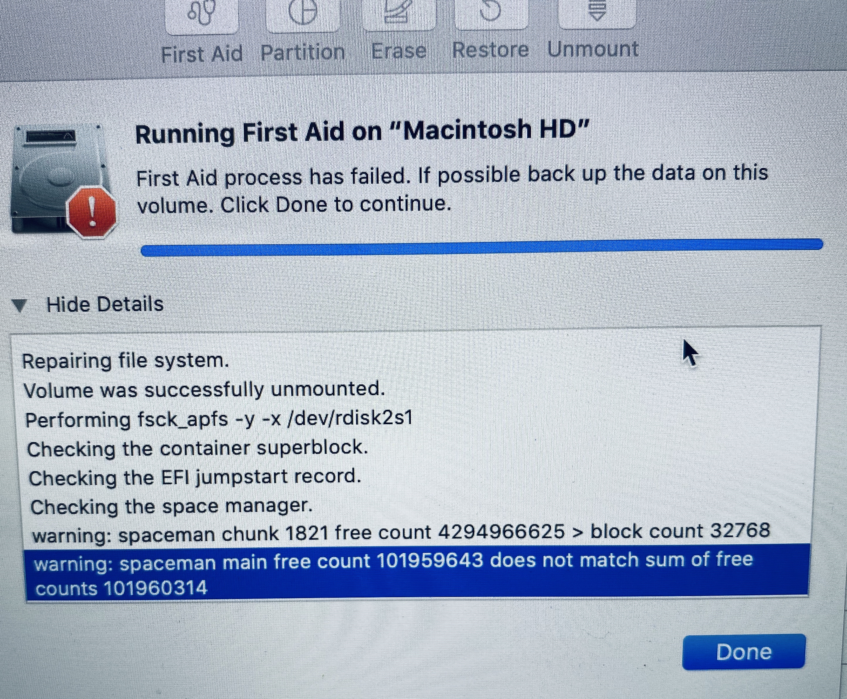

I have an issue with installing Catalina on my 13” 2013 MacBook Pro. Two years ago, I upgraded the hard drive to a 1gb SSD (OWC Aura). When I installed other OS upgrades since then, I never had a problem.
However, today, I received this error:
MacOS cold not be installed on your computer
Storage system verify or repair failed. : (69716)
Quit the installer to restart your computer and try again.
Obviously, I restarted and it didn’t solve the problem.
I seem to remember others overcoming this issue with a third party hardware internal SSD and upgrading the OS.
If anyone could give me a tip for installing Catalina on this particular MacBook I’d greatly appreciate it.
Thanks!
-Ted

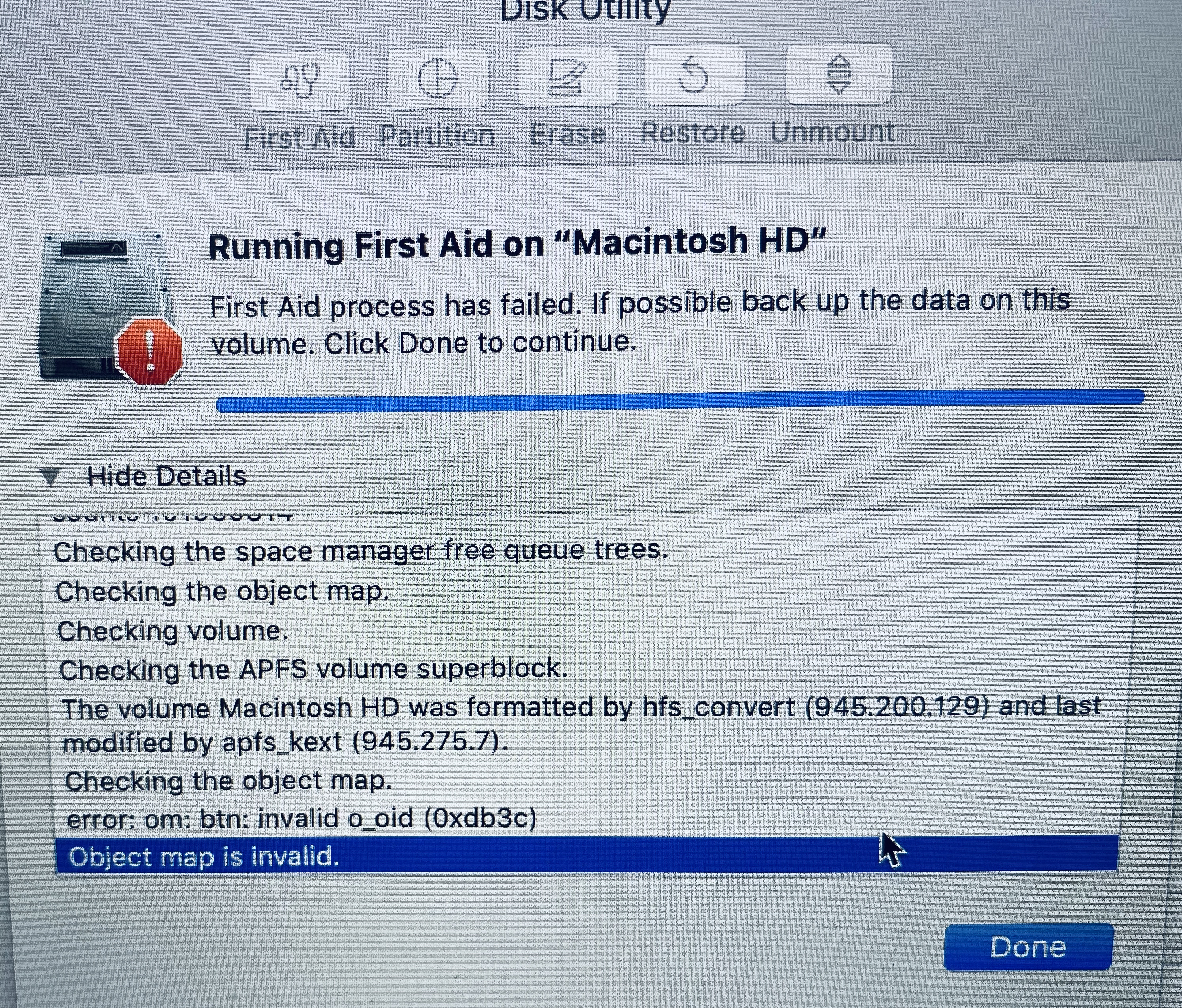

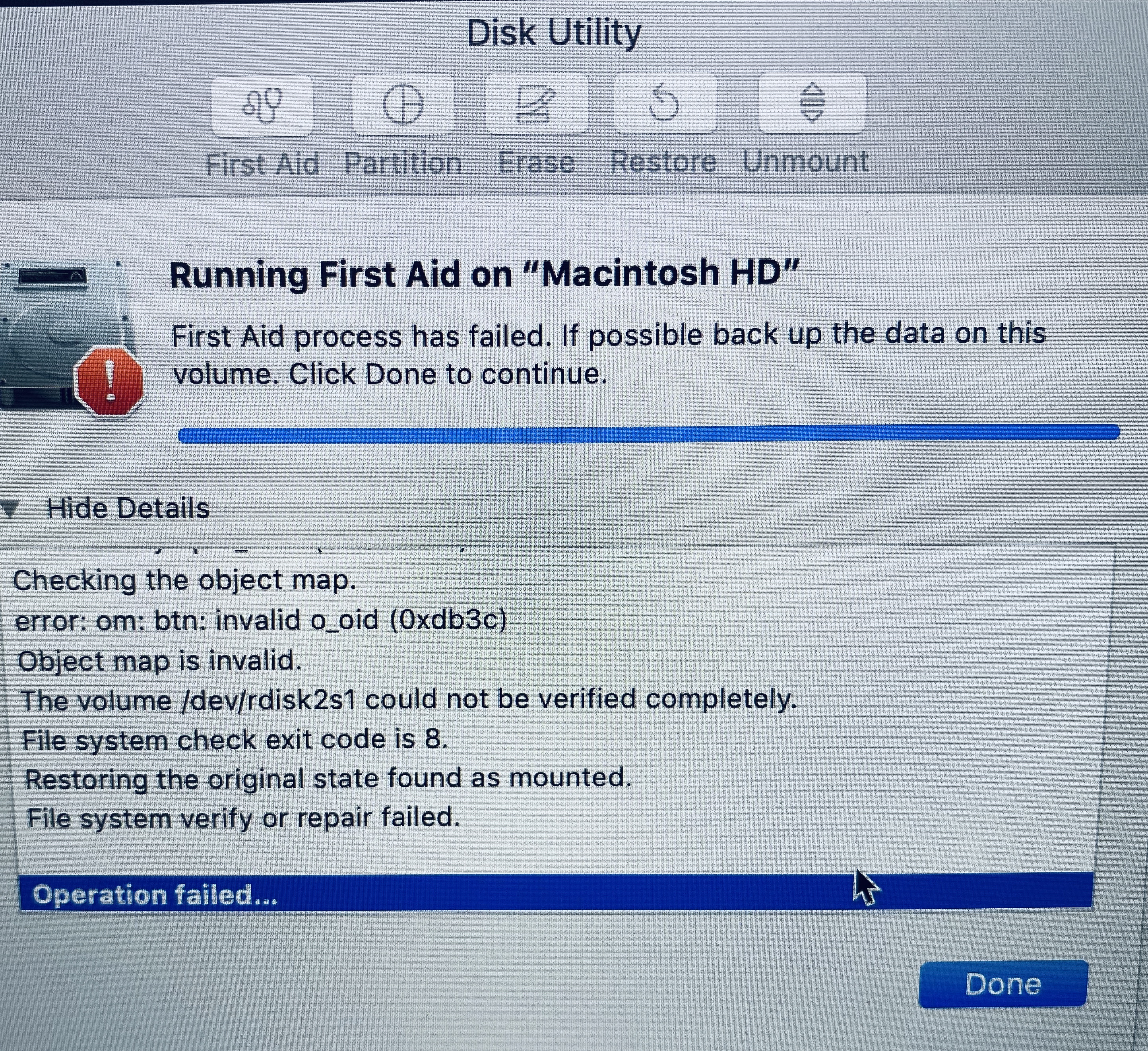

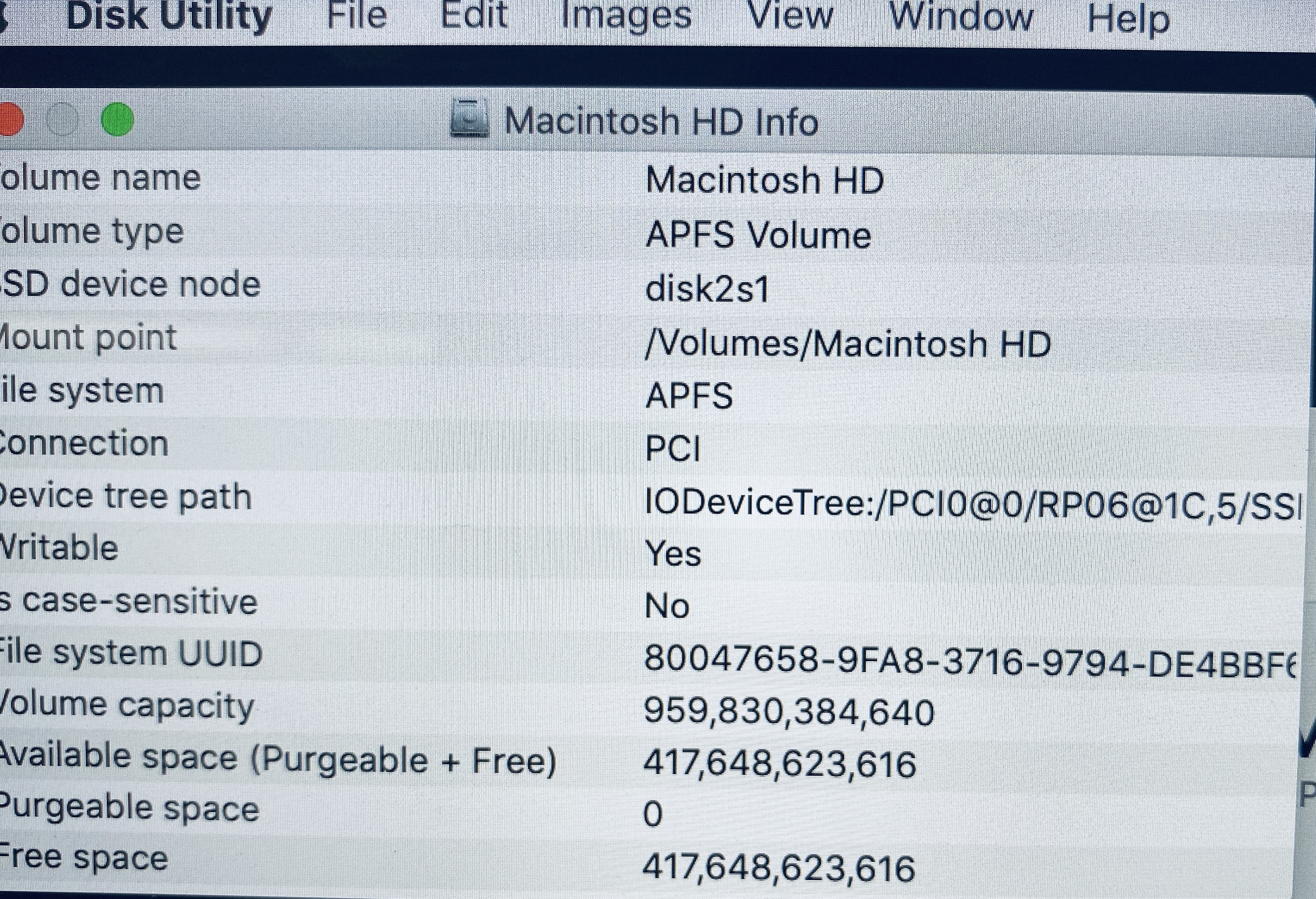

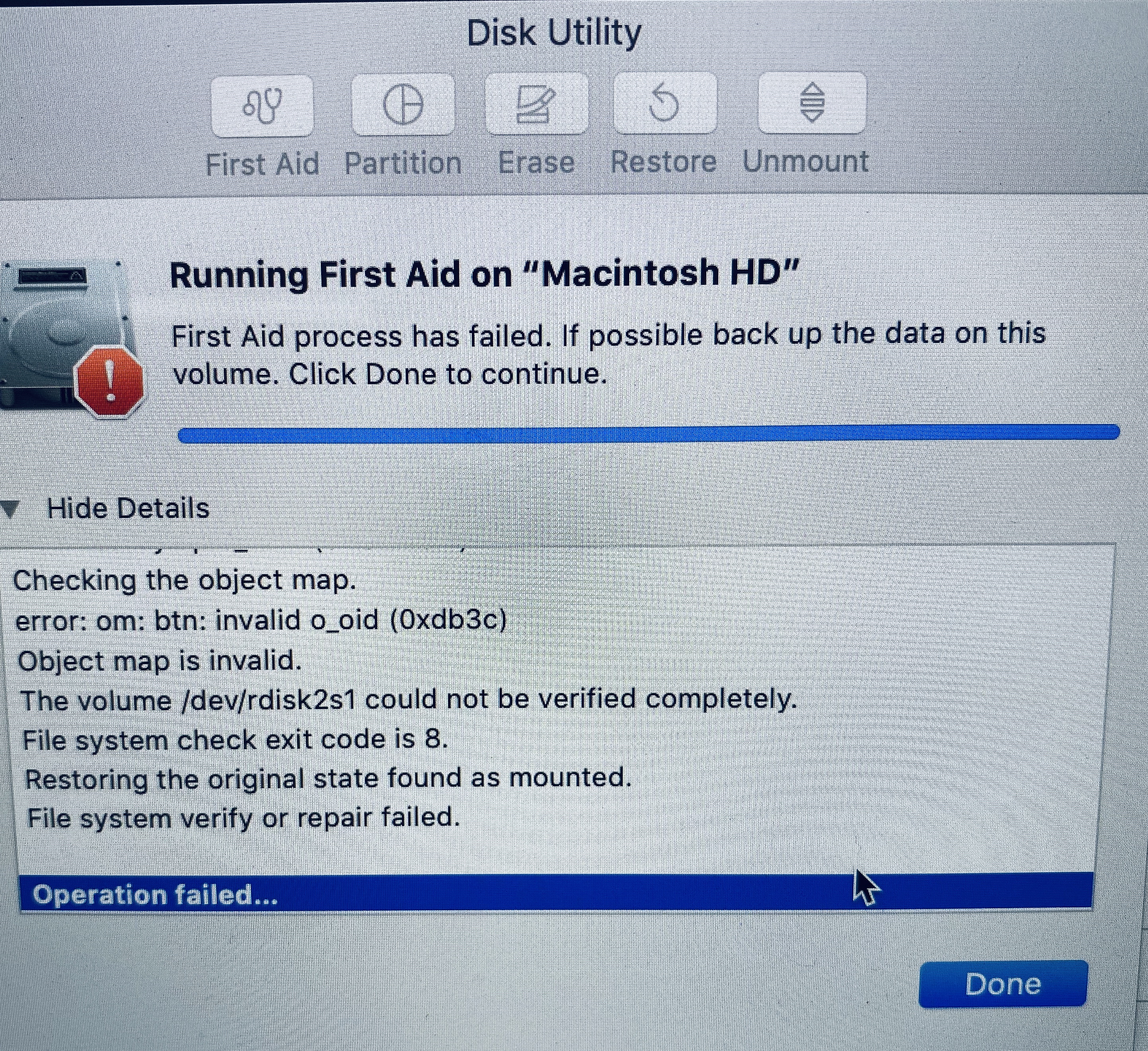

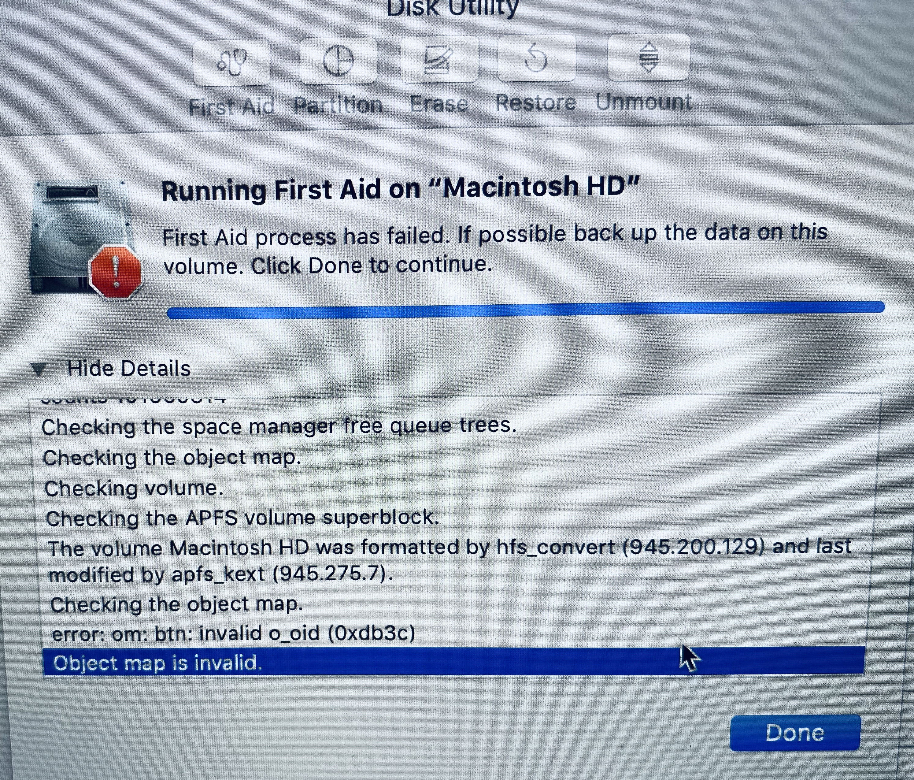

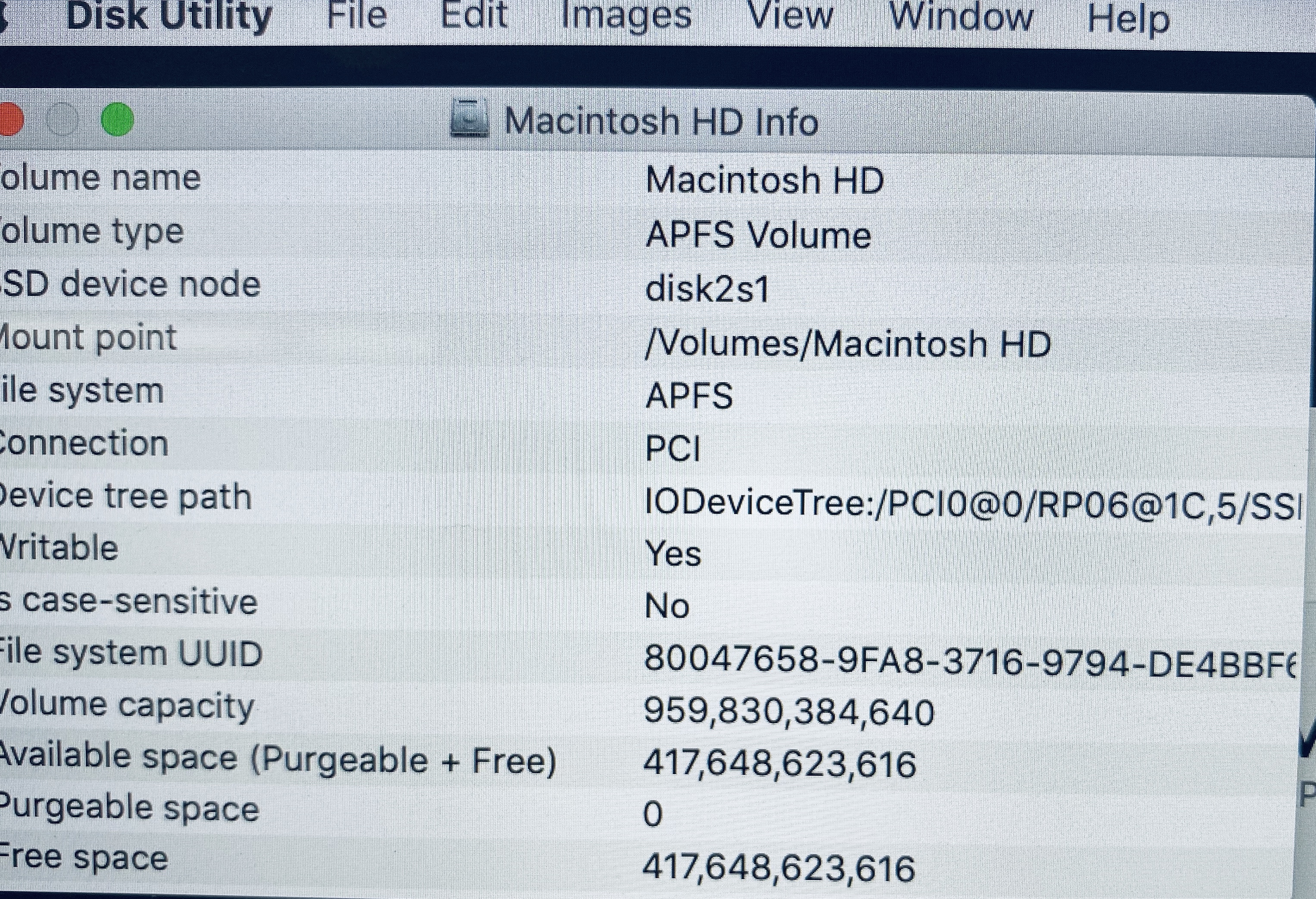

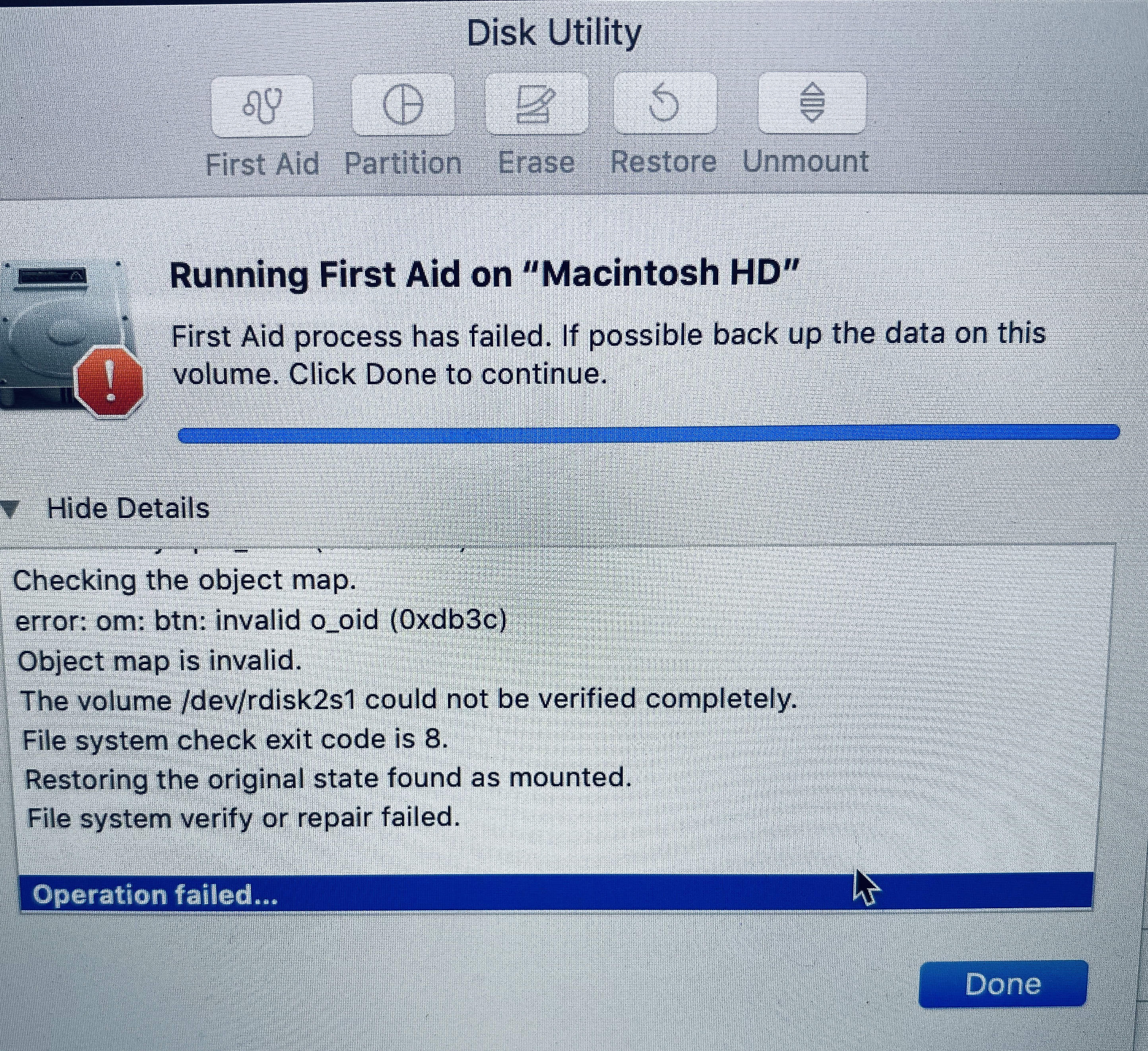

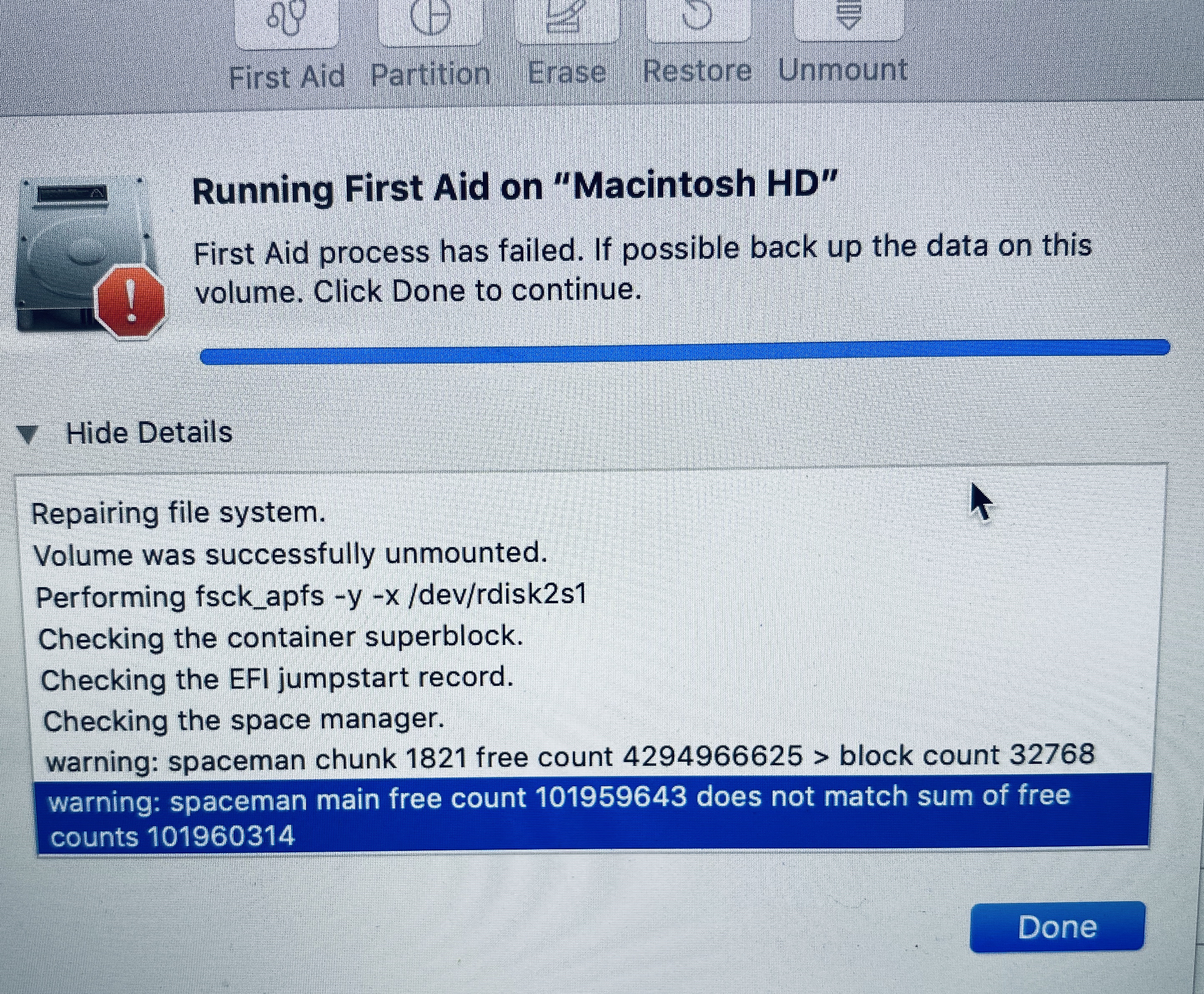

I also ran the disk utility. Here are the screenshots from that:
Again, I recall reading about jumping through some hoops to do a full OS upgrade with a third party SSD upgrade.
Thanks!
