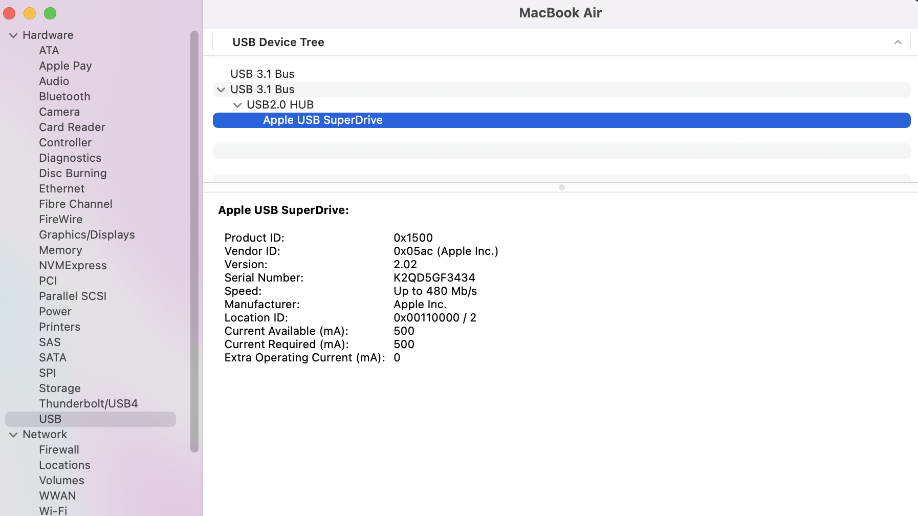

Hi. Can you tell me if it is possible to run the Apple Superdrive with MacBook Air M2 Sonoma? I have tried everything including the First Aid. I can see it listed, see screenshot. I like to save on CDR for mailing to a friend overseas. And, it would be nice to hear some music.

Thanks for your reply. Sorry, but I do not know what a MBA is. I bought a hub because nothing connected. It is attached to the usb outlet of this hub. No response whatsoever. Nor does it feed in the disc. Not shown in Finder.
MBA is short for MacBook Air. The Super Drive needs power to run it, the hub you are using is not providing it any power to operate.

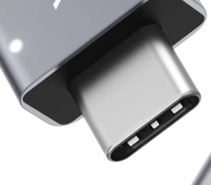

This is what did the trick:
Anker USB C Adapter (2 Pack),High-Speed Data Transfer, USB-C to USB 3.0 Female Adapter - only around €8 from Amazon.​
