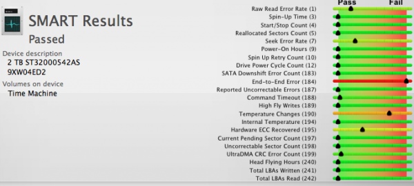

Disk Utility said the drive was fine.
Again, doesn't mean a thing. DU says this disk is fine, also. I tested it in a TM capsule but after I pulled it from a 2011 iMac.
If your disk is fully OK from disk utility - it's your graphics card as I said earlier ........... known issue on 2011 iMac look it up online.
Perhaps. The culprit is the HDD. Its excess heat is the cause of GPU problems in these. The solder joints get stressed after extended periods of overheating and cooling— that's why baking so often works.
The fix is to remove that spinning heat pump, replace it with an SSD. The job takes an experienced tech well under a half hour. A 2TB SSD with the OWC toolkit, temp sensor and a CR 2032 NV RAM battery costs around $350. It's an easy DIY.

Correct but, with AppleCare, one received a copy of TechTool on the AppleCare CD in 2011. Being on OS 10.6 or 10.7, it should still work. The above screen shot was made with TechTool Pro.
