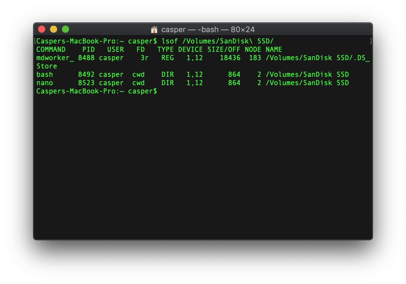

Whilst no application may visibly be open, a background process could still be clinging to the drive.
There's a command called lsof. Stands for "List open files". You can use it too... Well, list open files and processes holding the files. If you give it a path it'll only show relevant info for that path.

While I've already written it earlier in the thread, I feel I should reiterate for newcomers with the same issue, that you can run lsof in Terminal to see what processes hold open files on a device or folder (or specific file). The command stands for list open files. With no input it lists everything, but point it to a directory, like /Volumes/SanDisk\ SSD/ in my case, and it lists only open files in that directory. In my example below, I've opened a text file called hello.txt with nano in another Terminal window.

Nothing is running so it must be an Apple process of some kind. I know it is, because force quitting Finder usually give me a brief window of opportunity to eject. lsof is just a big mess. I can see that Quicklook is accessing the images on the drive. Why? What is so important , that Quicklook has to do this right now and not relinquish control?
