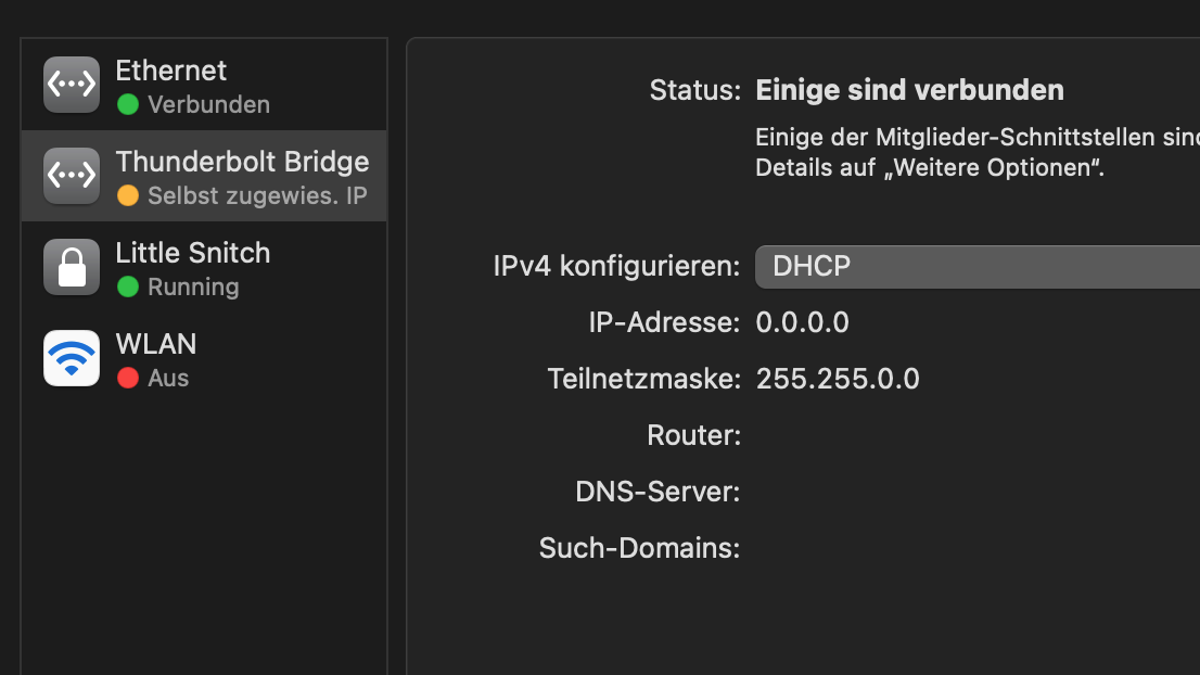

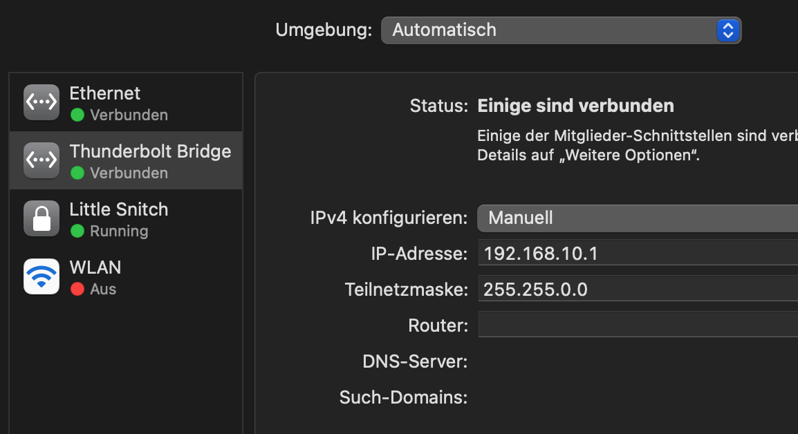

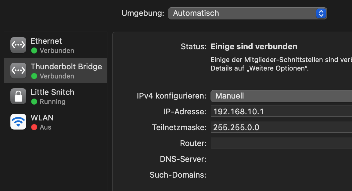

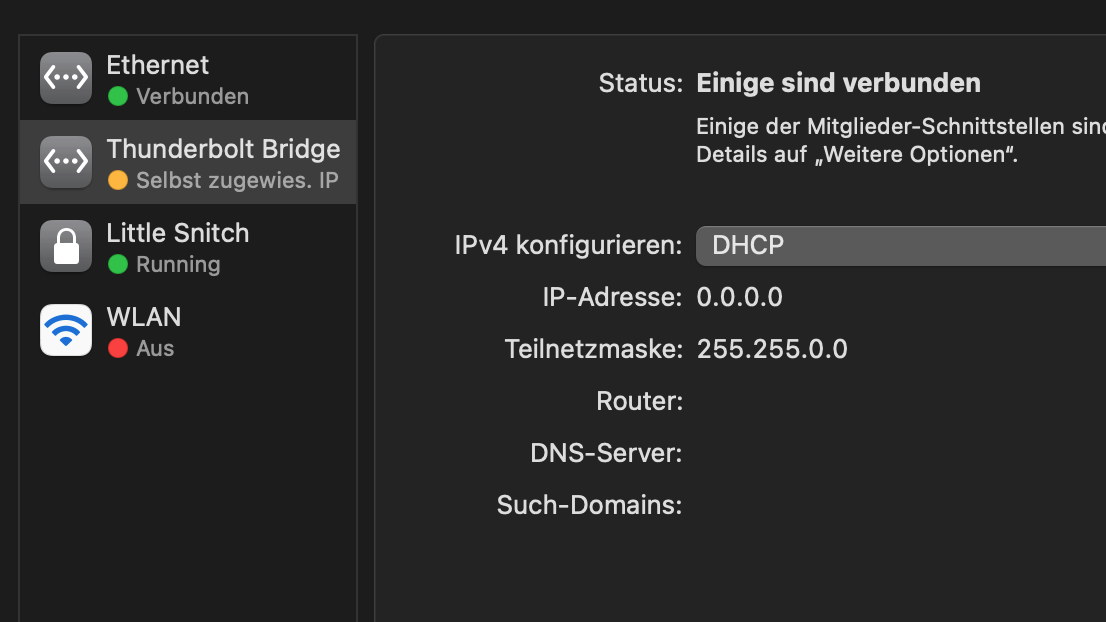

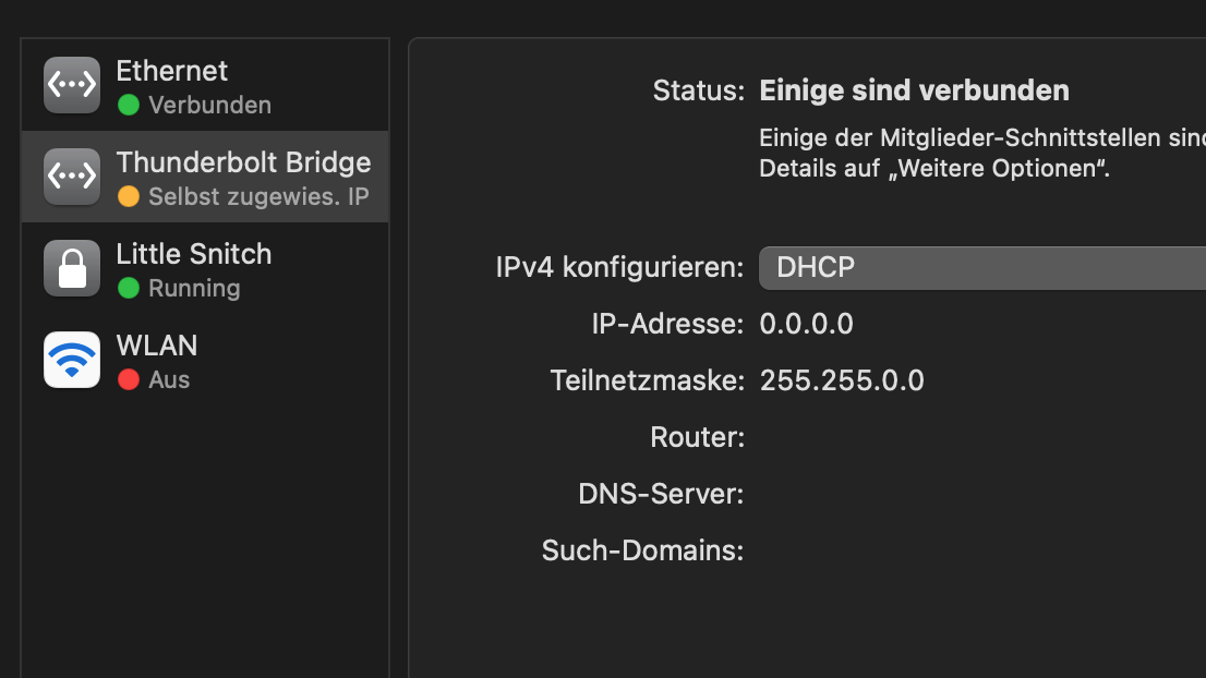

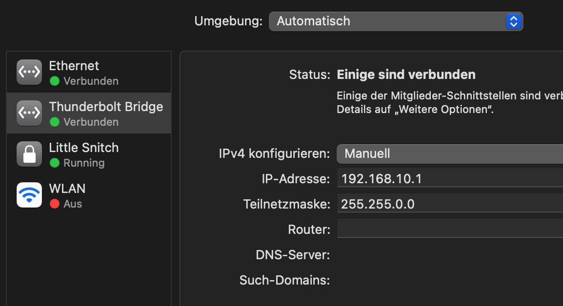

Are you sure this is thunderbolt cable and not only a USB-C cable? From where did you get the cable?
If I connect 2 Macs over TB, I get feedback within seconds.
Now set IPs on both Macs and done.
