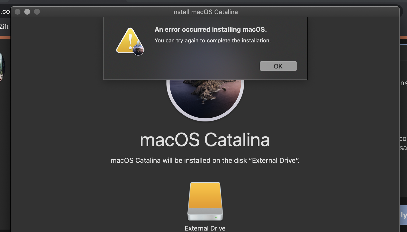

already tried that too....exact same error message.
I've been scouring the internet and the only thing I found of any interest talks about the type of internet connection (security wise). I've tried via my wifi, local wifi, direct ethernet connection, iphone hotspot. All with the same negative result. The only thing these have in common are that they all go through Xfinity. I can't imagine why that would matter, but the error log does contain several lines like this
Warning: couldn't obtain xar-verified URL for http://swcdn.apple.com/content/down...gt4ugp7hjp4/OSX_10_15_IncompatibleAppList.pkg
