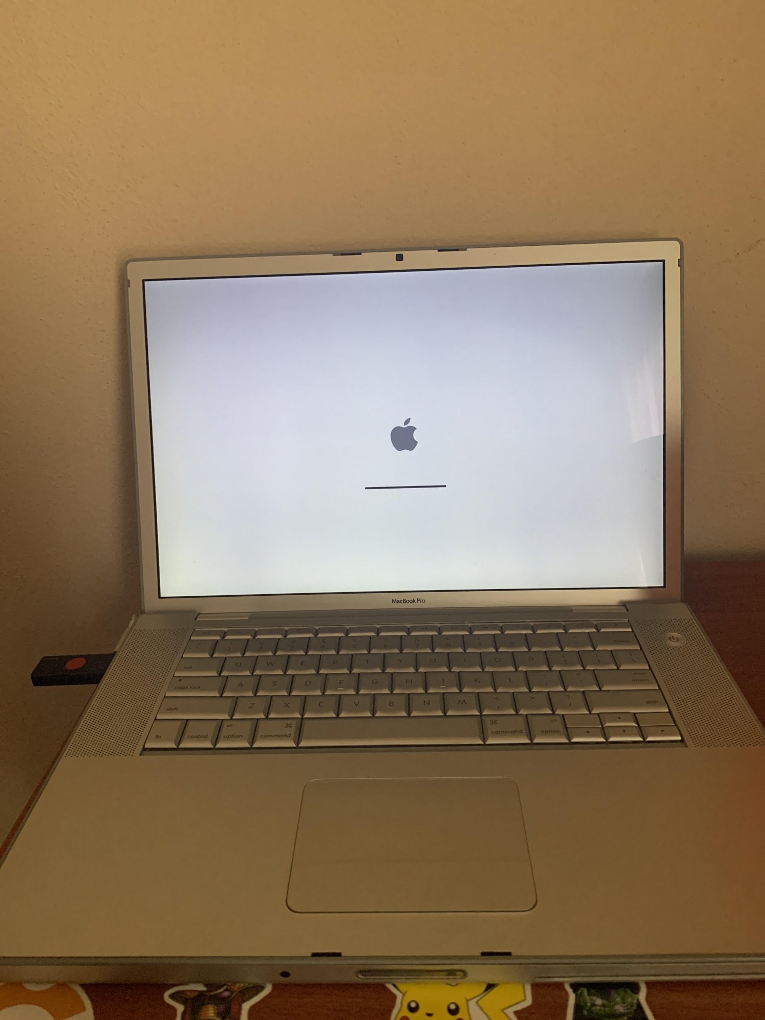

I'm kind of desperate. I have a pre unibody early 2008 Macbook Pro installed with MacOS Mojave (thanks to dudeos patch). The problem is that some day, the Mac refused to start... it kept stuck at the loading bar with the apple logo.
I tried resetting the SMC, NVRAM, removing the battery and nothing worked.
After trying all of this alternatives, I tried to reinstall MacOS (also with dudeOS patch, Catalina this time) and the installer kept stuck also when loading the first screen....
Since then, i've tried to install El Capitan (oficially supported), Mojave, Catalina (both with the patch), Snow leopard and Lion. None of them worked except for Leopard (10.5.8), that one is the only OS that my Mac actually boots to the installer and let me install the OS...
Also, I have installed Windows 7 in a second partition without problems, everything is working as it should. The problem is installing any version of MacOS up to Leopard....
My Mac specs:
Intel Core 2 Duo T9500 2.6ghz
4gb DDR2 667 (I've tried with only 1 slot, replacing both and nothing works)
256Gb SSD (also tried removing the HD and tried to boot to the installer and it keeps stuck at loading bar with apple logo)
Nvidia Geforce 8600gt 512 mb (I know that this card eventually will fail, but I can use it normally with Leopard and W7, so I don't thing that this could be the problem...)
Now I'm without ideas... I think that I alredy tried everything. I can't use apple hardware diagnostic because Leopard does not have it... and I cant boot any other installer.
Any help will be apreciate.
