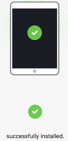

Confirmed: iMazing works with iPad OS as well
I'm installing it right now , after downloading iPad Os 13.1.2 , quit iTunes and launched iMazing and tried to install. After few seconds it launched iTunes that I quit right away, went back to iMazing and it's installing with no issue. You just need to be very fast to quit iTunes when it reopens and iTunes will try to open a second time , close it again an you will get View attachment 865851
I hope it works for you as well!
BTW from iMazing 💡 Tip: iTunes might try to get back into the game during the update. If it does, just close it.
