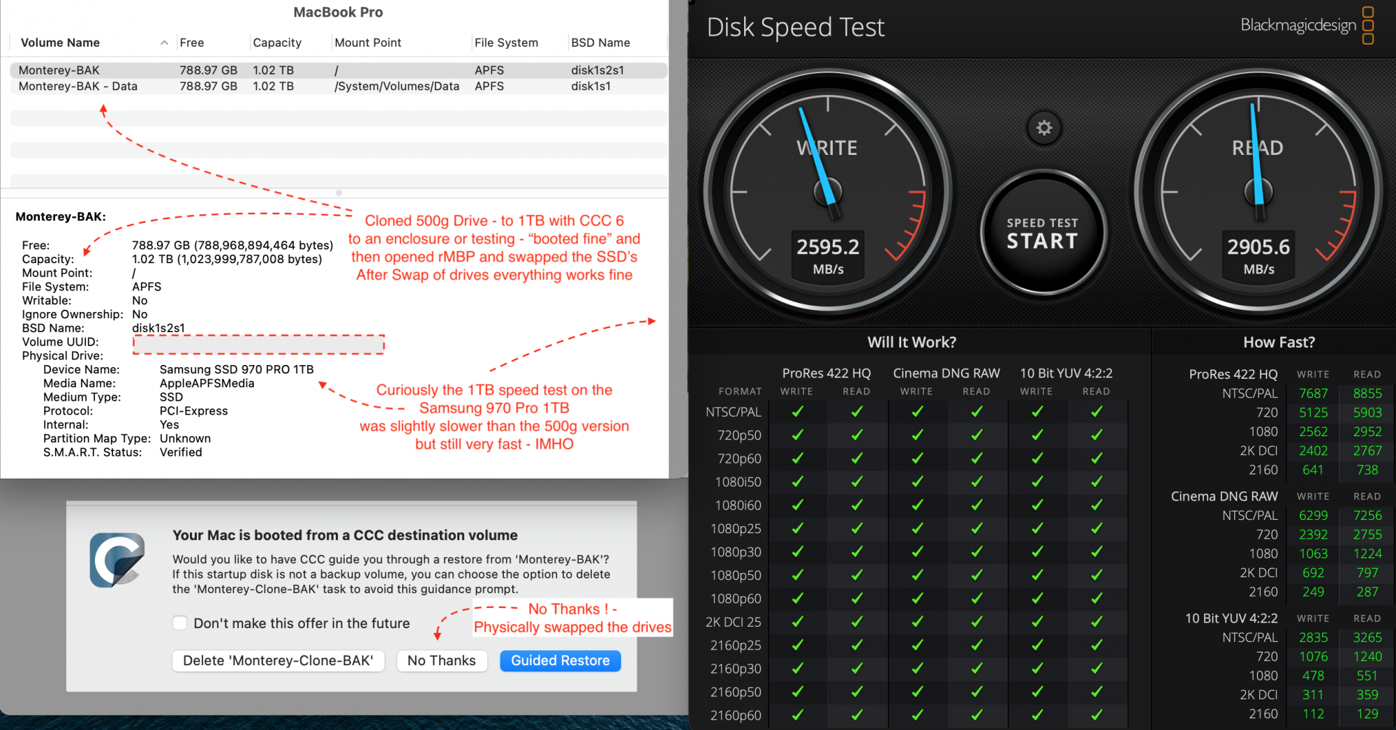

FWIW - rMBP 2015 Model replace SSD - in case anyone is interested or looking to do the same - just used CCC 6 "clone" to replace a 500g blade with a 1TB blade (Samsung 970 Pro)
Worked like a charm and clone is working perfectly after installed - rMBP 2015 15" i7 - took about 30 min including the incremental CCC back up / update just before the SSD swap
FWIW - in case anyone is interested or looking to do the same - just used CCC 6 "clone" to replace a 500g blade with a 1TB blade (Samsung 970 Pro)

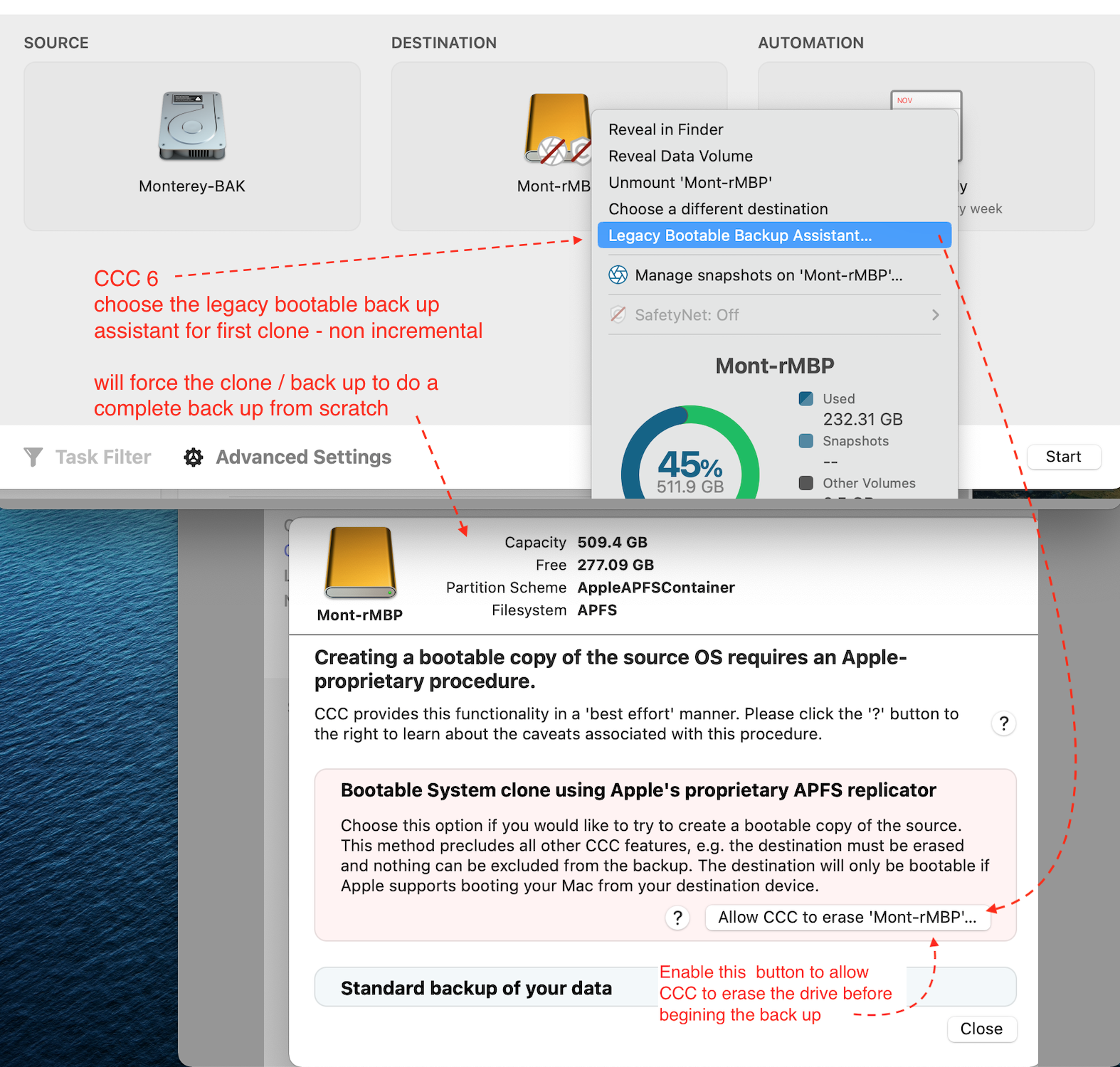

You cannot replace the SSD on the MBP 2017 (my post above was for a 2015 rMBP - sorry for any confusion) - the ability to change the SSD pretty much ended with the 2015 models
But you can certainly easily make a 'Bootable Clone" as long as the external drive (destination drive) is "bootable" - again depends on the macOS ? Mojave? Catalina? Big Sur? Monterey? then choose the correct version of CCC ?
If using CCC 6 for Catalina / Big Sur / Monterey use the "Legacy Bootable Back Up Assistant" for the first clone - see screen shot below
Thanks! Will give it a try.

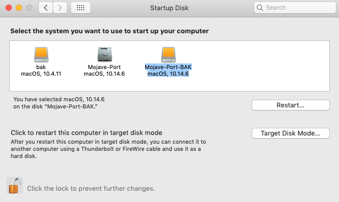

Sorry just found this useful thread after writing a new post. looks like I should have been here. I just downloaded the trial of CCC...planning to upgrade my Mac HD to SSD. The SSD is currently connected by a USB-SATA cable. I cloned the HD to the SSD overnight. I just did a restart with option held down to boot from the SSD but it doesn’t appear in the bootable list. Would you expect it to appear as bootable? I assumed I could use CCC in this way. Welcome any guidance from the knowledgeable. Cheers
FWIW - here are a few thoughts - you may have already gone thru?
1) are you sure the USB cable allows the drive to be bootable? - I use an an enclosure for all my back up drives (about 10 or so) and I don't partition them into smaller volumes - every one of the enclosed SSD's boot fine as external as a test before swapping with the internal
2) Since you mention, and "if I understand correctly" you are upgrading HDD to SSD - is it possibly an older mac and macOS? are you using CCC-5 ? and pre calalina macOS ?
3) I have never had to start with the option button held down - if the drive is select-able in the preferences < Startup Disk you should see it and be able to select it?
Here is a screen shot on my Mojave MBP - very similar on Monterey MBP also
