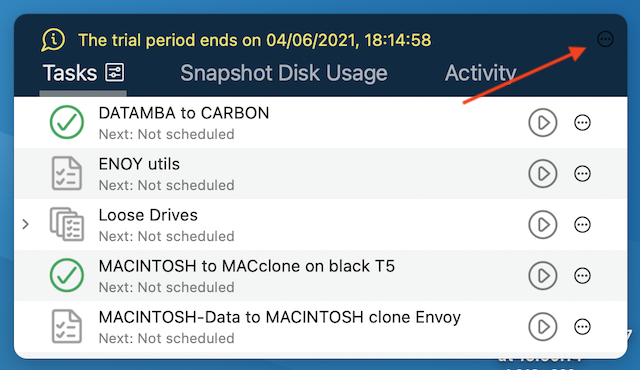

One little GUI bug is that there is a very useful options dropdown button in the Dashboard at top right. It is "hidden" because after a machine boot, it is black on dark blue:
When you click on it it gives many useful options which I had missed, and once clicked it stays white until the next reboot. Mike Bombich says it will be fixed next beta.
Thanks for the post. It is very hard to see as is. I missed it serveral times.
