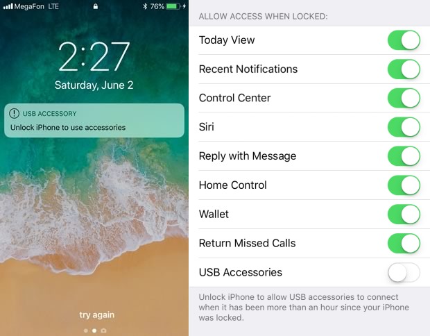

It's due to the USB Restricted Mode feature. If I have unlocked my iPhone within the last hour before getting in my car, it always connects right away. If I haven't, then I have to unlock it first before CarPlay will connect. If you toggle "USB Accessories" to ON, then you don't have to do that. If you leave it OFF (default setting), then you'll need to unlock it first.
Reactions: Roberto Garcia
