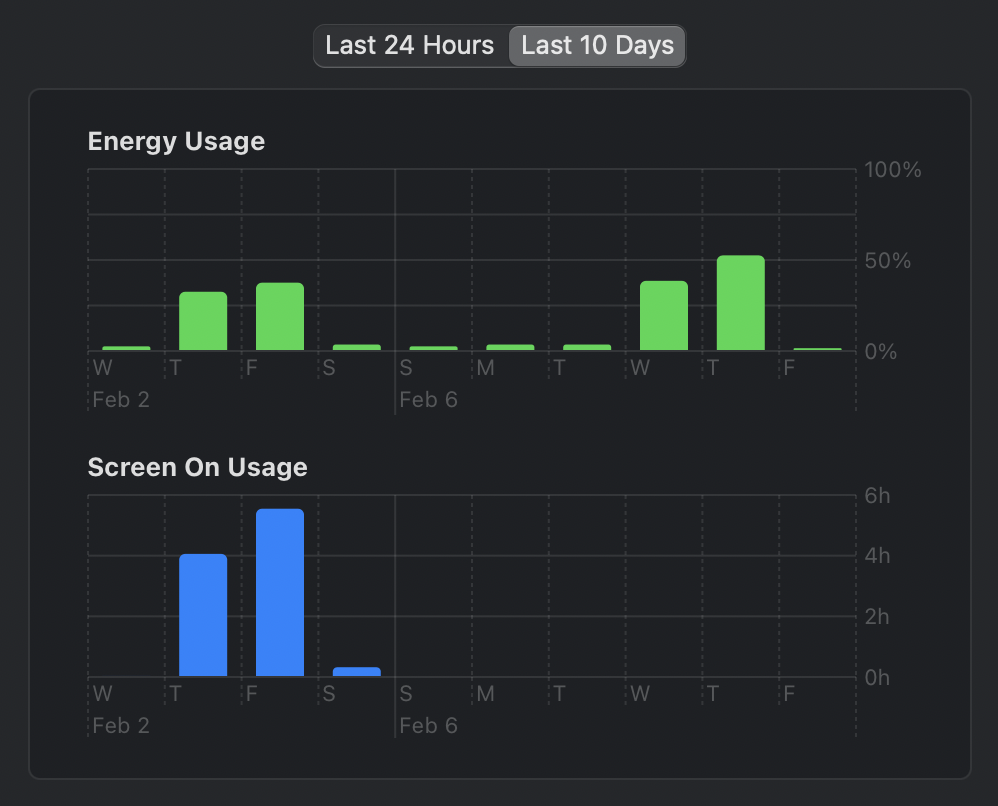

Check your energy usage vs screen usage. Any ideas on what could be causing this? I leave my laptop closed with a near full charge for a few days and come back to it drained.
I read the thread and it sounds like your issue is sorted, but just so everyone knows - this is *not* expected behavior, and clearly OP's battery had to adjust for some reason. I've been using my M1 Max for a few weeks now and since day 1, I've been able to work with a LOT of tabs open and various apps and in an hour, I usually only go from 100% to 94%.
This is coming from the 2019 i9 MBP, which was down to 50% within probably an hour usually.
