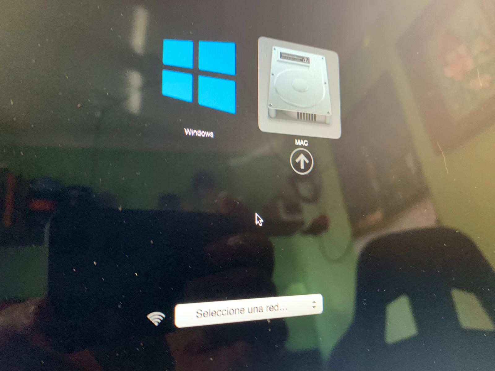

I have a 2013 iMac A1419 with Catalina and Windows 10.
I changed Windows 10 icon changing Windows EFI partition icon, but I can not change Catalina HDD icons. ¿Can you help me? Thanks.

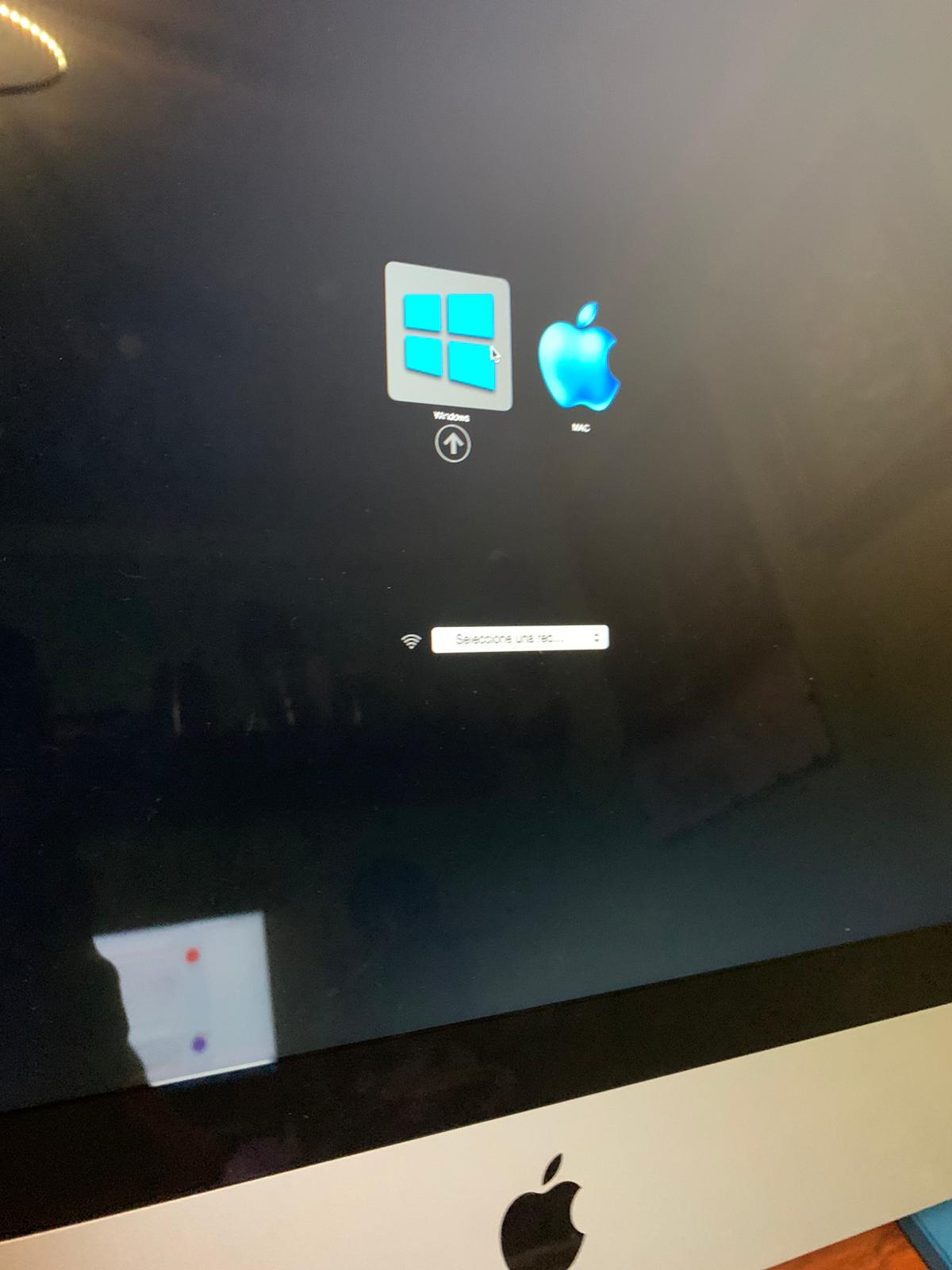

thanks so much for your reply.
i got it!! :)
I didnt need to use grep command, I didnt know how to use it
I used:
Code:
sudo mount -uw
diskutil list
diskutil mount disk1s2
But I cant copy the file .VolumeIcon.icns using Terminal app
I needed to use Finder app to locate where Preboot partition was mount and paste .VolumeIcon.icns there.
