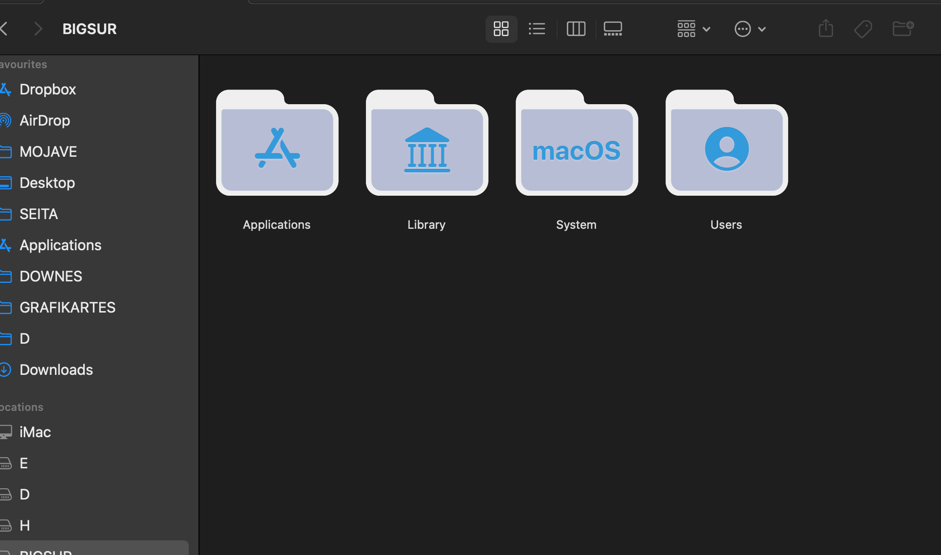

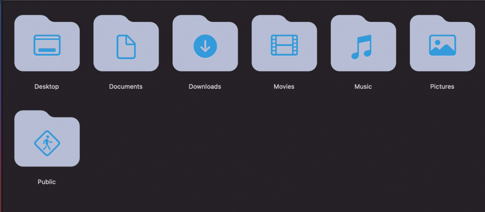

thanks! It worked 👍

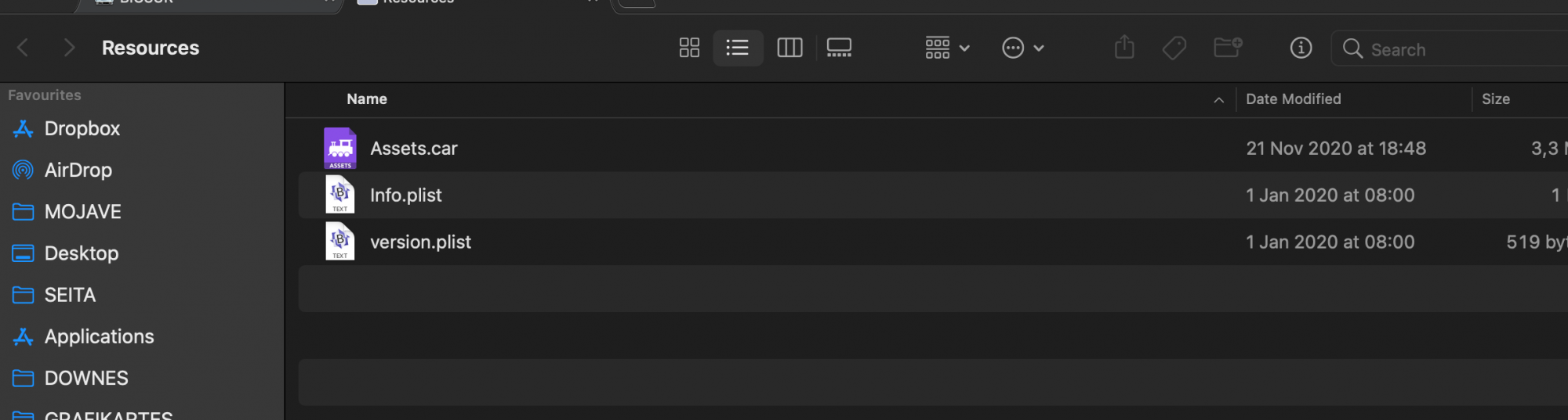

I should be typing something wrong, your summary works perfectly, just one more question, is there any way to do copy paste the texts in Recovery? to not have to write everything every time...

Great - I'm so glad that you've had success and are happy with the result. I hope others will use my method too and not stay stuck with what Apple dictates. The look of an OS does have a psychological element to how we enjoy the time working on our computers. Also, when someone tells me I 'can't' do something, my nature is to find a 'can' way around the situation.
Sadly, there is no way to hold pre-prepared text in the Recovery terminal. The recovery OS is only held in temporary memory, so you can't launch a text file to copy from. You can highlight text already showing in the recovery terminal and copy and paste that to another place. I use this when I'm deleting snapshots. The UUID strings for volumes or snapshots are quite difficult to read and retype, so it's easier to copy them over. The cache clearing text, kmutil, and kcditto text does get set under your fingers if you type them as often as I've been doing over the past 6 months.
Finally, I think you are correct that 'Data' should be sufficient for specifying the user volume in BS (while in the recovery terminal). I've been seeing this come up more often on the larger Macrumors 'BS on Unsupported Macs' forum recently. Maybe it works because the first step is to mount Big Sur 'volumes'. I'll give it a try the next time I need to update my Assets.car file. I've renamed my BigSur system volume as 11.0 and Data as 11.0d - did it from Mojave, as I think you can't alter the Data volume's name from BS - so I find that just as easy to type.
By the way, every time you update Big Sur eg. to 11.1, 11.2 etc, your modified Assets.car file will usually be overwritten by the stock neon blue containing one and the new 'update' snapshot will return your folders back to that look everywhere. You'll need to repeat the process each time to get your custom looking folder back system-wide. You may not have to do the ThemeEngine replacement of the PNGs again though. You most likely can just move the one you made up for 11.0.1 into the 11.1 place. Just check first by opening the updated 11.1 Assets.car file to see if Apple have kept the same arrangement of 'Folder' and 'FolderDark' in the list. Conversely, it doesn't take that much time to just repeat the replacing of the PNGs into the updated file, save it to the Desktop and, as mentioned, go through the move and clear process again in Recovery mode.

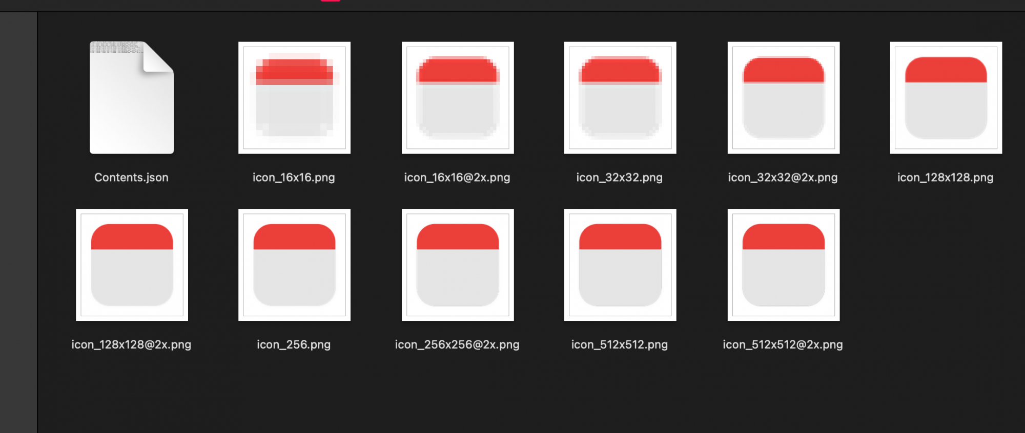

thanks again, I will use this method to change the other system icons, drag icns file to info not work for system apps, or know any faster method without having to be in Recovery?
You should be able to change the icons of system apps using my method too. The app icon is 'AppIcon.icns' inside the Contents/Resources folder (right click 'Show Package Contents'). Modify the icon using a graphics programme or Preview (if just the colour being altered). As with the 'master' PNG or TIFF for the Assets.car work, the graphic needs a transparent alpha channel around the icon. Also, there are often 4-9 sizes of the icon embedded inside the .icns file, so you need to alter each one. Some graphics programmes will apply your replacement icon or changes to all of the sizes, while others you'll need to change each size icon one at a time. You should be able to drag and drop replacements in some editors, while others may require (delete, then) copy and paste steps. Check the editor's info window and make sure the icons have the same overall perimeter size. The middle-sitting icon graphic(s) could be bigger or smaller than the Apple original though.
Once you have created the replacement AppIcon.icns file, again place it on the desktop (or wherever) and do the 'mv', then icon cache clear, kmutil, kcditto and bless new snapshot in recovery, otherwise you won't see the icon change. You can't do this while running BS normally because the system folder is not mounted as read-write. It's all about Apple's direction in preventing hackers or malware from getting access to the system files (not sure about the ones on the user's Data volume?!). We are removing one layer of defense by installing BS without encryption/sealing, of course - but that's a small price to pay for being able to tinker with the interface.

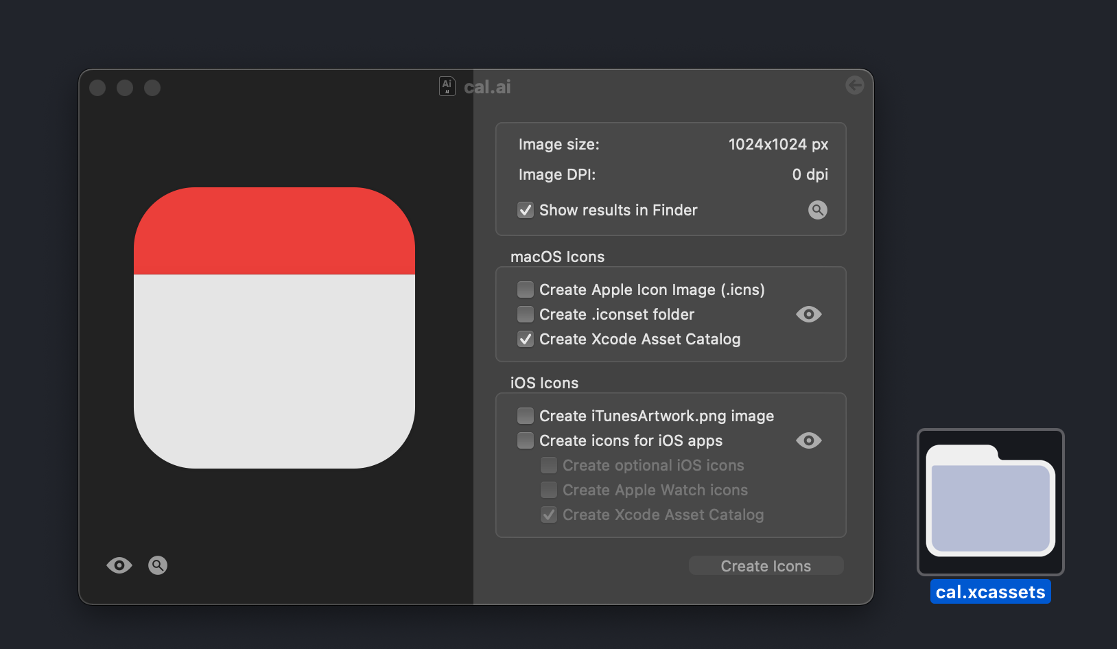

to be quicker to have assets you can use the Icon Glue app, just drag the image file and it automatically creates the assets catalog, then just change with ThemeEngine, many system icons are now also in this format.

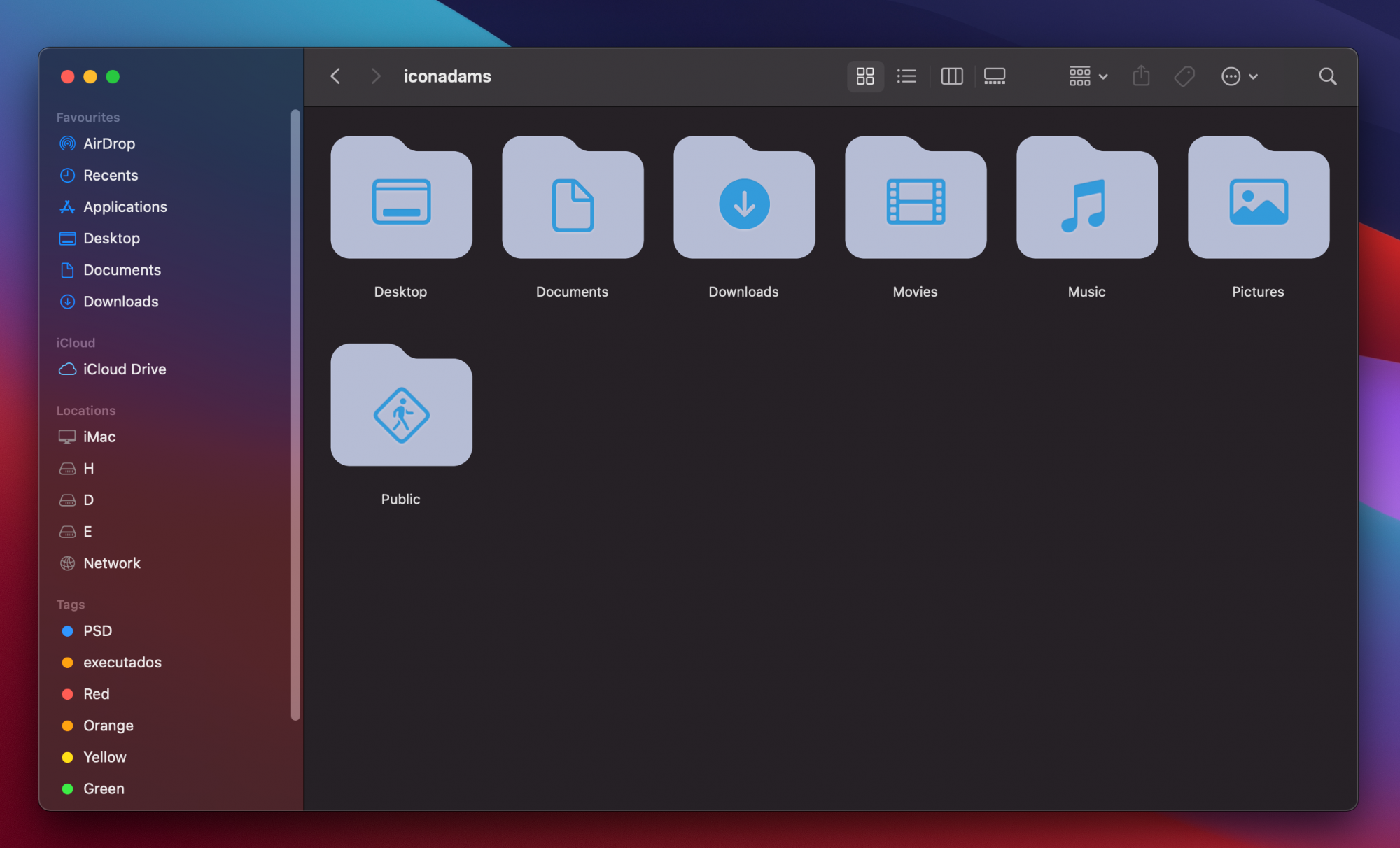

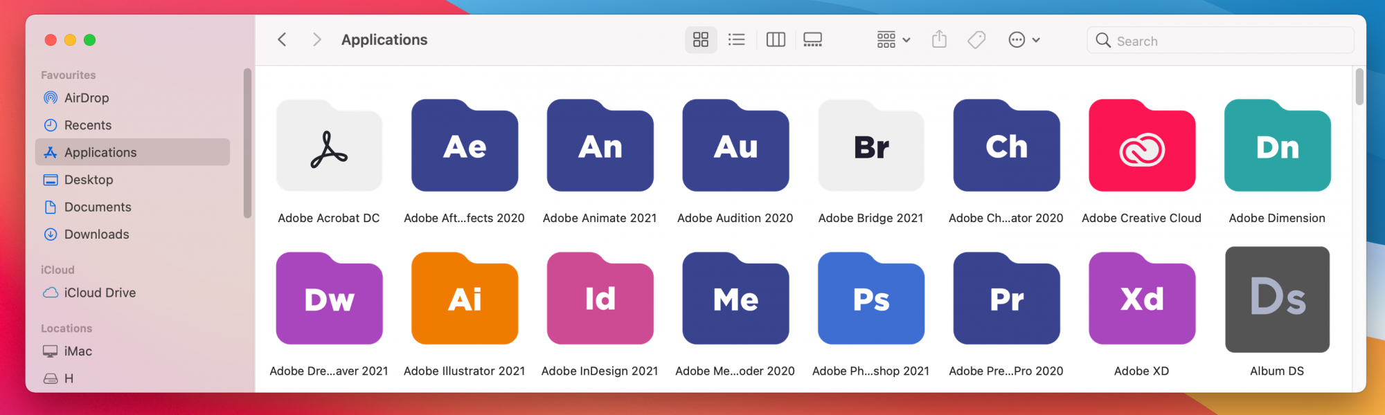

@borp99 Thanks a lot for your instructions. Does anyone know if there's a tutorial for changing system icons anywhere? I searched but have not found anything so far.

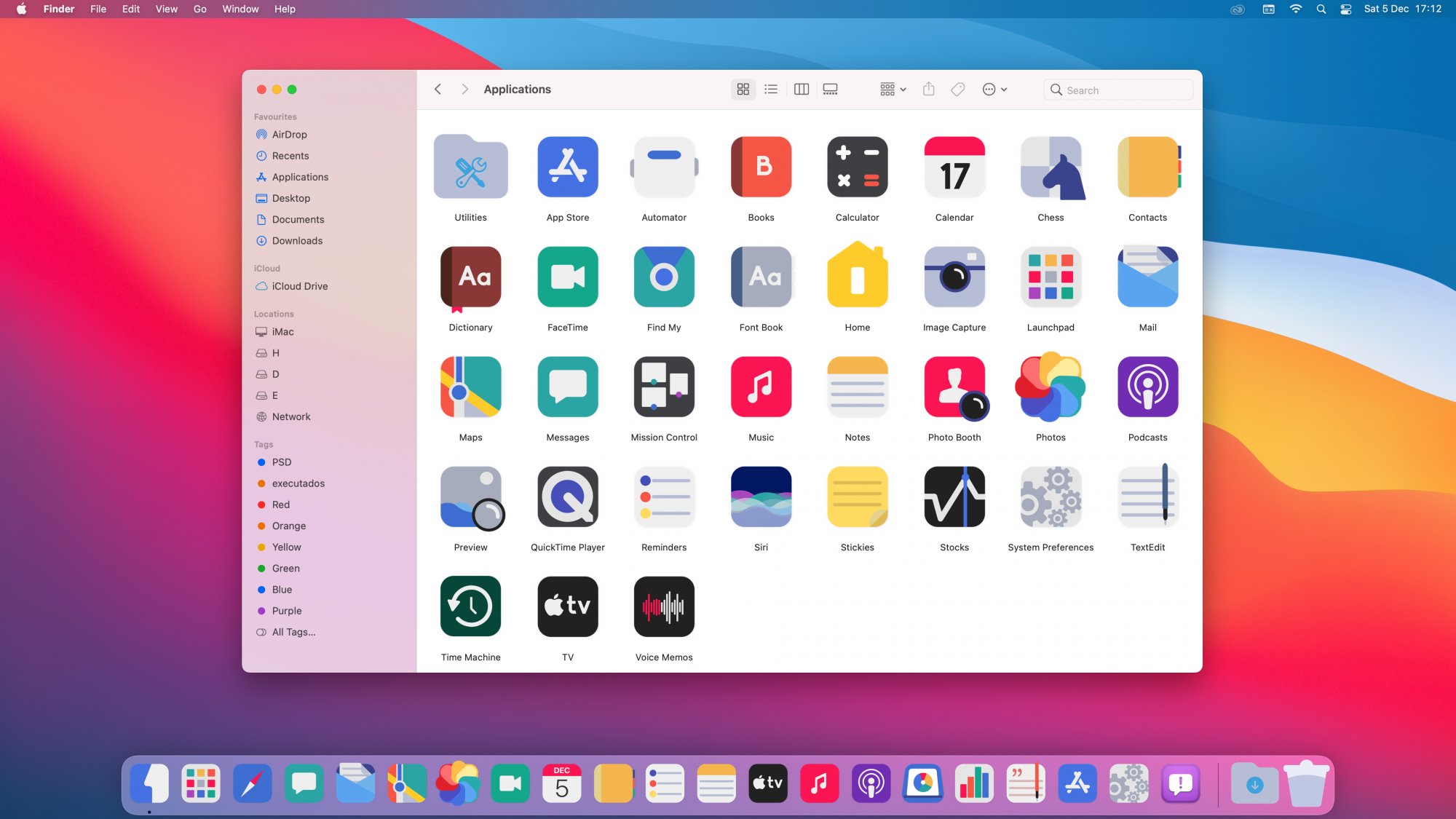

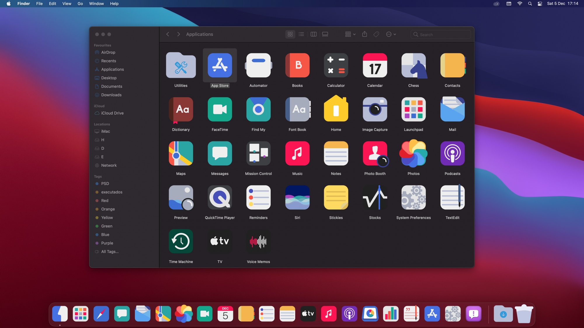

Is there a way when manually copy pasting icon images to turn off the password typing requirement? I'd like to change the icons but having to type the password after every change is a bit too much typing for me.

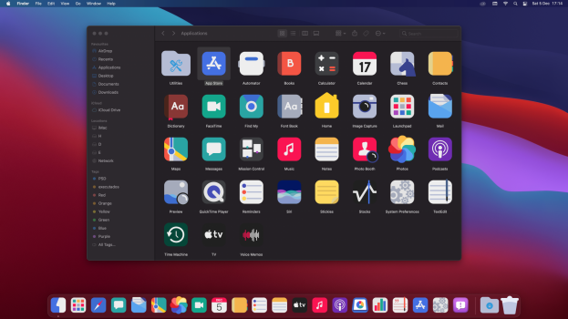

@borp99 So, now that I've read your comments above I will give you a free pass to poke me with a stick repeatedly if I haven't gotten this all correct.
