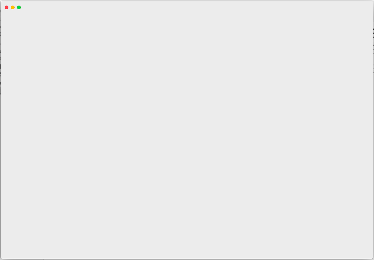

I have a problem with Chrome, and tried regular Chrome, Crhome Beta, and Chrome Canary, and all show the same behavior.
When I open them, I get the below screen, and then Chrome closes immediately after opening, without a bug report.
I can't even open any menus within Chrome on the navigation bar.

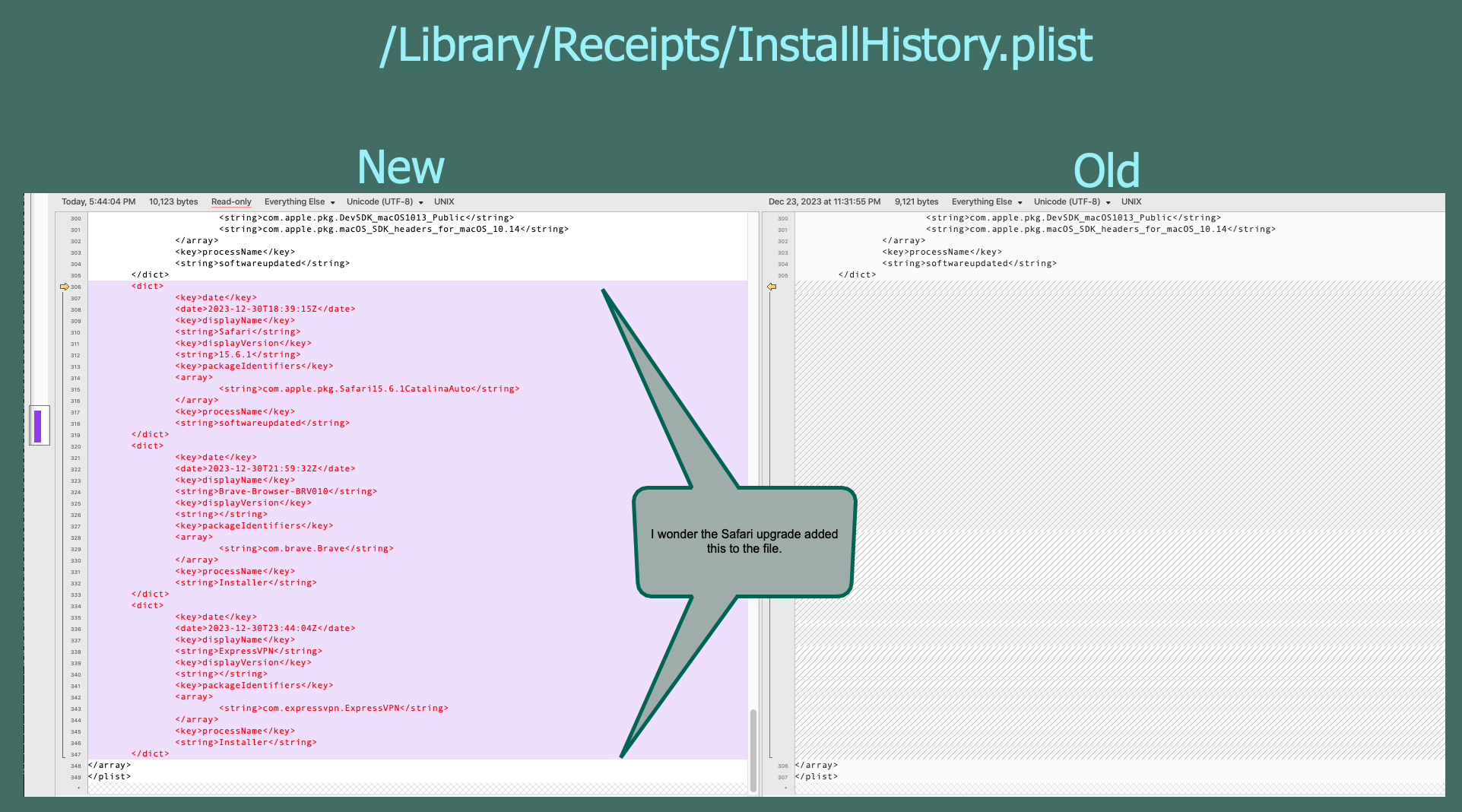

I am thinking I broke my installation when I removed Express VPN (I think Express VPN might do nothing to keep the government out of my web activity). What is bad is I got excited removing it, deleting files from the system library (/Library) I thought were put there by ExpressVPN. To prove what an idiot I am I made a backup of the the library....
.... the minute I discovered I was having a problem. <-idiot.
Another thing I did today was install an update of Safari. I have a complete snapshot of my system from a week ago, comparing it what I have now. This screen shot shows were differences are to System Library

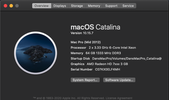

Starting with my cheese grater macpro, built in 2012, I put Catalina on it using dosdude's patch. I have no problems since October till today.. I am not sure how/why the fail of Brave Browser (which is built on the same Chromium foundation as Google Chrome) started. But now it fails just a described at the start of this thread. I can get around it using the open with sandbox off command at the command line
